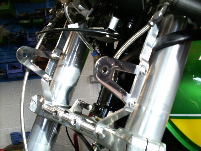

#277 PostAuthor: zed1015 » Sat Aug 22, 2009 8:48 pm

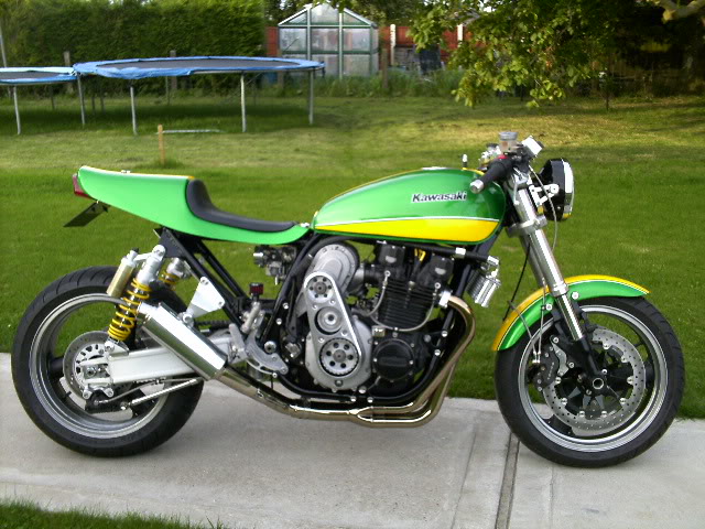

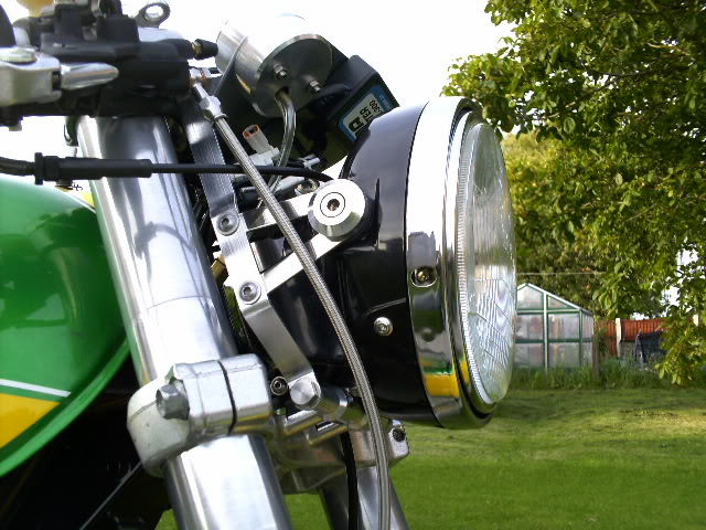

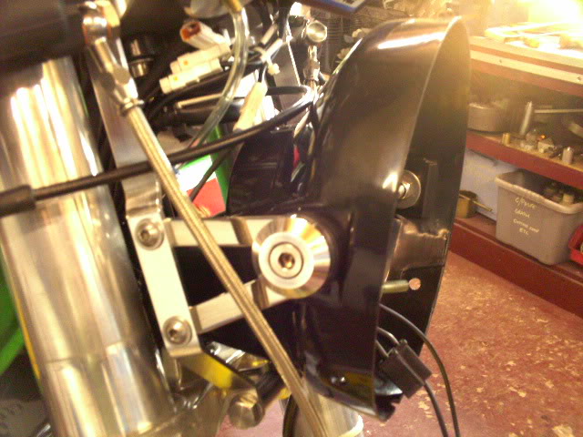

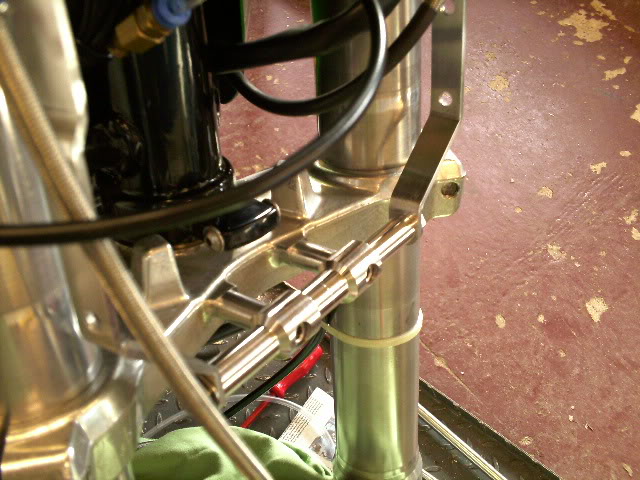

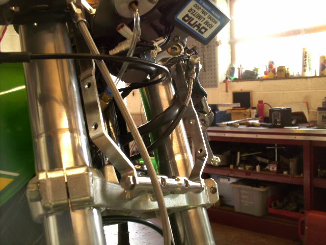

At last. Finally got a half decent headlight mount sorted after about five failed attempts.
Used the redundant brake splitter mount as a starting point for this turned alloy bar
That takes some suitably shaped for strength alloy strips.
Which were drilled to take a pair of modified stainless plates which i had lurking around
Then added some turned alloy cup washers to tidy up the caphead bolt heads.
Then give it a bit of a polish and bolt it all together.
And here it is.
Just a few minor jobs and a good session with the solvol and the build is complete. :hoo
