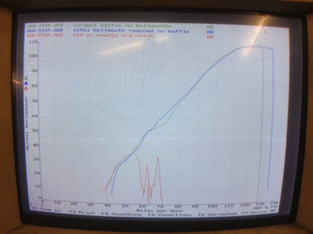

Bike finally made it onto the dyno today and Steve Debben emailed me a pic of the dyno screen. It's a nice straight line so the bike should be easy to ride. It made 105hp peak power at the rear wheel which I am really pleased with, I was hoping for 90-100. Steve is going to try smaller mains (115) and he thinks that the gearing is too tall, max power is at 125mph in 4th. The speed sensor is mounted in the rear disc so changing sprockets won't affect the speedo reading.

Well there's good news and not so good news. The good news is that Steve has now extracted 110bhp, which I think is quite impressive for a mildly tuned 1015cc motor. The line is now even straighter which implies great midrange and good top end power, the ideal combination.
The not so good news is that the bike runs best with no baffles (very loud) but at least the loudest baffle only makes a small dent in the midrange, see chart.
The other not so good news is that it turns out that my expensive and beautifully made Japanese bellmouths are actually crap when it comes to airflow. Steve reckons that the bellmouths are too narrow at the front which mean that the pilot holes sit outside the mouth in still air, not inside the mouth where they benefit form better airflow. So, the bike runs better with open carbs and no bellmouths.
I am not sure how to fix this as I do want to have some form of filters. I am thinking of getting some simple alloy tubes made which fit round the outside of the carb inlets (so the pilot holes are inside the tubes) and to which I can attach the original S&S filters. This should enable me to package the filters behind the bulge in the side panels, keeping the current looks but having a glitch-free midrange and having filters all at the same time. Option 2 is to have tubes made with a flared end that will take the current gauze filters. I won't know for sure until I get the bike back and take some measurements. Oh, and Debbens have finished with the bike and I can now have it back as a fully functional motorbike. I just need to arrange collection (and pay a large but not unreasonable bill). I'll post some pics of the finished bike when it get it back. Can't wait!

1) the baffle could be simply a perforated tube wrapped with wadding. It would take the edge off the sound and not be restrictive.
2)K&N filters have "bell mouths" in them made of rubber. I'd think about fitting them to see if you can get it to carb properly. If so, get some aluminium copies.
You just need a set-up that works and then adapt to them to get the look you want. You might just think hard about modding your bell mouths- perhaps you can have them cut down (to get the right diameter) then have some new cuffs soldered onto them to get the right mount to the carbs.

id get the bike back and ride it and see what you think :?: you might swap the baffles for quieter ones and not even notice the power loss on the road,did you get the bike dynod before and after the work had been done :?:
