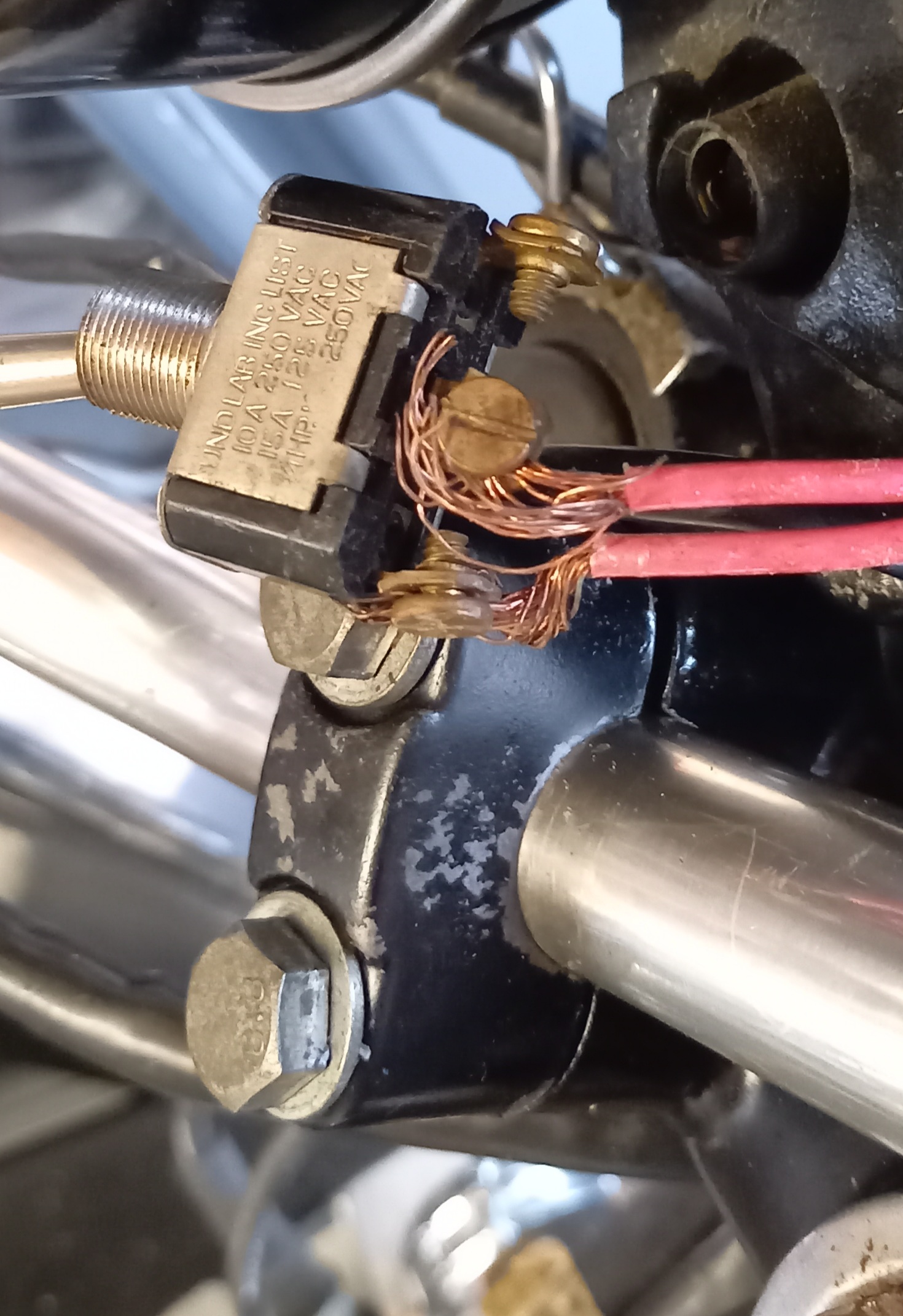

:( How much does an ignition switch cost huh??
dearie dearie me!
New switch on its way from z-power.

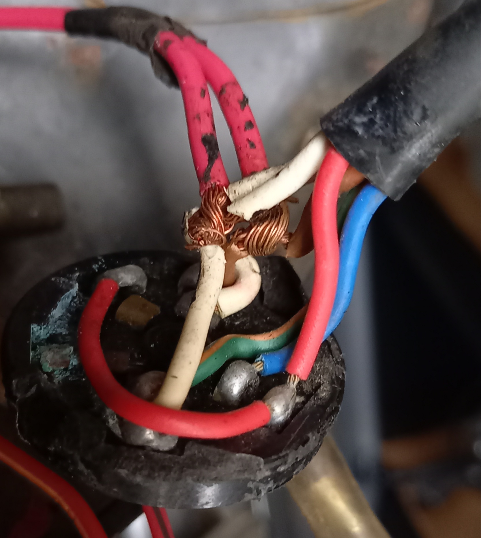

Clearly a qualified electrical engineer had it before you, the mind bogles does it not.

Dodgy ignition , dodgy frame stamping alarm bells :wow :wow

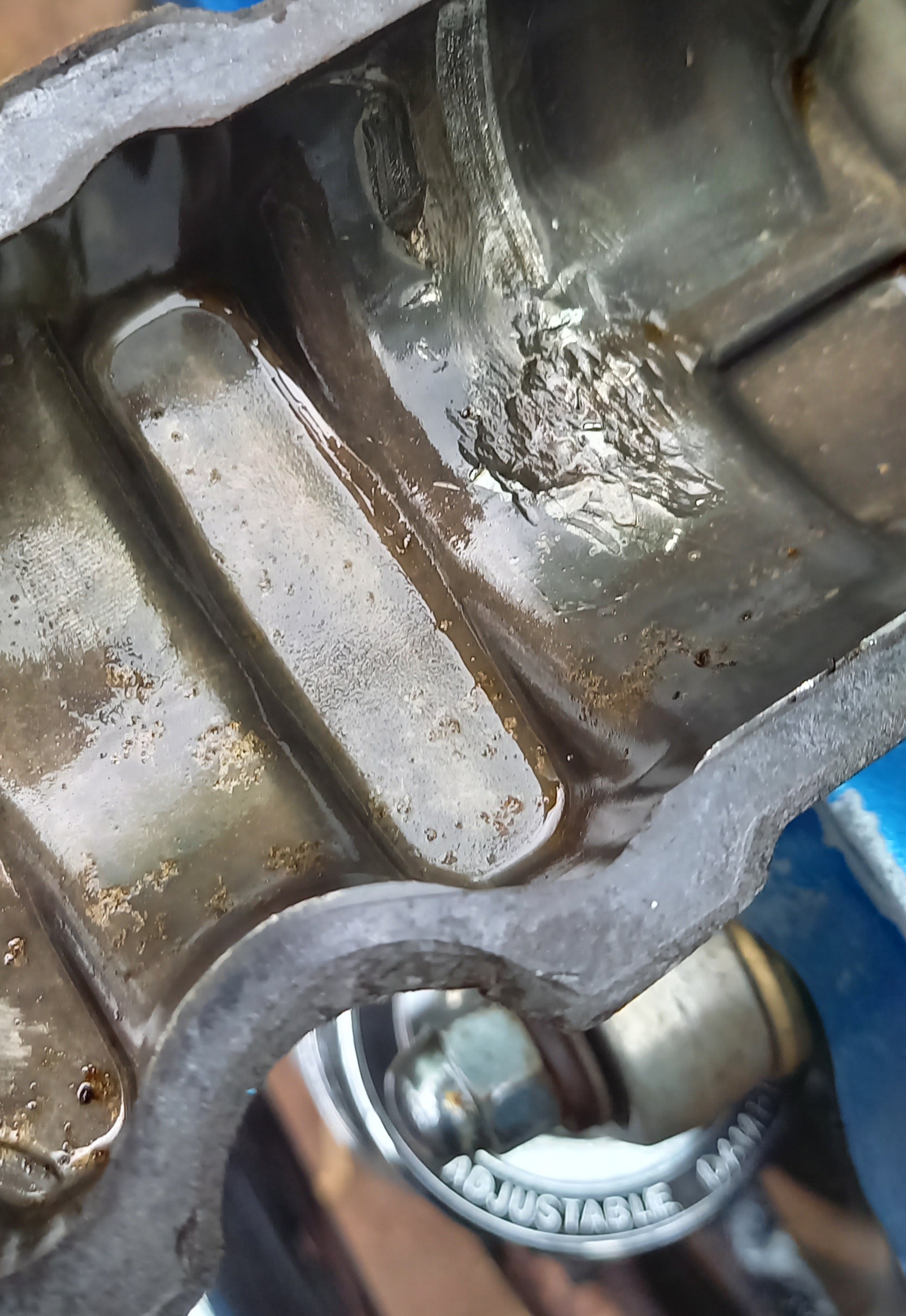

#20 PostAuthor: Peteypops23 » Thu Jun 10, 2021 8:34 pm

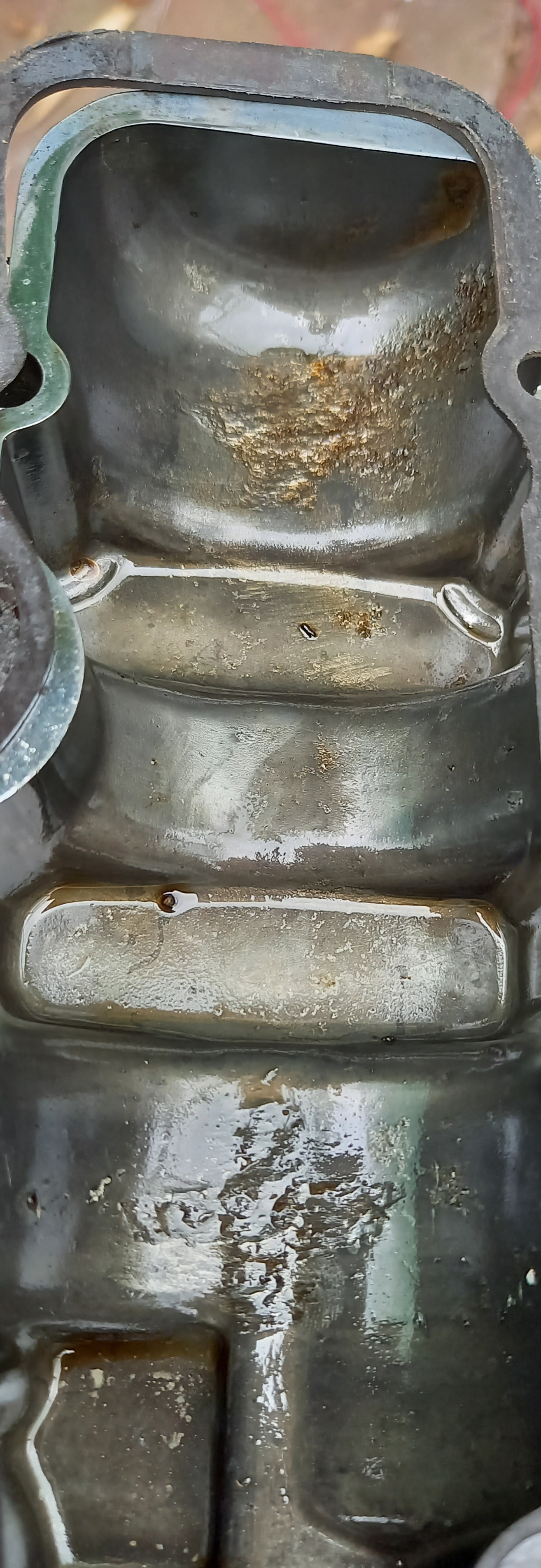

So, while I am waiting for the carb and fuel tap rebuild bits, I thought I would check the valve clearances as it was a bit tappy when running.
Don't think the camchain had been adjusted for a bit so slackened off the adjuster as per.....
Took the cam cover off and cams look fine but.....looks like something has gone a bit Pete Tong at some point in the last 40 odd years.
Best tidy the cover up with the dremel methinks!
Don't you just love 'em?

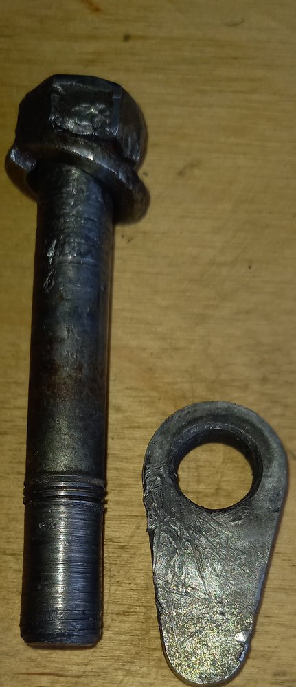

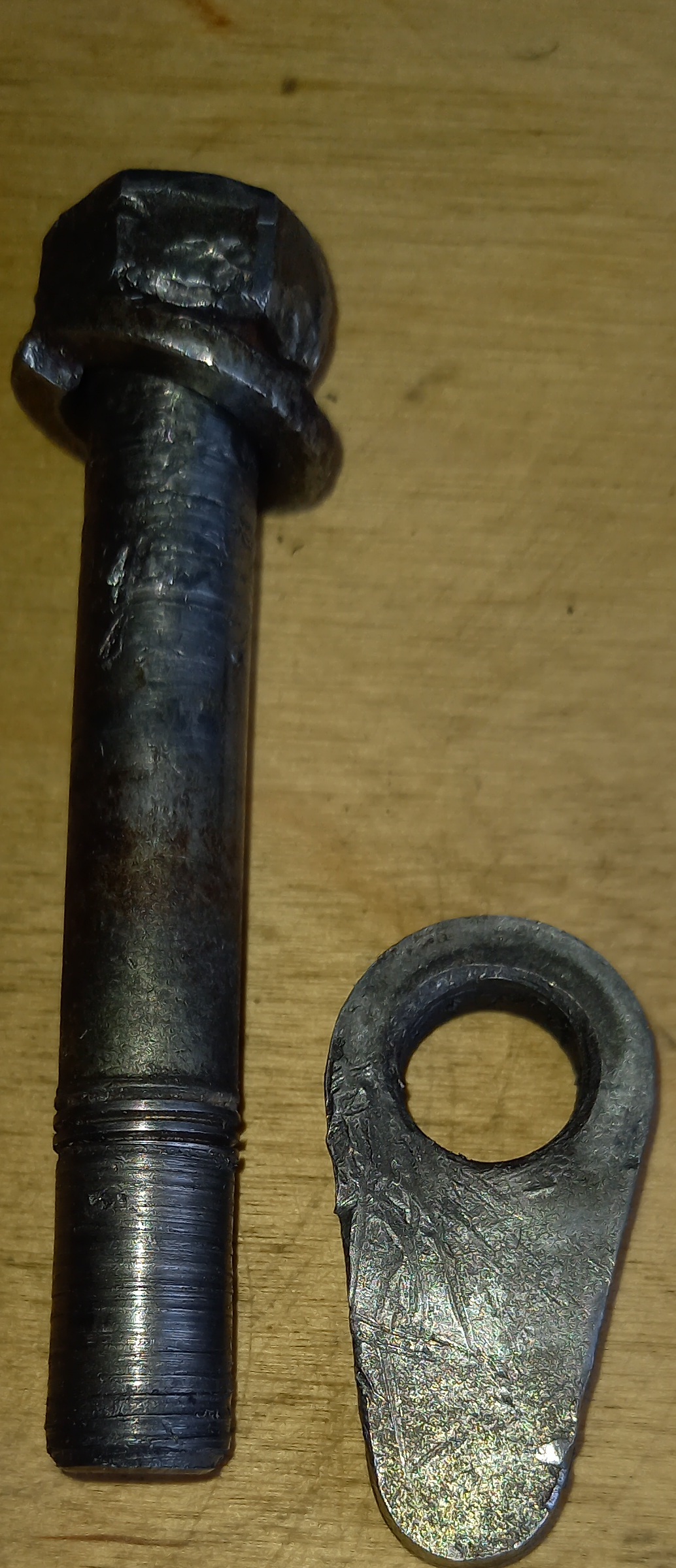

I suppose that every multiple owner old bike must have had, at some point, at least one absolute arse of an owner who, for want of a better expression, couldn't bang a nail in straight!
When the bolt bottoms out, stop turning!!
This is the nearside lower engine mount bolt....which is about an inch too long....they just kept turning...luckily it hasn't gone through the engine casing!
Thankfully I'm going through everything slowly.
Just need to find out why there is a load of silicone on the chain split link?!? Answers on a postcard please...
