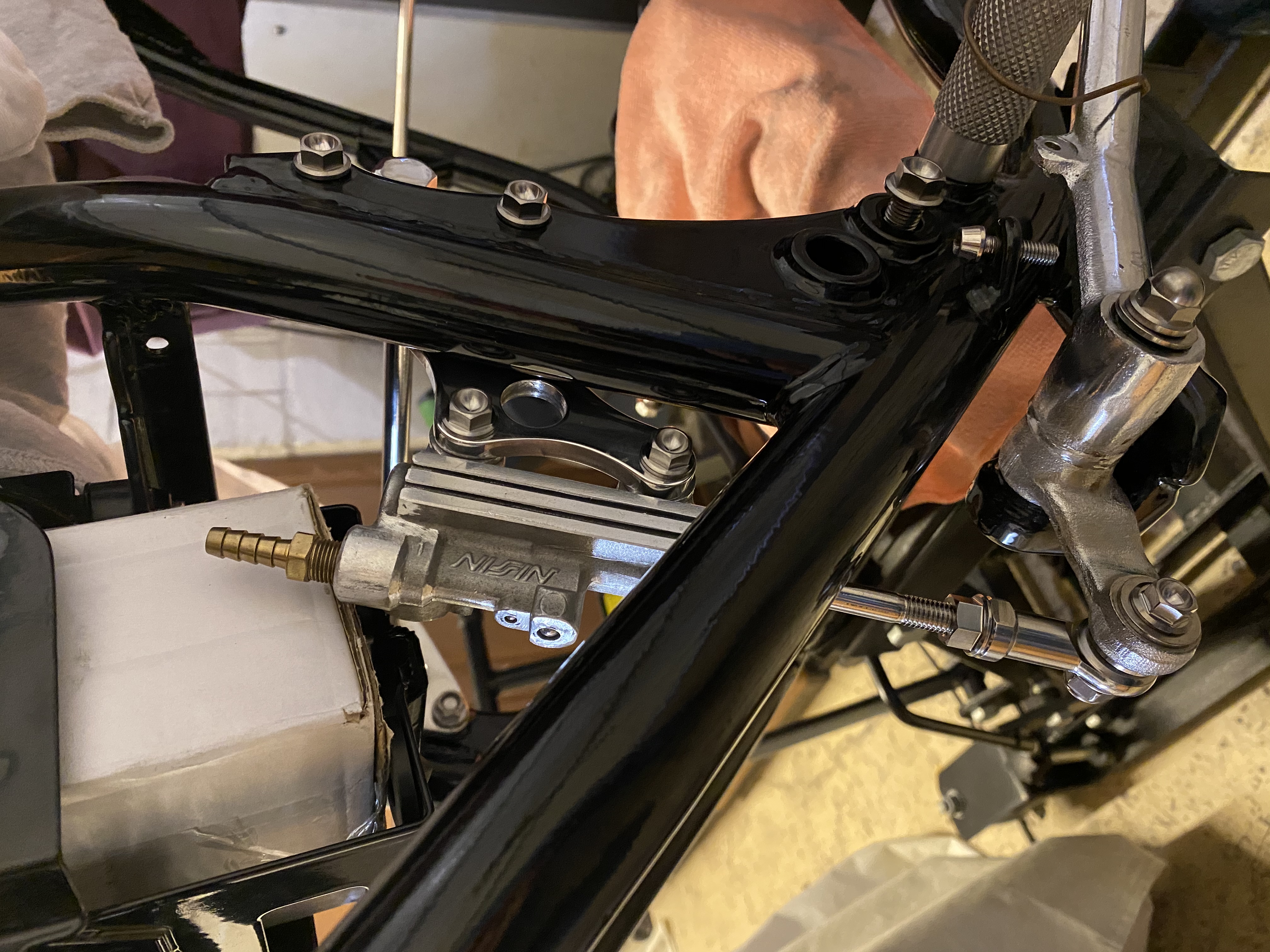

Rear master cylinder from GPZ1000rx worked out nicely

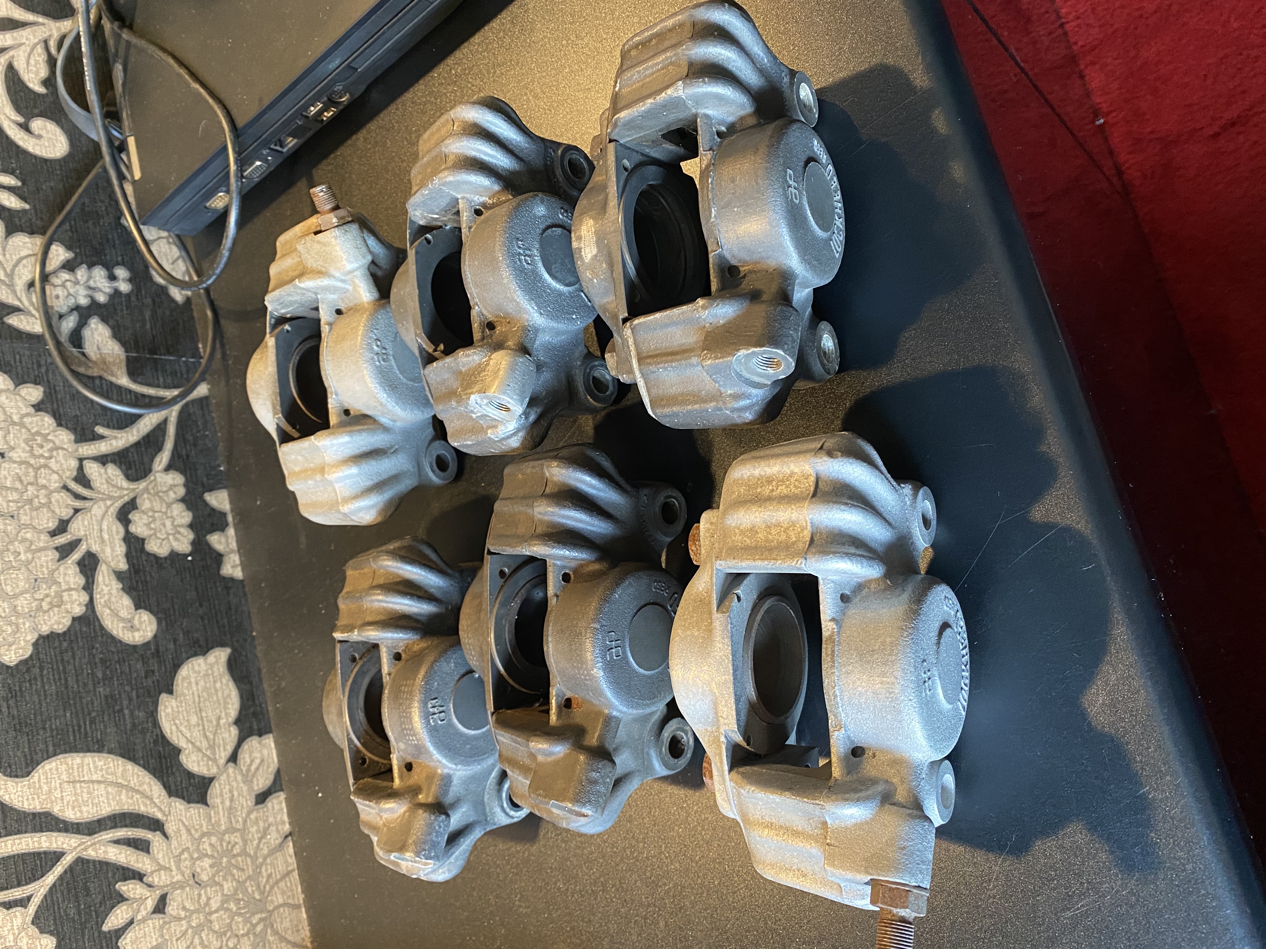

Spent ages looking for a vintage AP Lockheed calliper for use on the rear and then like buses .. wait all day for one and 6 come along at once!!!

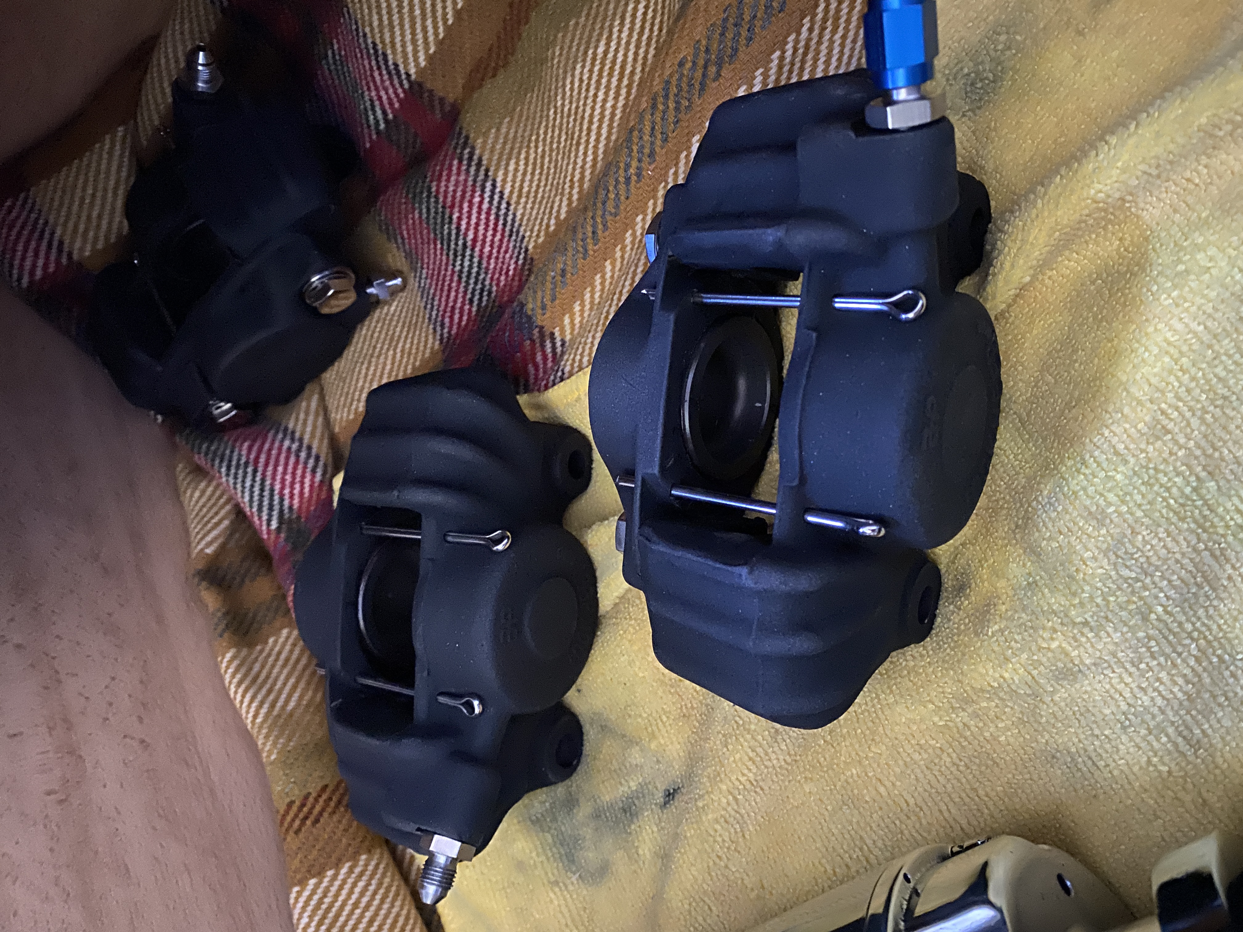

Resulted in a slight change of plan .. Originally was going to run single disc on the front but as I had a RHS AP amongst the bunch will be running a dual disc setup..
All three stripped powder coated and rebuilt ready to go!

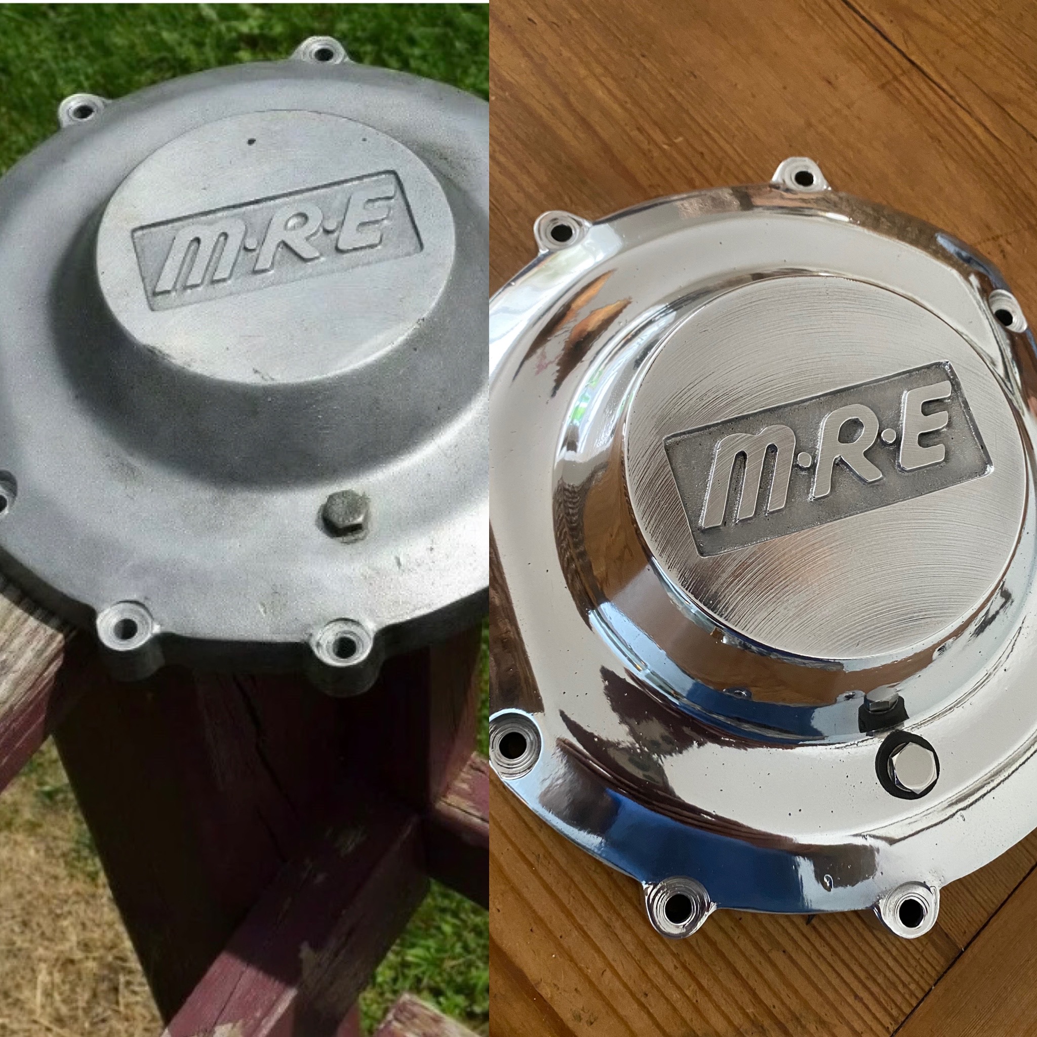

Another small job done .. Vintage MRE lock up cover polished up better that I expected for a rough sand cast piece!

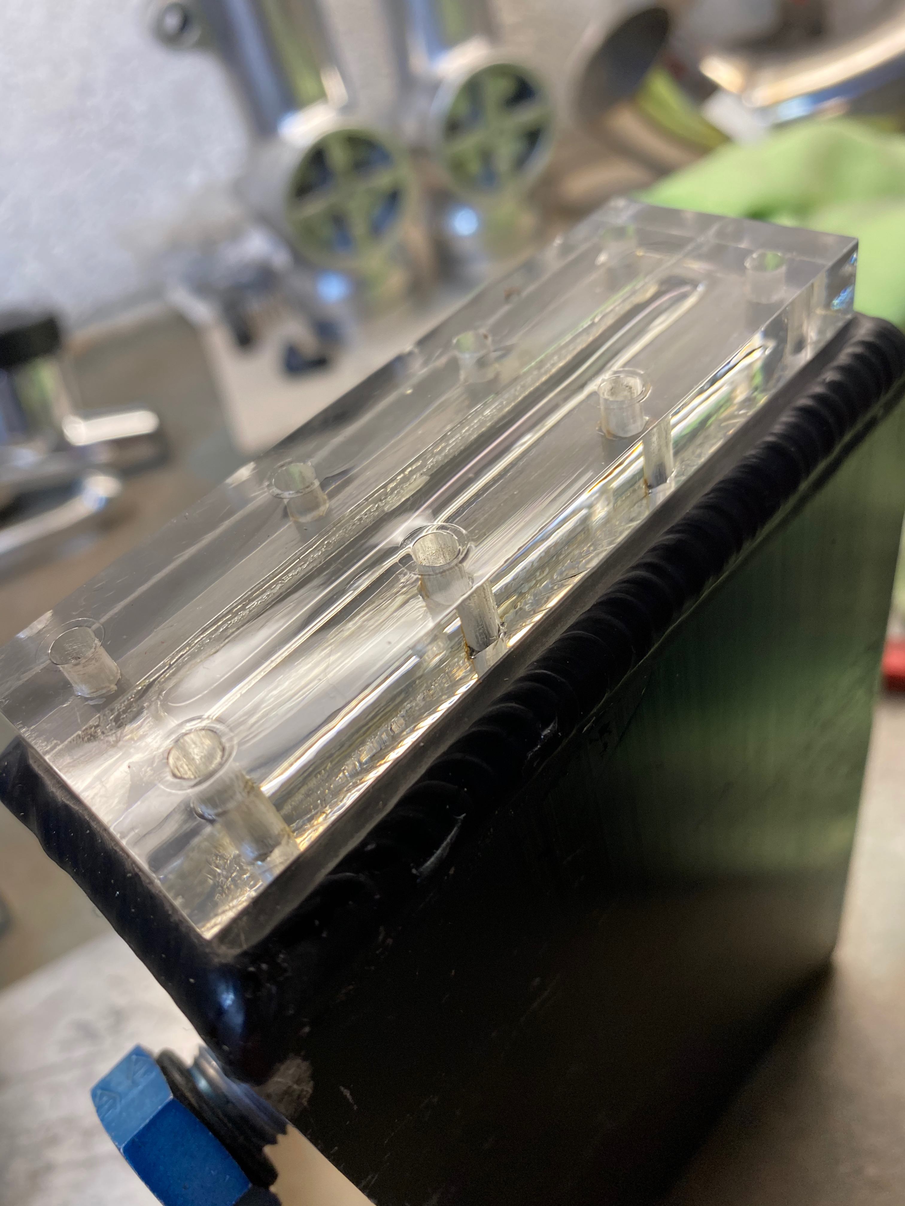

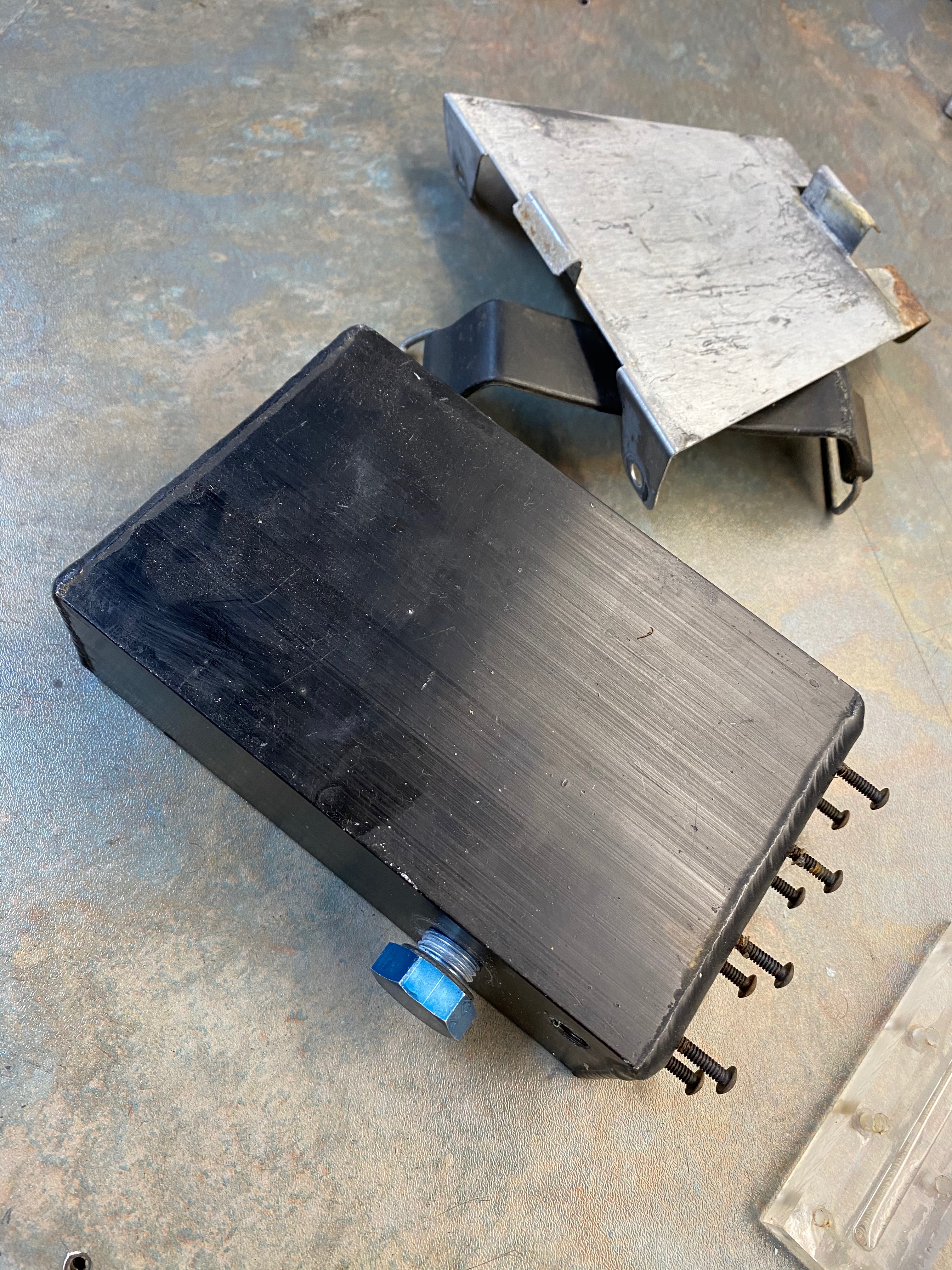

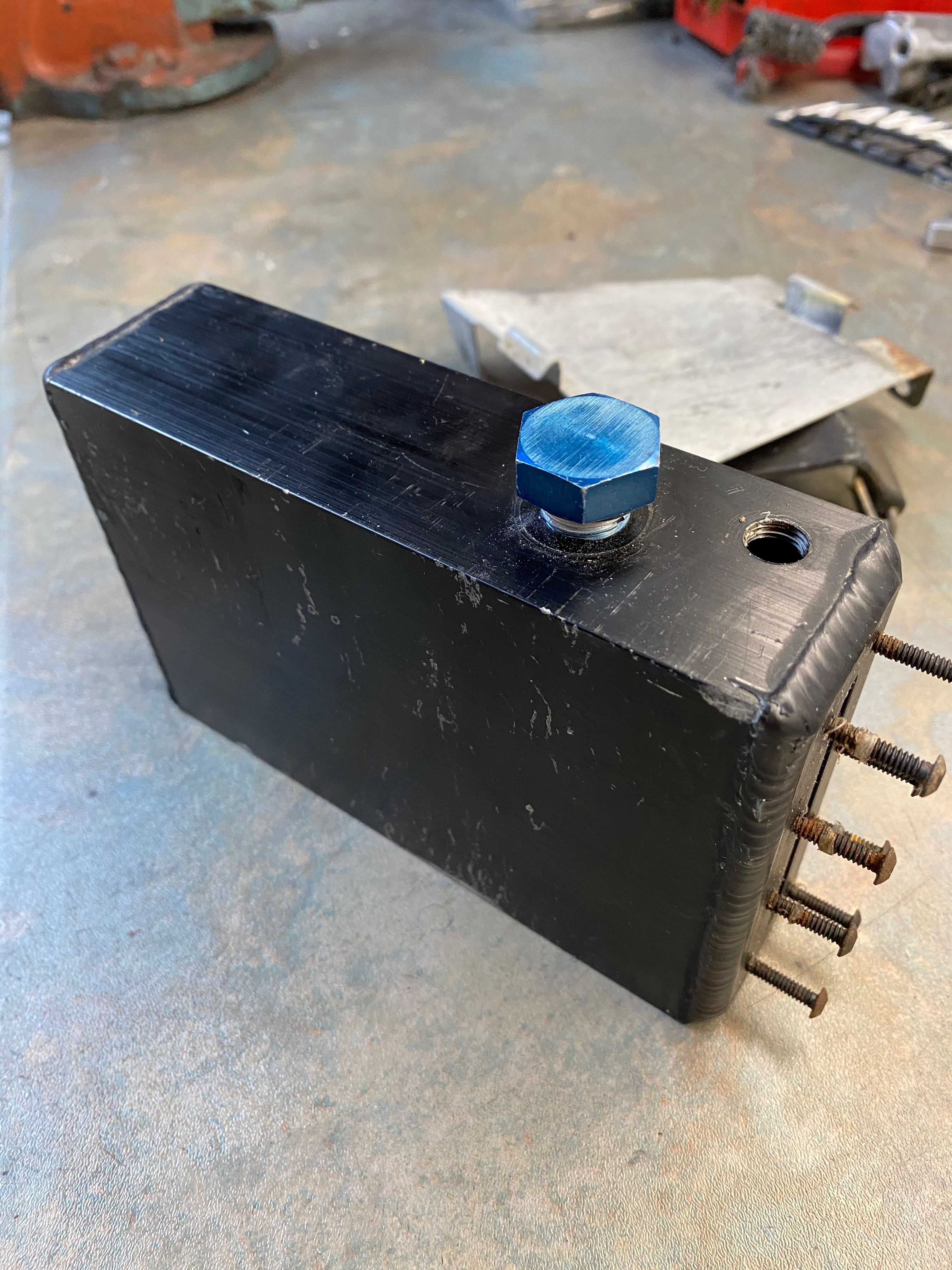

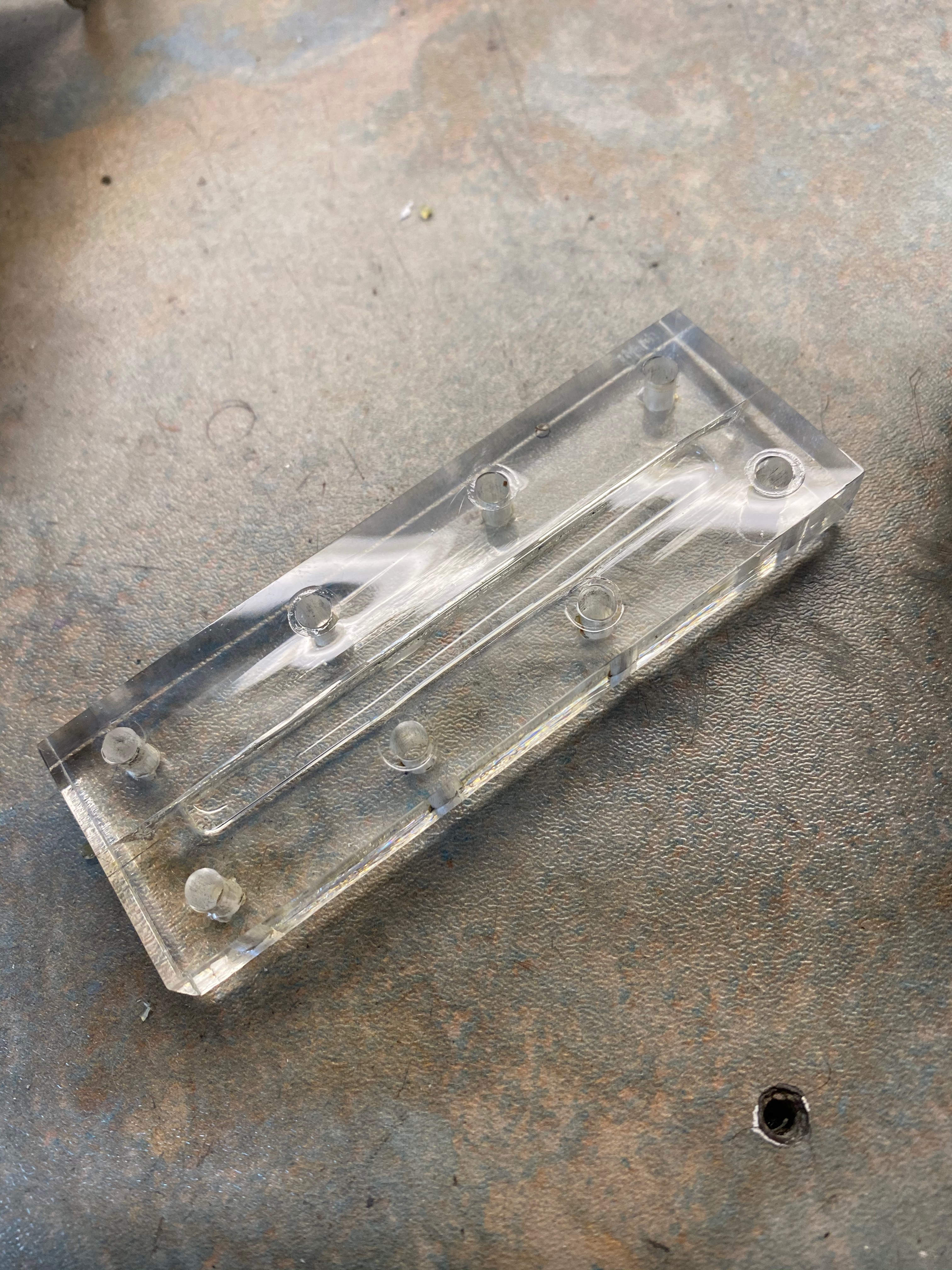

Going to take a look at restoring the old ATP water injection tank. The sight glass is useable but has a hairline crack that runs halfway through and Id like to replace.
Can anyone recommend a plastic engineering/machinist?

just replace with a new piece of perspex ,tank can also be used a oil tank for seperate turbo oiling system

If I have to was going to use plain piece of acrylic but like the idea of matching the original with the raised area.
Was thinking about a separate oiling system but don’t want to over complicate with additional pumps etc.. I’ll just run an additional inline filter to the turbo

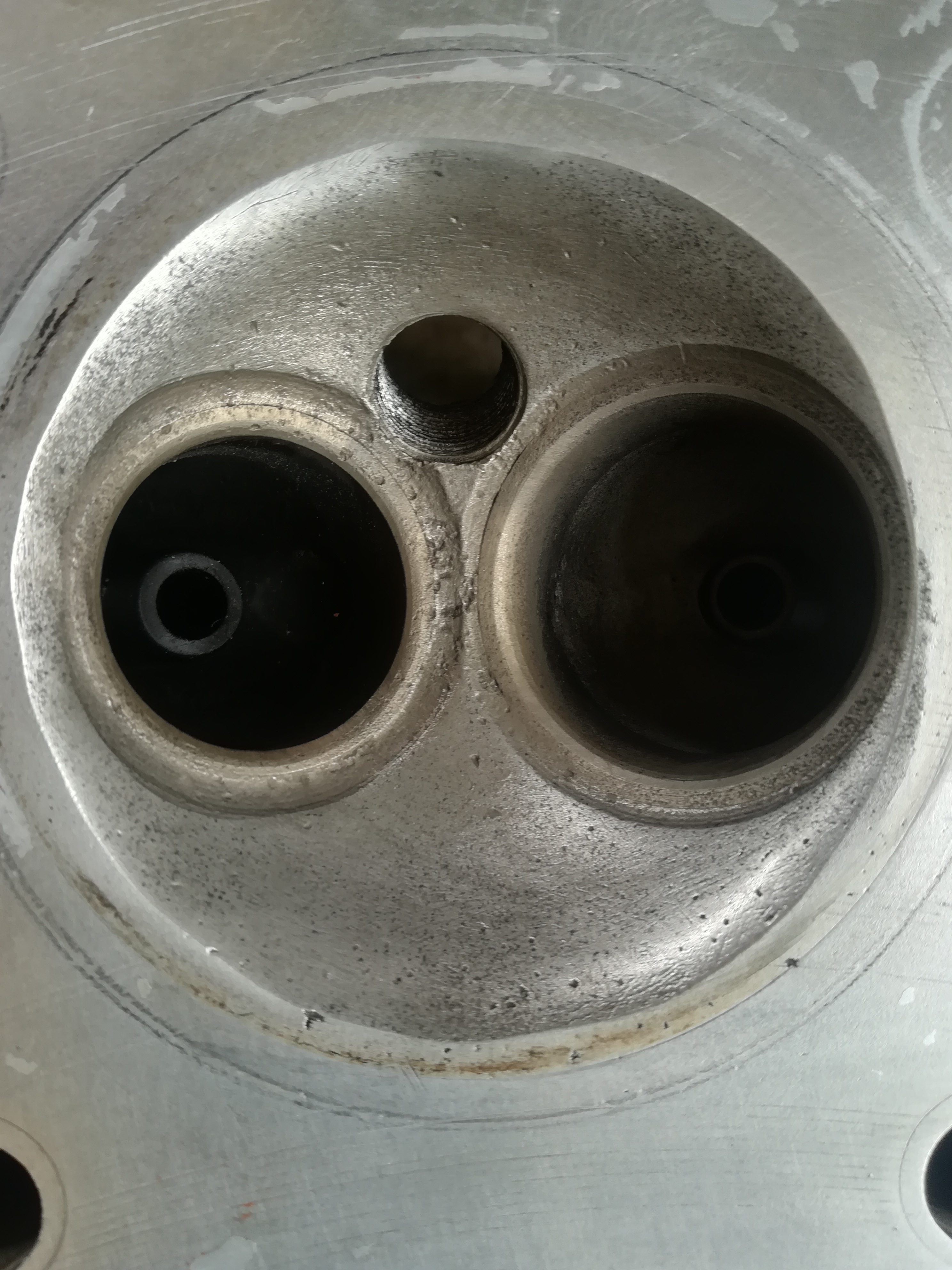

I believe this was the result of running with an incorrectly set up ATP water injection kit on a customers TC :roll:
It's the only thing I could think of that would cause this much corrosion and damage, and that's just the inlets :shock:
I junked the water injection kit and went for boost activated retard instead which helps to run cooler.

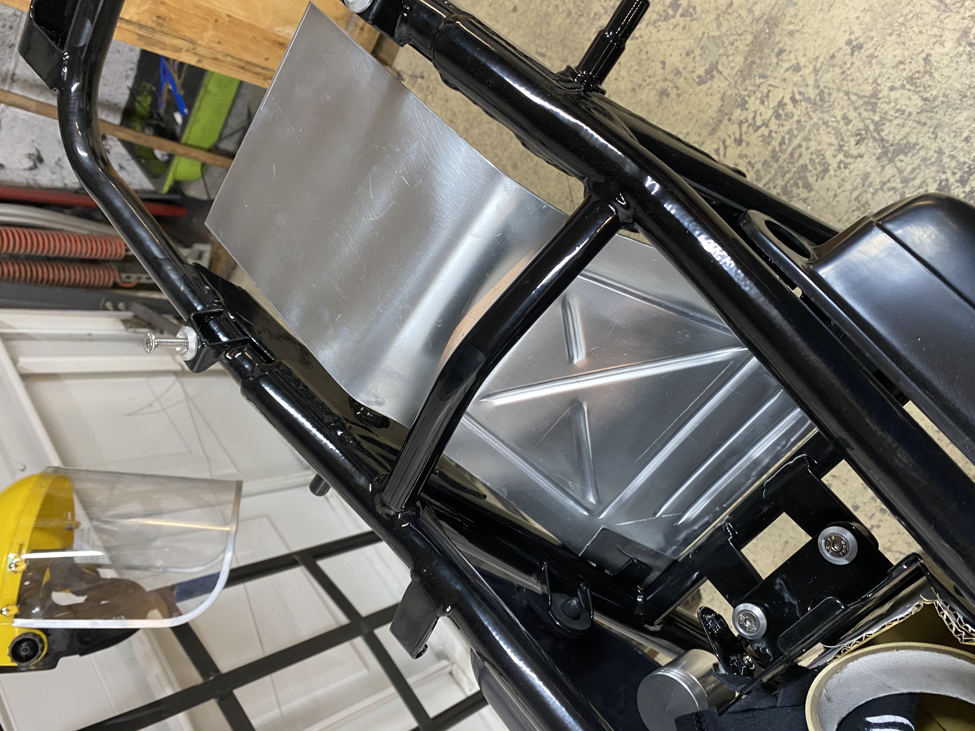

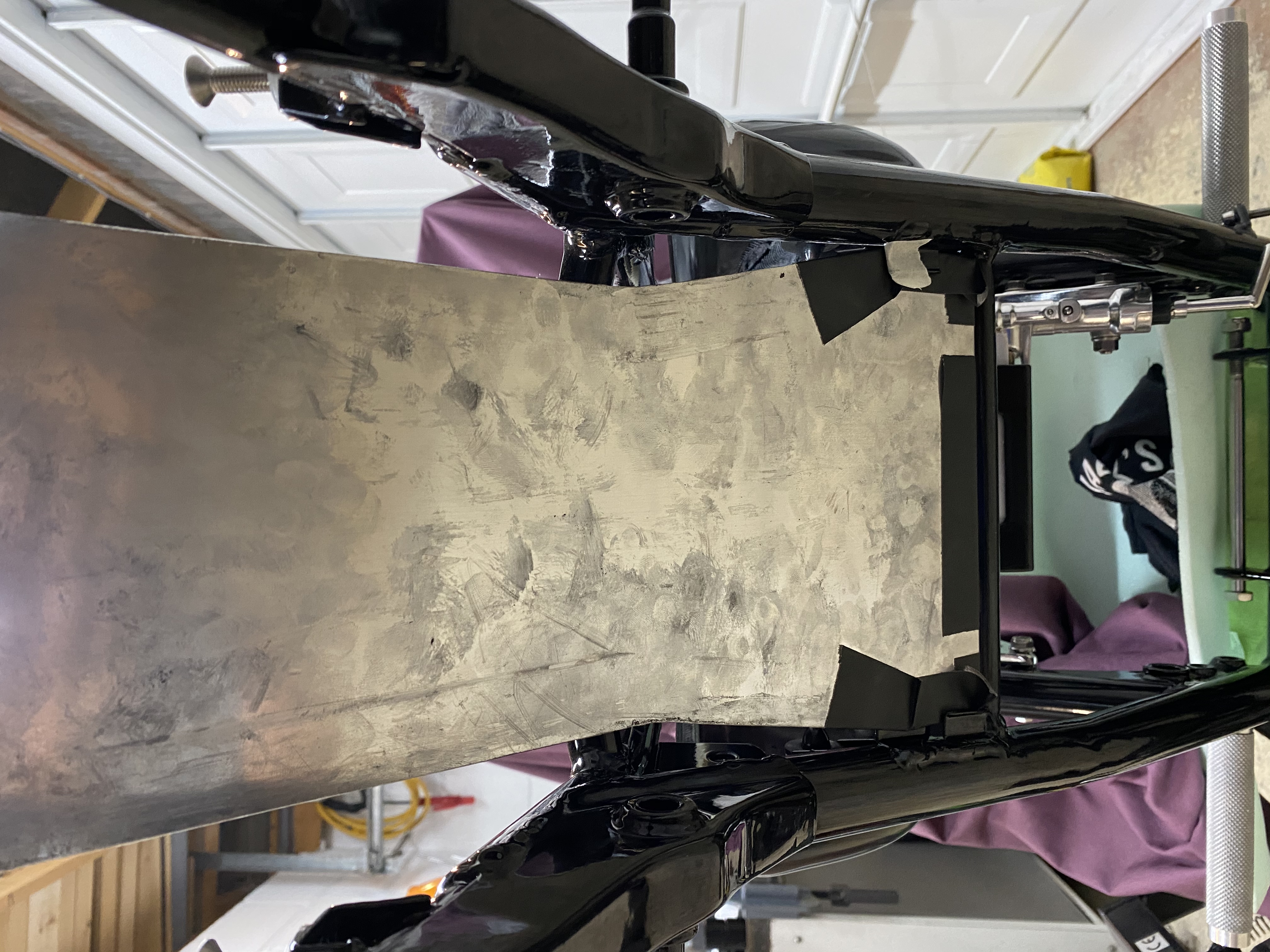

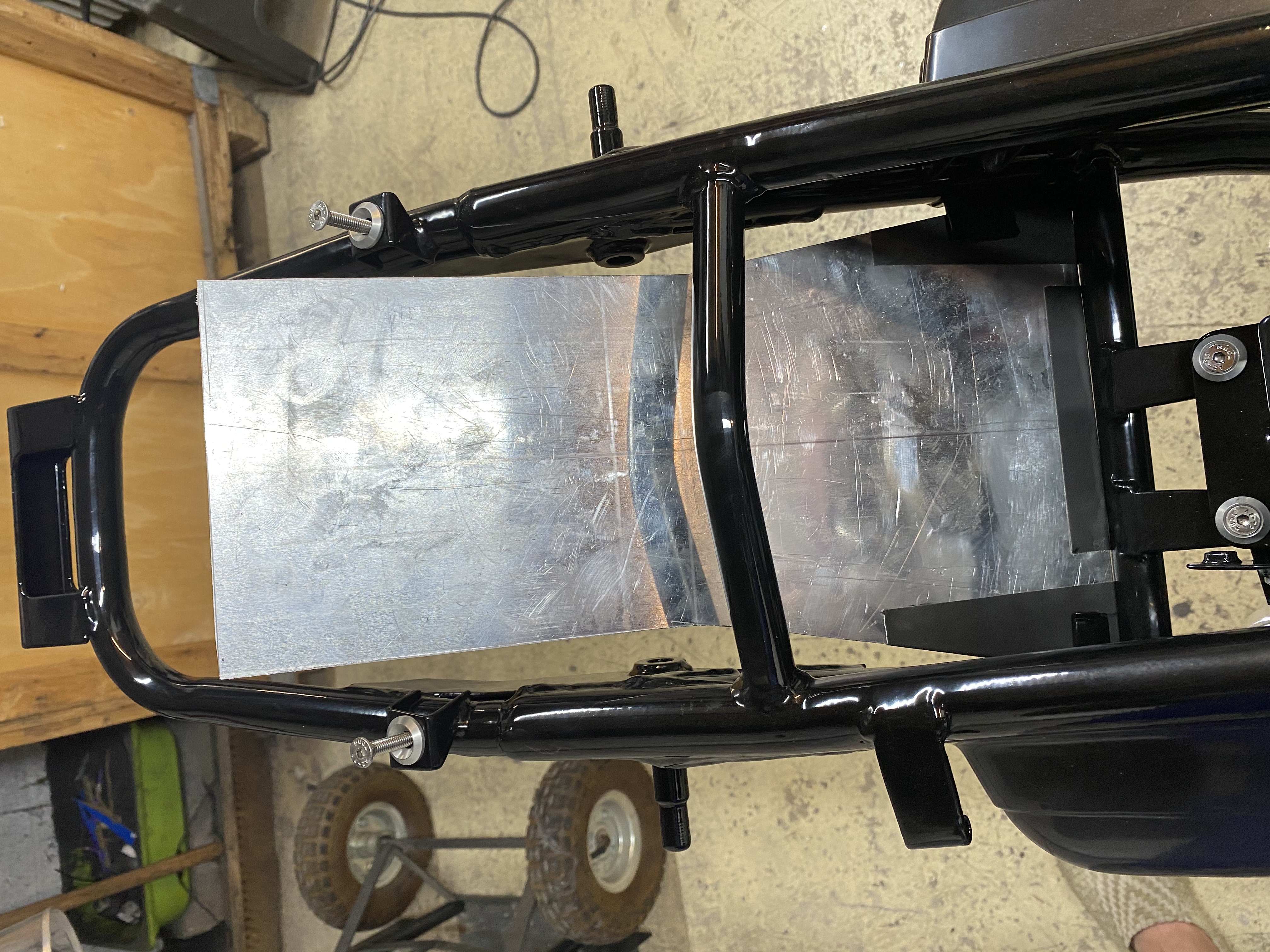

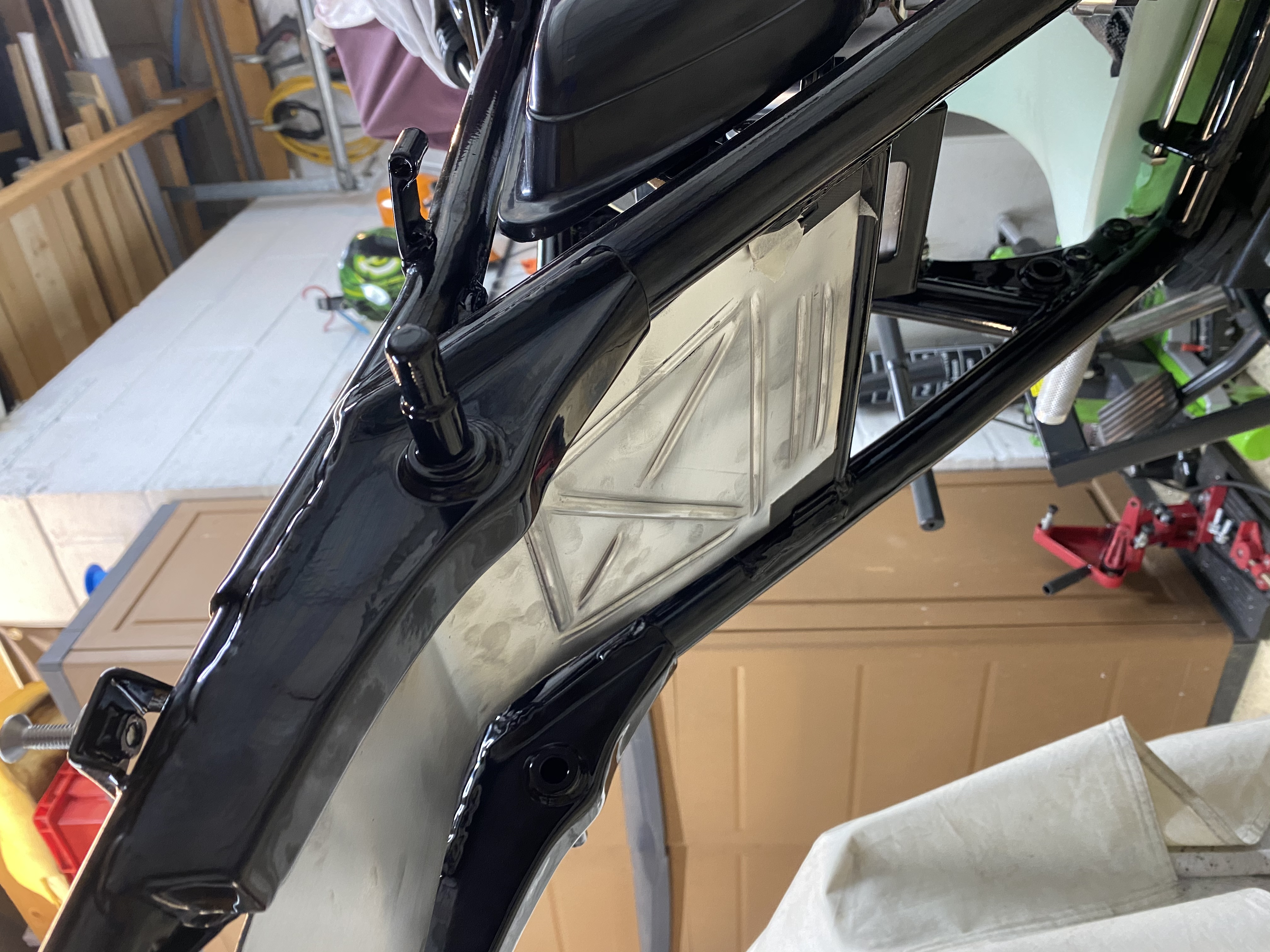

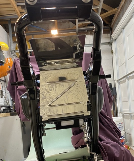

First stab at the rear mudguard.. still plenty of fettling do but as a first run working out not too bad!

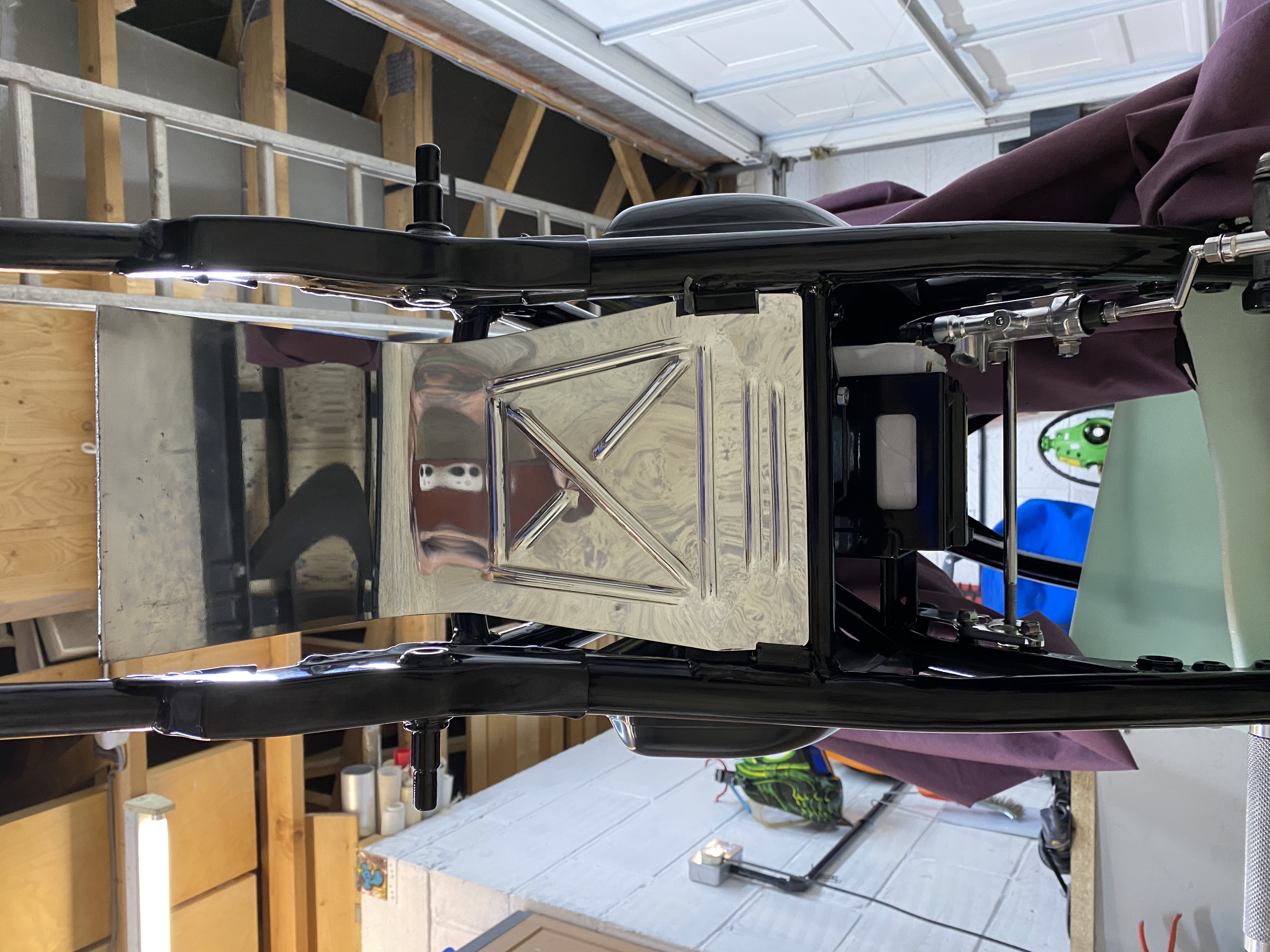

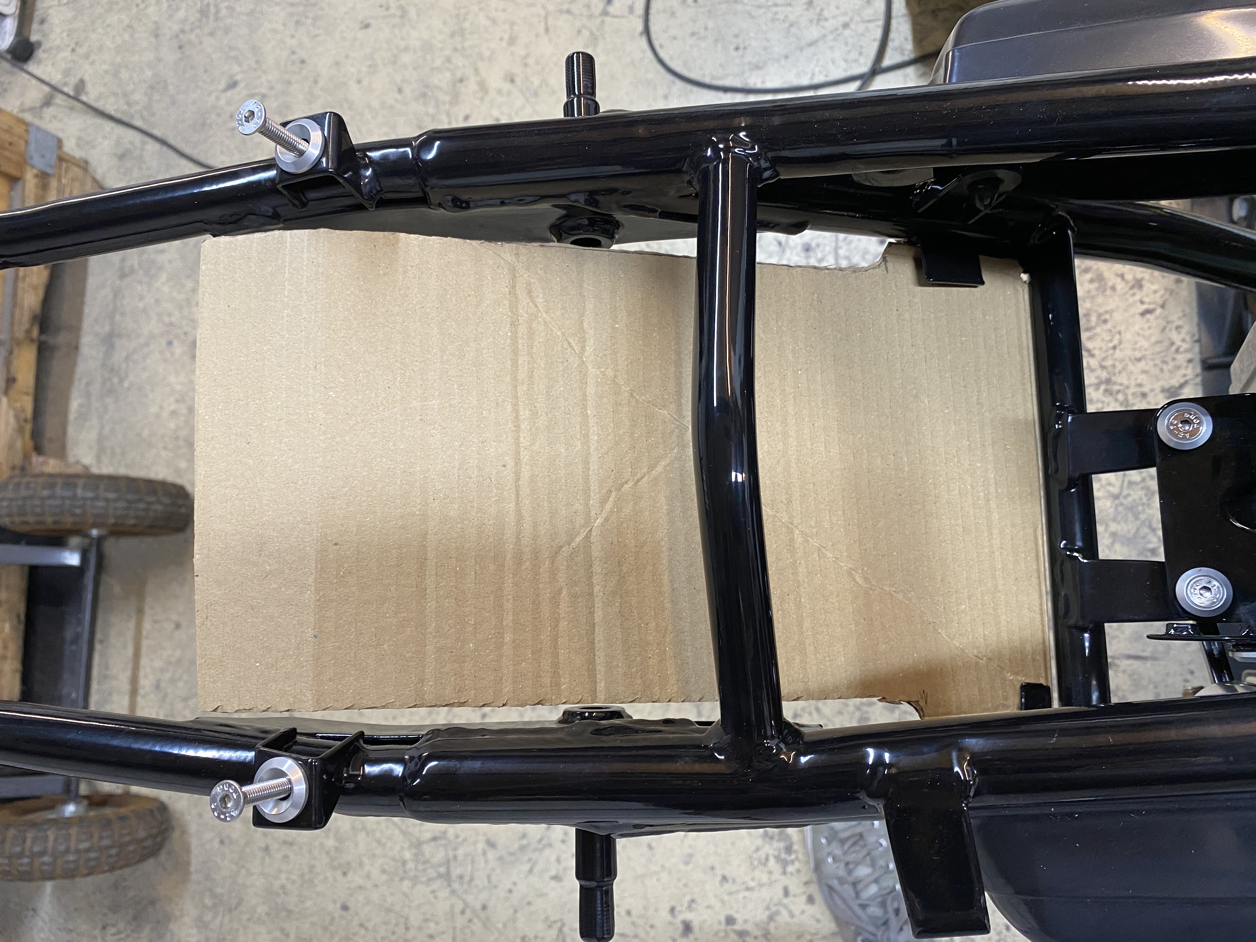

#28 PostAuthor: thebuelligan » Fri Aug 07, 2020 9:37 pm
Little more fettling done

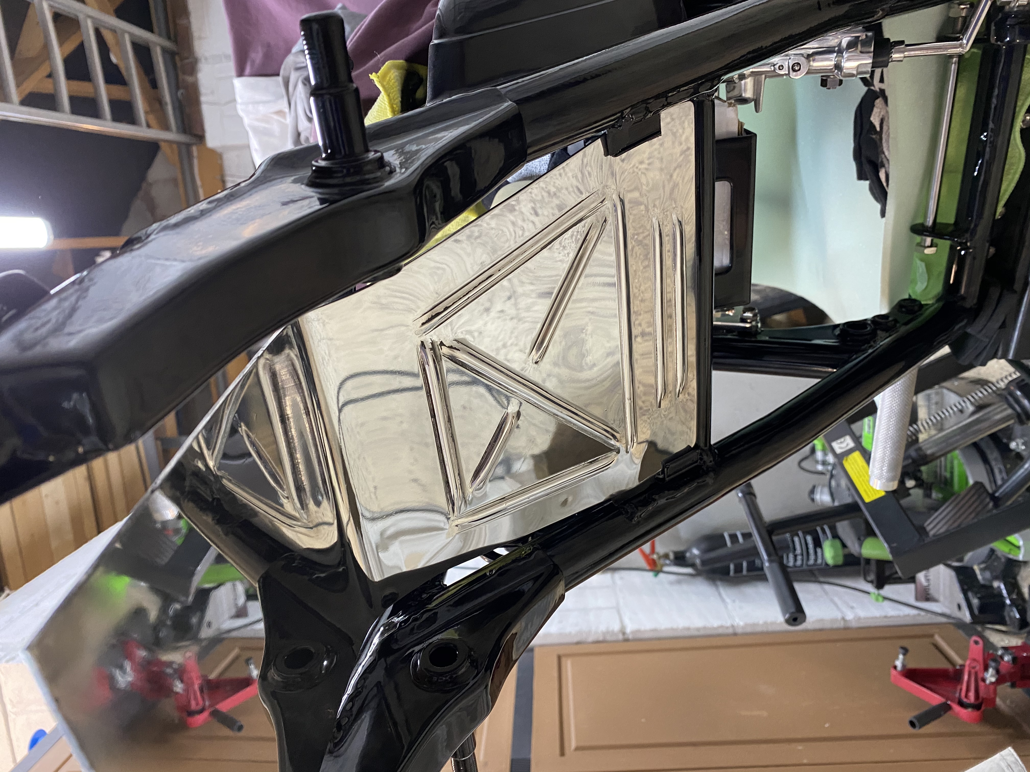

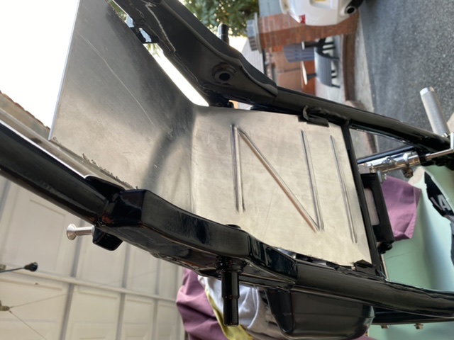

#29 PostAuthor: thebuelligan » Sat Aug 08, 2020 6:55 pm

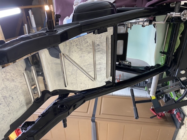

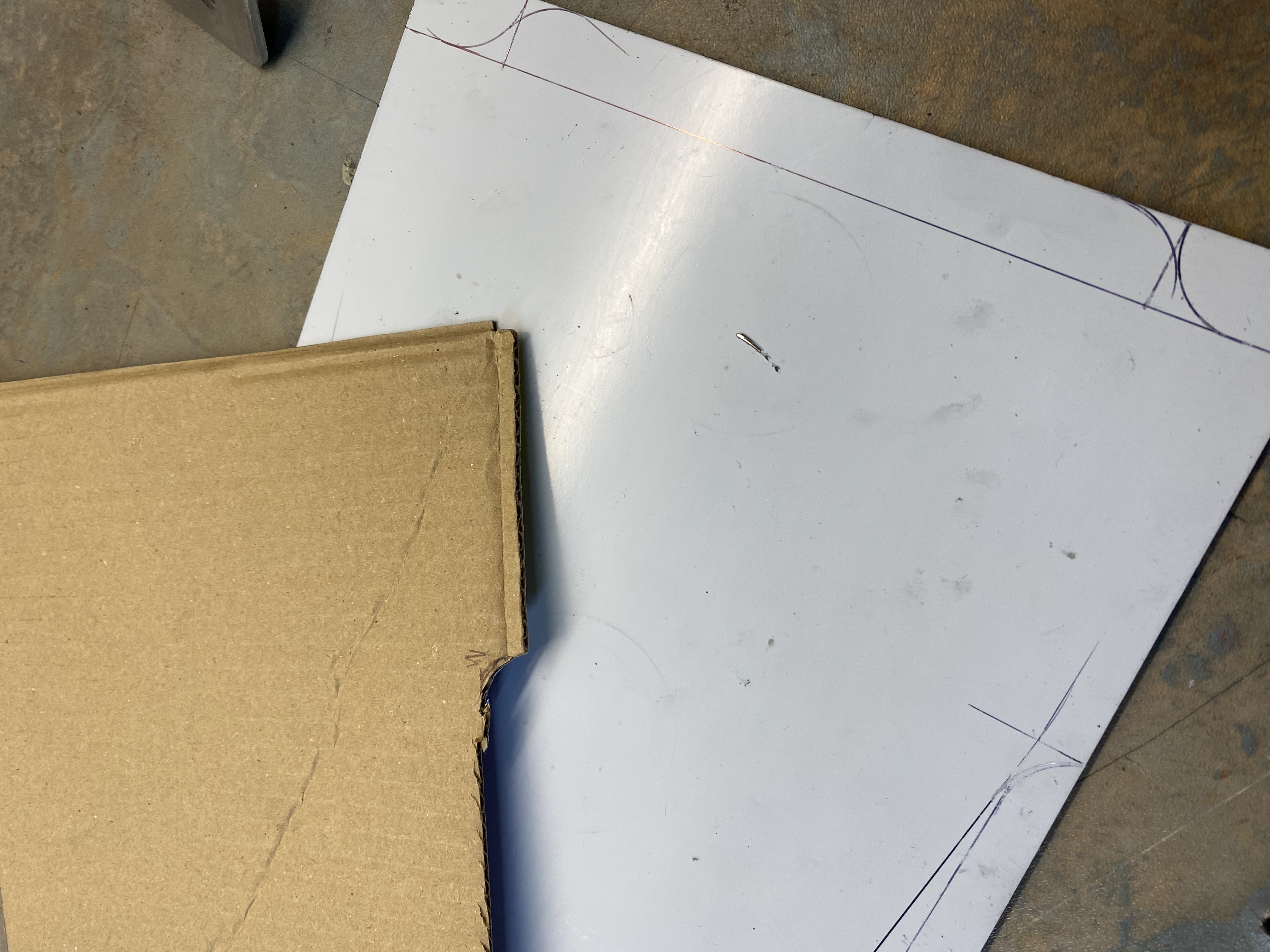

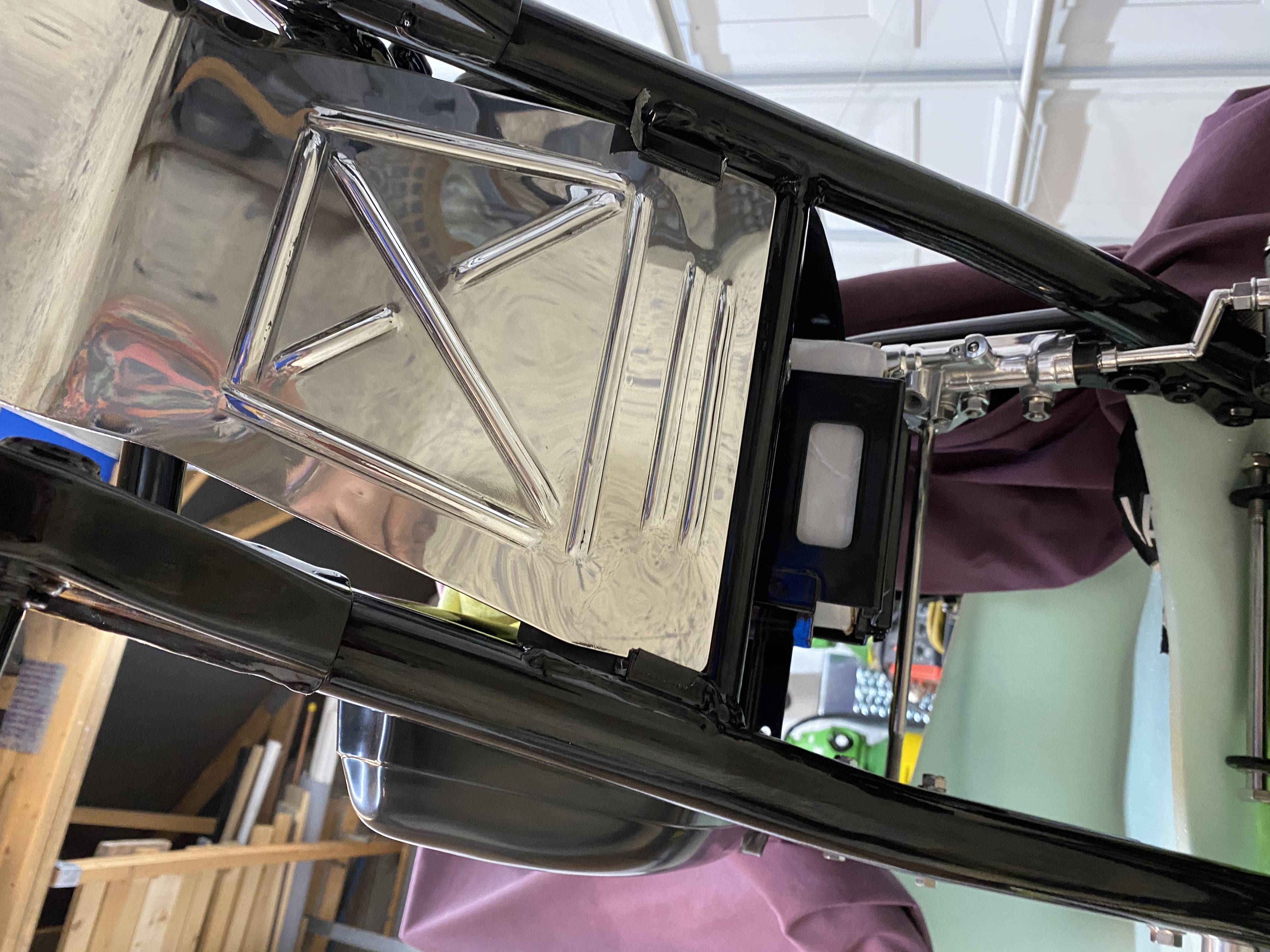

Attempt number 1 was a little busy so version number 2 is a more simplistic “Z”
See what it looks like after polishing!

#30 PostAuthor: thebuelligan » Sun Aug 09, 2020 8:52 pm
Polished up
