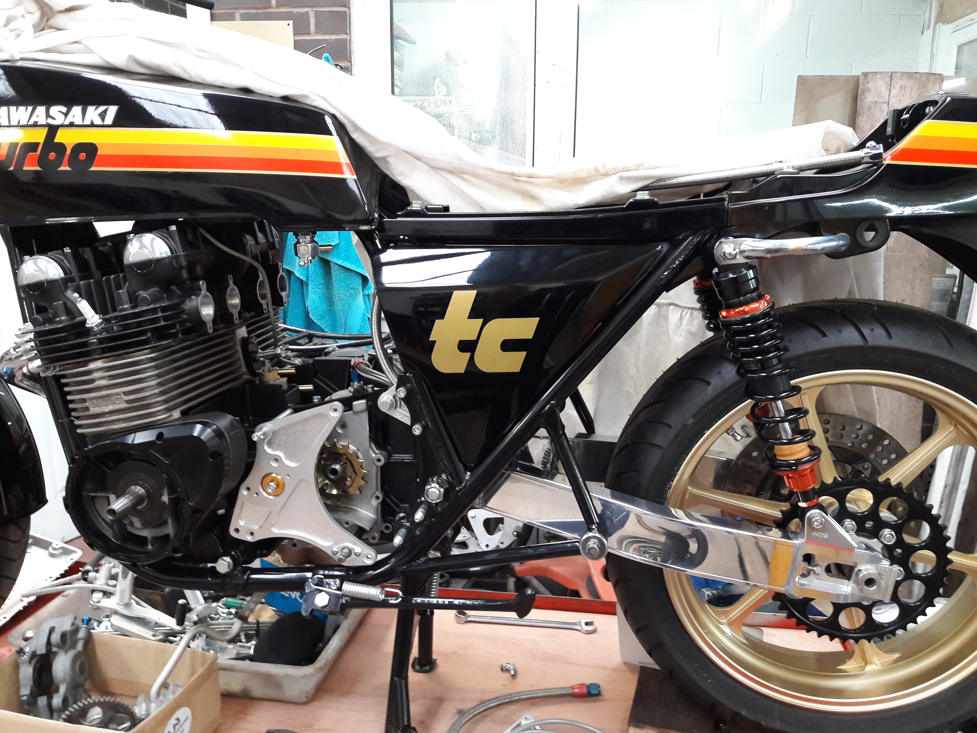

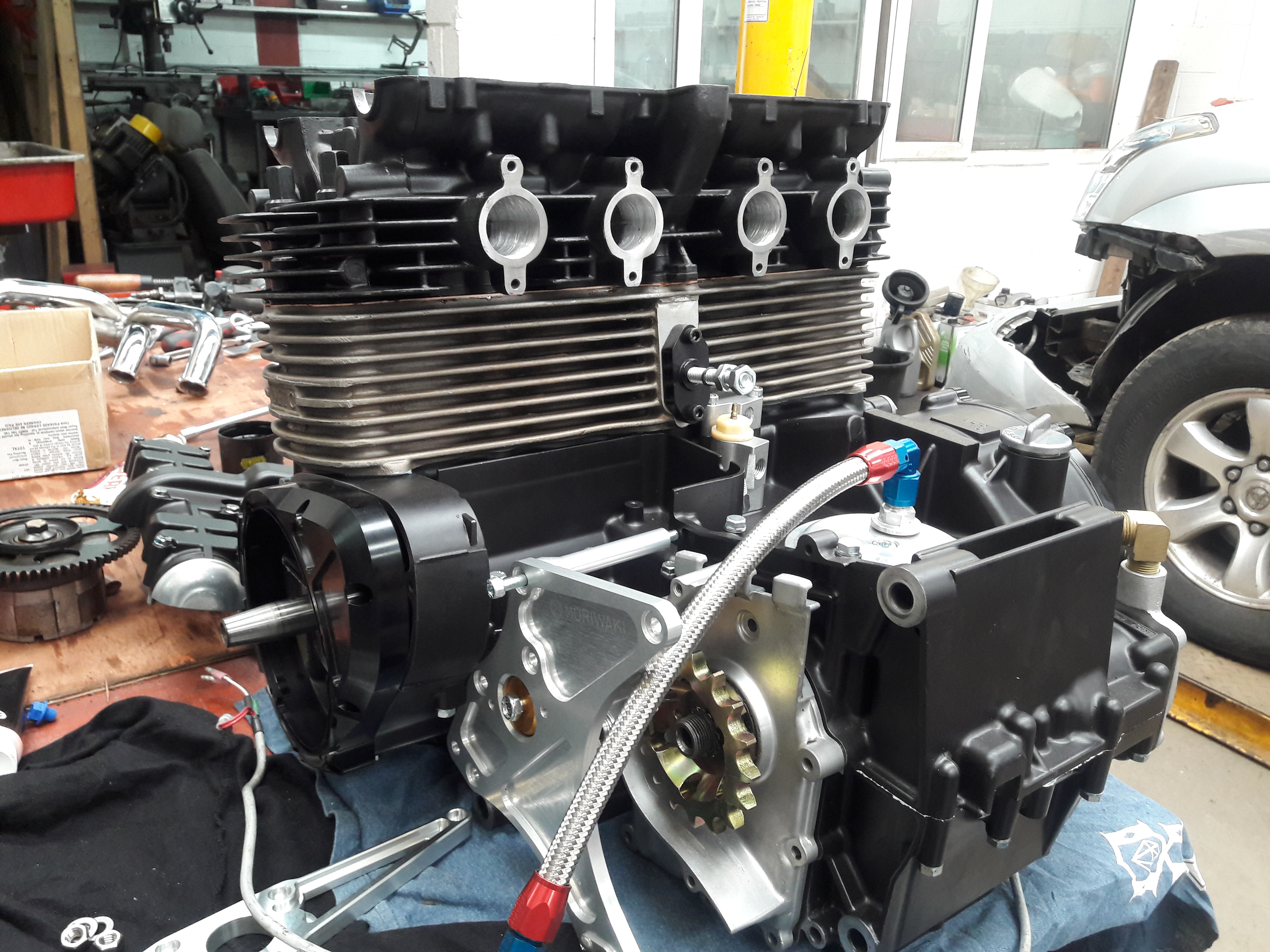

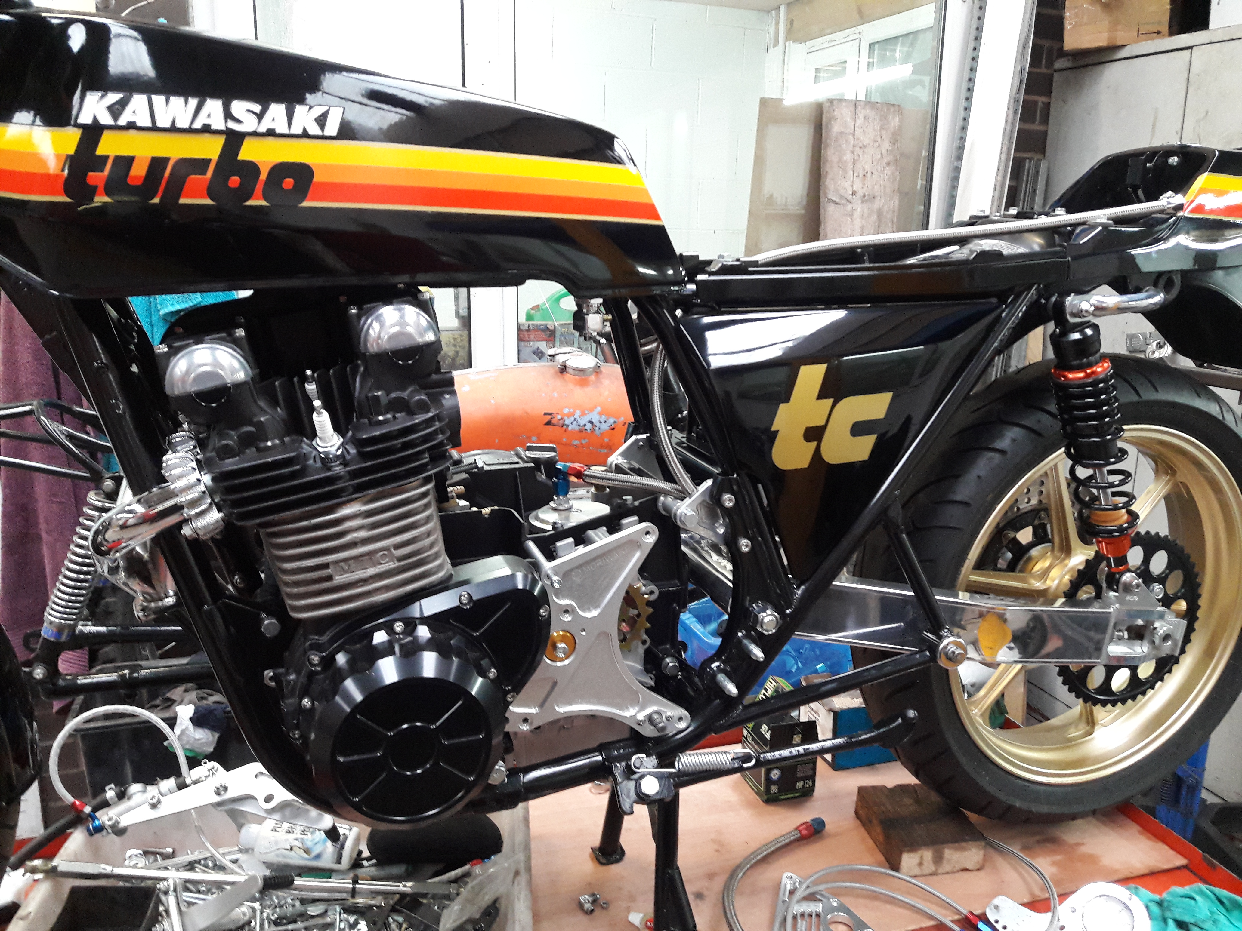

more pics of the turbo build

I like your swingarm... who makes it and what's the max tyre width it can take?

Gonzo wrote:I like your swingarm... who makes it and what's the max tyre width it can take?
https://www.saisei-europe.com/Shop/Prod ... rm-type-11

what size is the motor 1327? see you are using a MTC big block

#21 PostAuthor: hotrod » Fri Mar 23, 2018 9:48 pm
its a 1260 with low comp pistons ,liners are quite thick so the bores will be stable ,plus loads of room for re bores when it goes bang
it is a pmc job ive got a 4.5 rim with a 160 tyre but there is room for a wider set up
It will take a 170 tyre.

Nice build Hotrod, sensible size 1260cc as you say nice & stable with loads for rebores if necessary.
What size valves has the head got in it & who done the porting?

saltflatracer wrote:Nice build Hotrod, sensible size 1260cc as you say nice & stable with loads for rebores if necessary.
the valves are the std size ive done all my own engine work its had the ports cleaned up but not ported ,

#29 PostAuthor: Big Fluff » Tue Apr 10, 2018 3:00 pm
Just be sure to fit boost activated retard if you plan to go over 5 psi.
If you don't, then as you say you WILL be reboring it on a regular basis!
You'll also need at least one additional crankcase breather.
