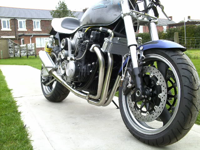

Exhaust looks much better than the harris :D

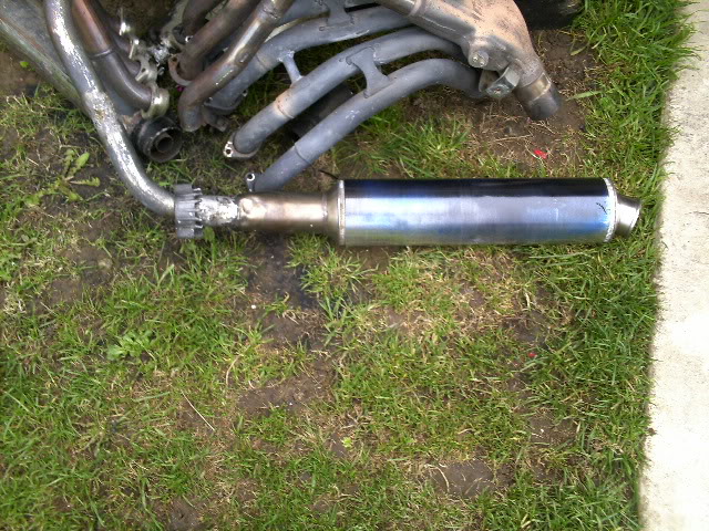

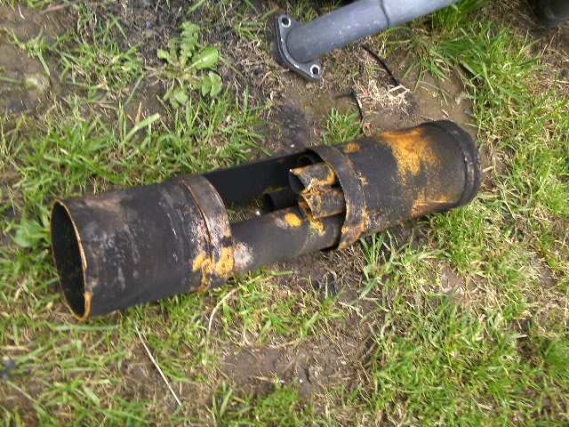

Had a manky CX500 trike in recently for a bit of work and a service. Had a pair of these awful ducati cans grafted on and mounted to the footrest rubbers with wood screws :shock: HO HO! Kept burning his feet.
Built him a stainless 2-1 with gixer 1000 can and ended up tripping over the remains for the past week. Had nothing to do this weekend and was going to bin the cans but had a bit of a brainwave and did this. >>-->
Dismantled the best looking can and chucked the mechanical baffle

#126 PostAuthor: zed1015 » Mon Apr 13, 2009 10:57 am

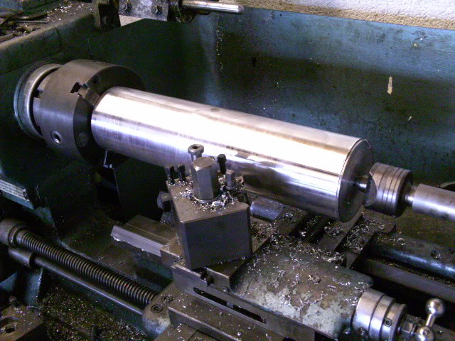

Stuck the ally sleeve in the lathe and skimmed off the mouldy anodising and ducati logos.

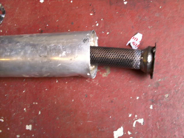

Then extracted the perforated baffle tube from an old oval can .

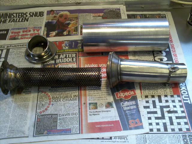

Then after cutting down the sleeve i modded the salvaged baffle and tidied up the stainless ducati end caps and ended up with these.
Posts: 4034
#127 PostAuthor: zed1015 » Mon Apr 13, 2009 11:08 am

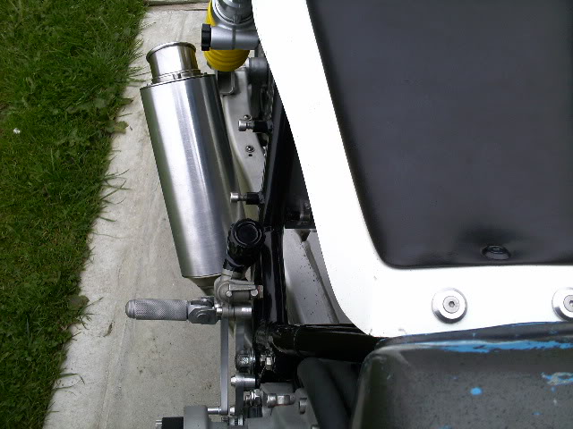

And here is the result >>>
Not turned out too bad ? Just got to finish the finer details,polish and pack it and maybe play with the angle before i make the hanger.
