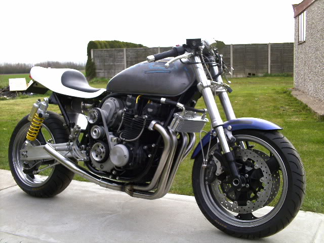

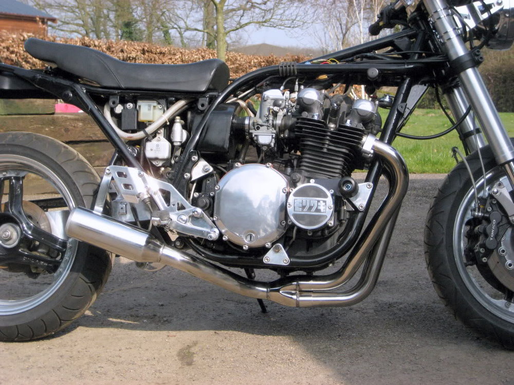

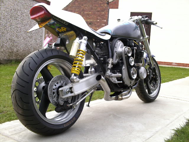

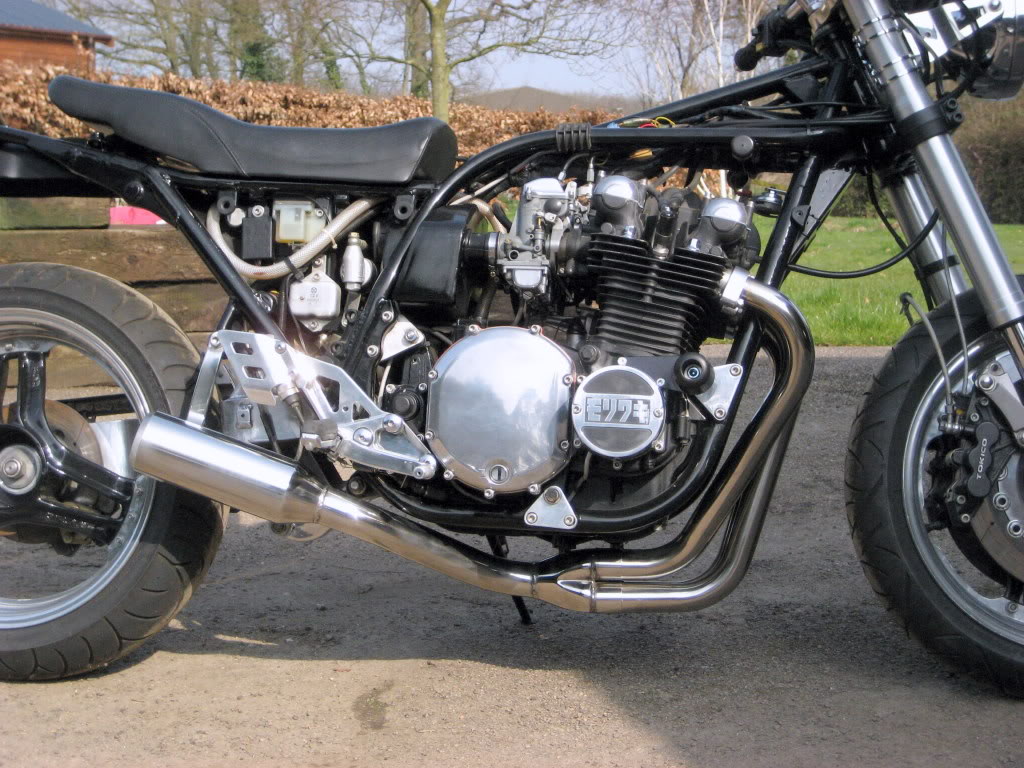

Finally got an exhaust sorted out. After mucho fruitless searching of autojumbles and evil bay i finally went against my religion and actually spent some proper cash. After negotiations with exhaust craft we came up with a slightly altered version of the 4-1 headers and collector he produces. I wasn't too keen on how the std version sits away from the frame harris style so got him to fetch everything closer to the engine for a more tucked in look which you should be able to see in comparing the two pic's.

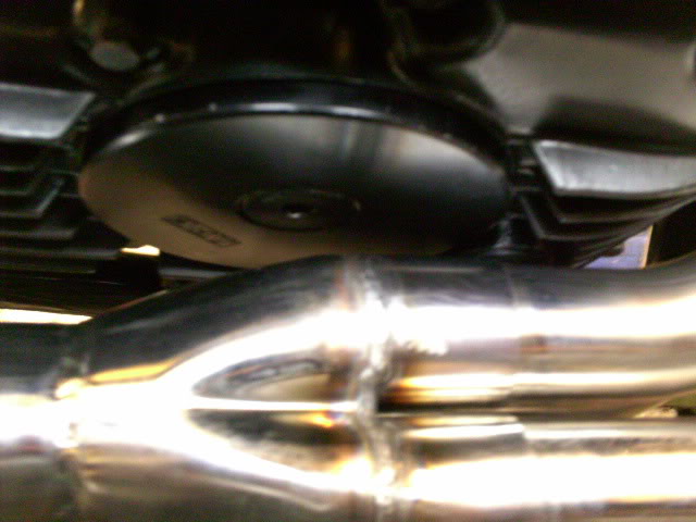

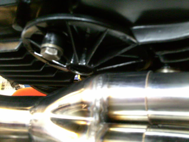

A not unexpected result of the exhaust alteration meant that the collector sat a couple of inches further back and seriously fouled the oil filter housing.

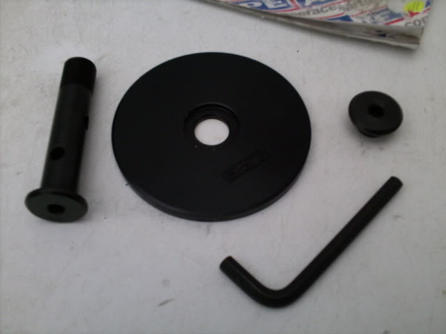

Not wanting to shorten the headers and move the collector forward i fitted one of mister APE's low profile filter covers and drain plug
These use an allen cap head style bolt head as opposed to the std hex bolt head and sits higher than the sump finning
