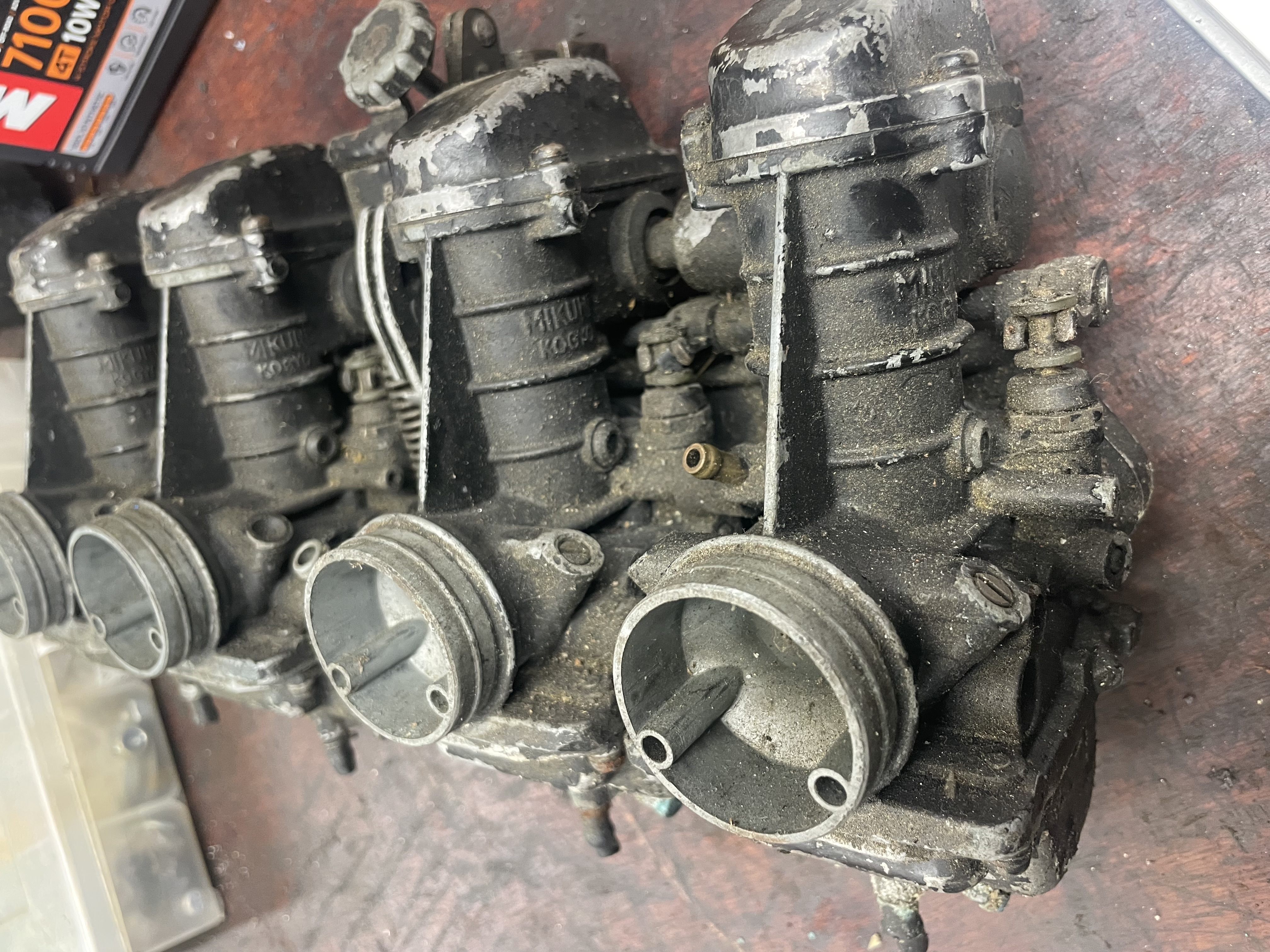

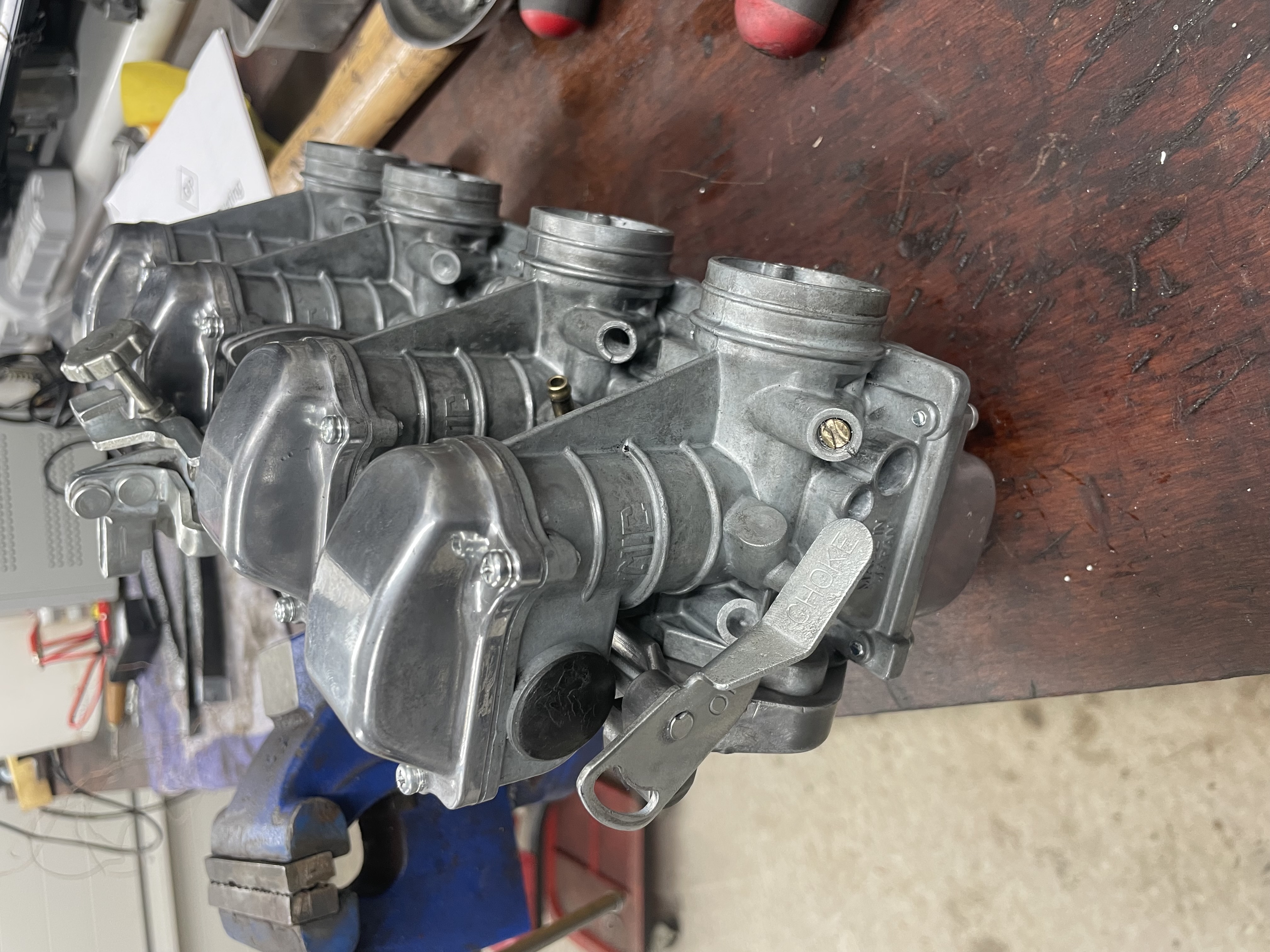

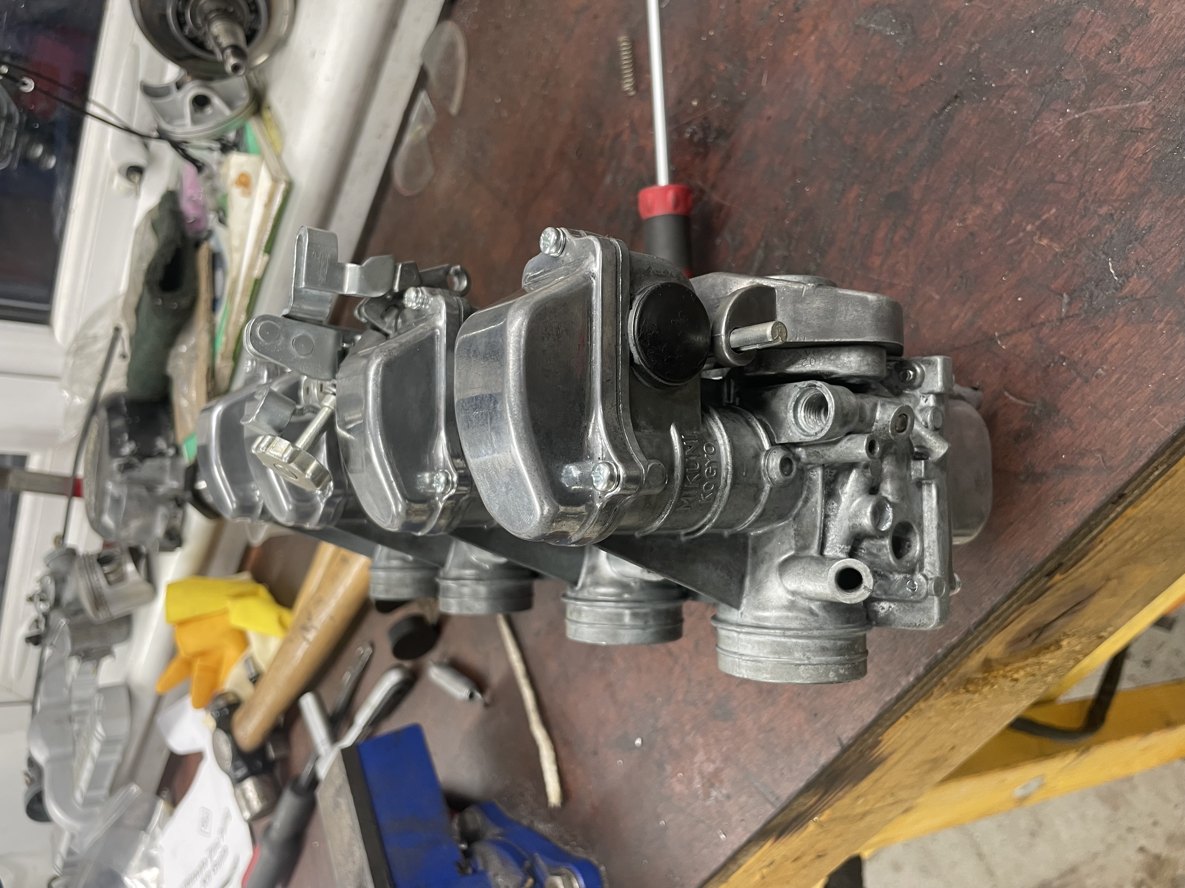

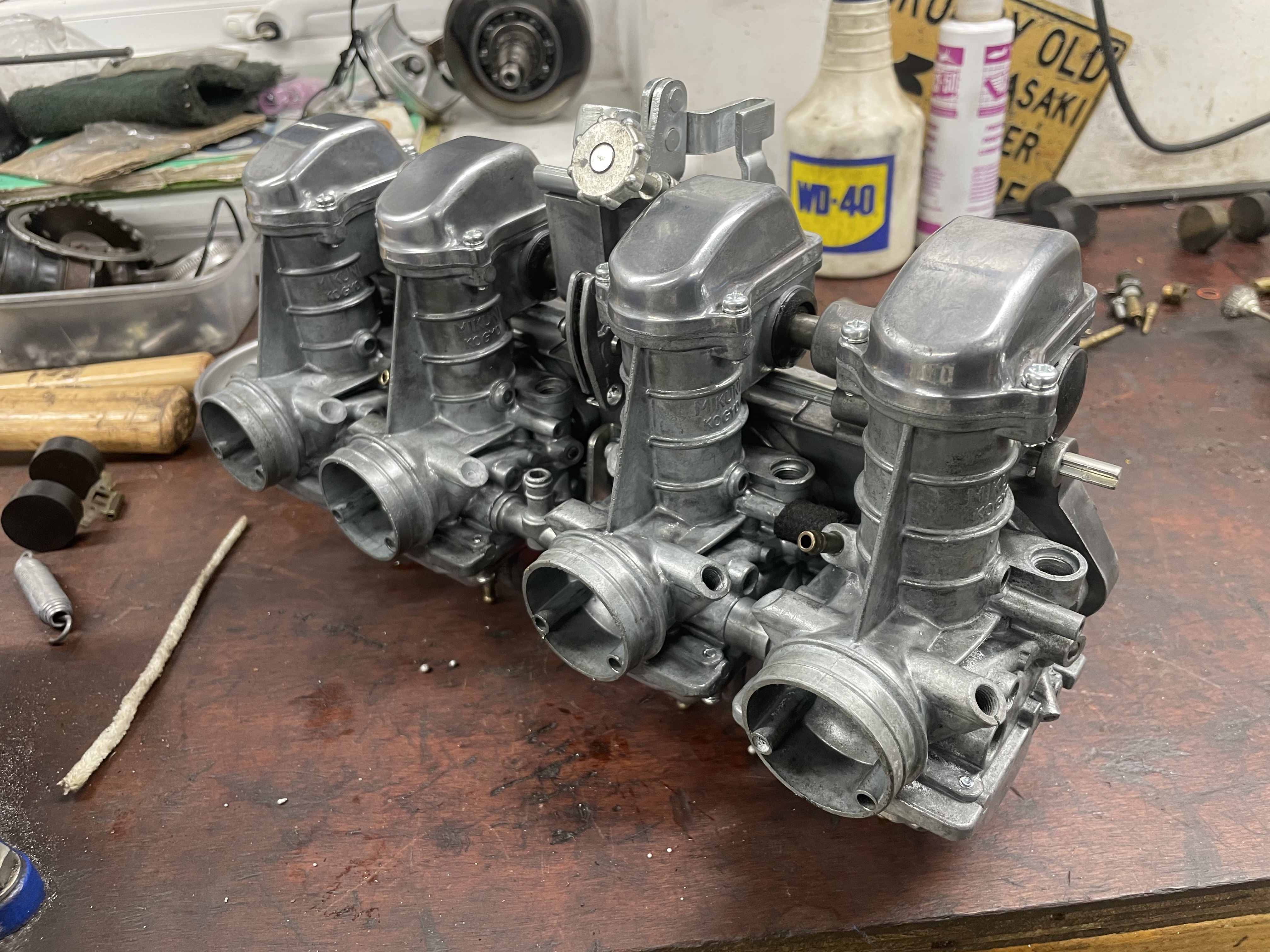

Managed to get a day on carbs today, did some plating and cleaning and looming nae bad! Bought a carb rebuild kit which is total garbage of eBay.. Apart from the gaskets all useless, so will still need to order a few bits. But happy with the progress.

Nice job on the carbs :up Looks like a bit of hard work ! What did you use to shift the black paint ? I've a clutch cover here I've coated with Nitromors twice now but it seems the modern stuff just doesn't work - its only rattle can black I'm trying to shift - it'd be quicker to just scratch the paint off with my finger nail.... It looks like you did better than me ! Just wondering what you used :lol:

DeadZedDave wrote:Nice job on the carbs :up Looks like a bit of hard work ! What did you use to shift the black paint ? I've a clutch cover here I've coated with Nitromors twice now but it seems the modern stuff just doesn't work - its only rattle can black I'm trying to shift - it'd be quicker to just scratch the paint off with my finger nail.... It looks like you did better than me ! Just wondering what you used :lol:
Hi Dave, I used some sort of paint stripper to start, I can’t remeber what brand to be honest, it took a fair bit off then I remover the remainder with my magic dremel and small wire brush. Still removing the pieces of wire from my skin now 6 months later

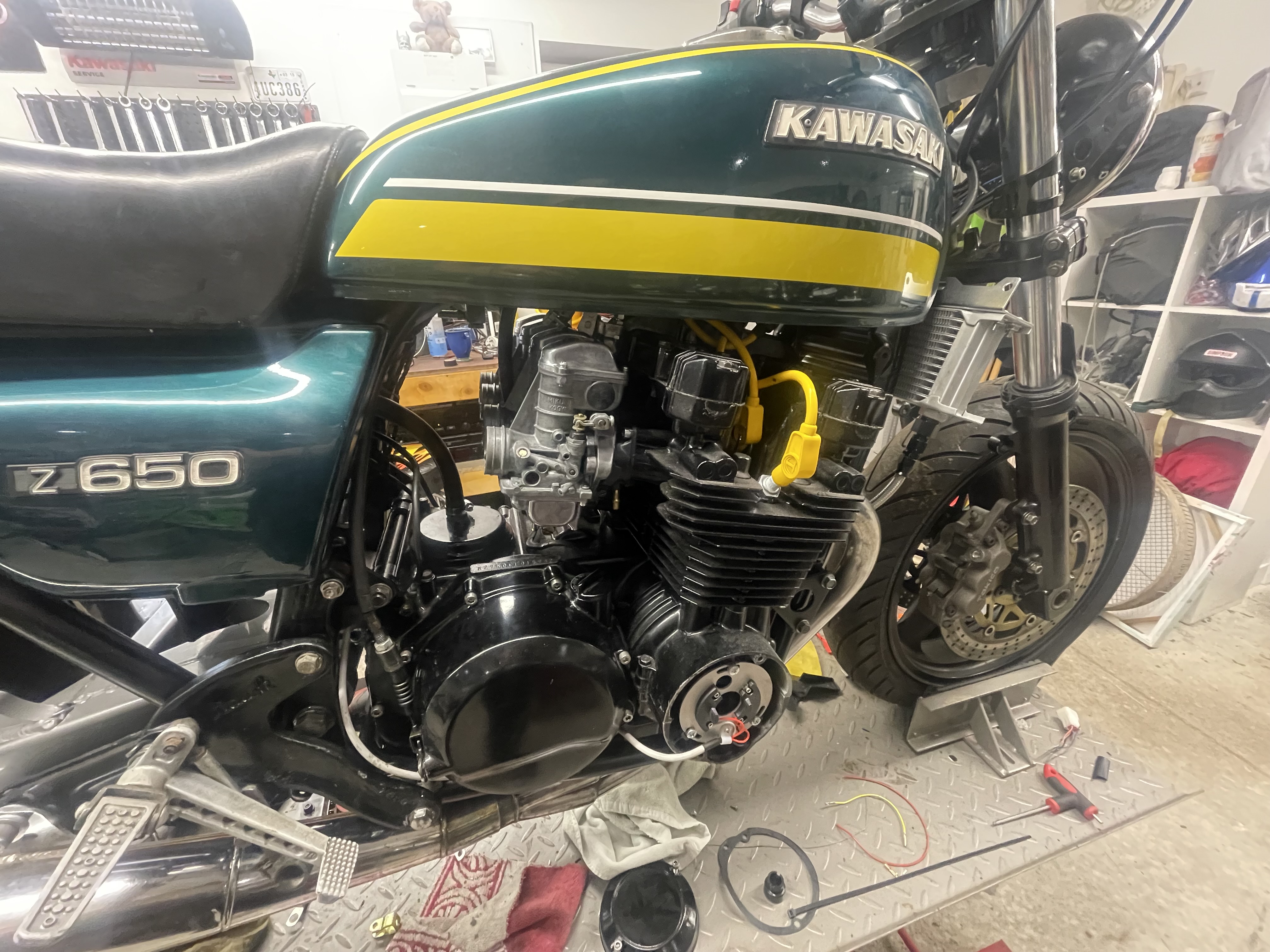

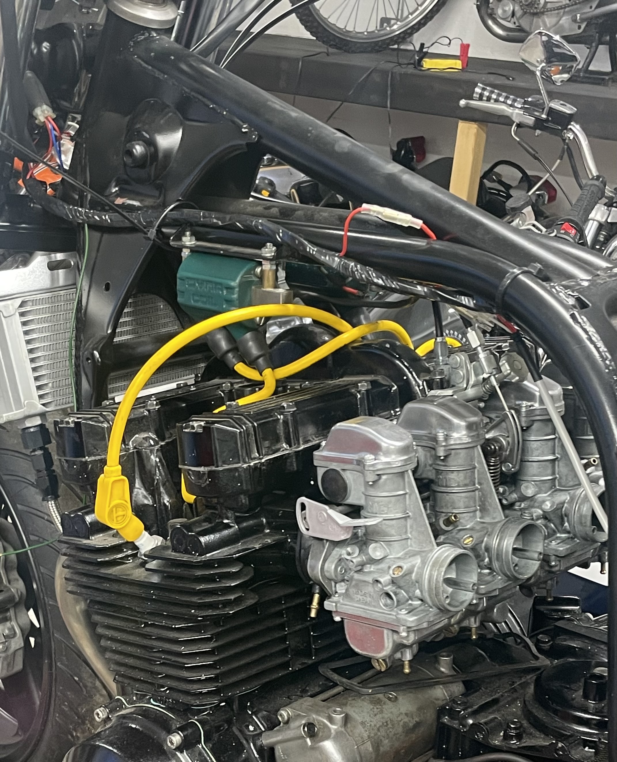

Hi All

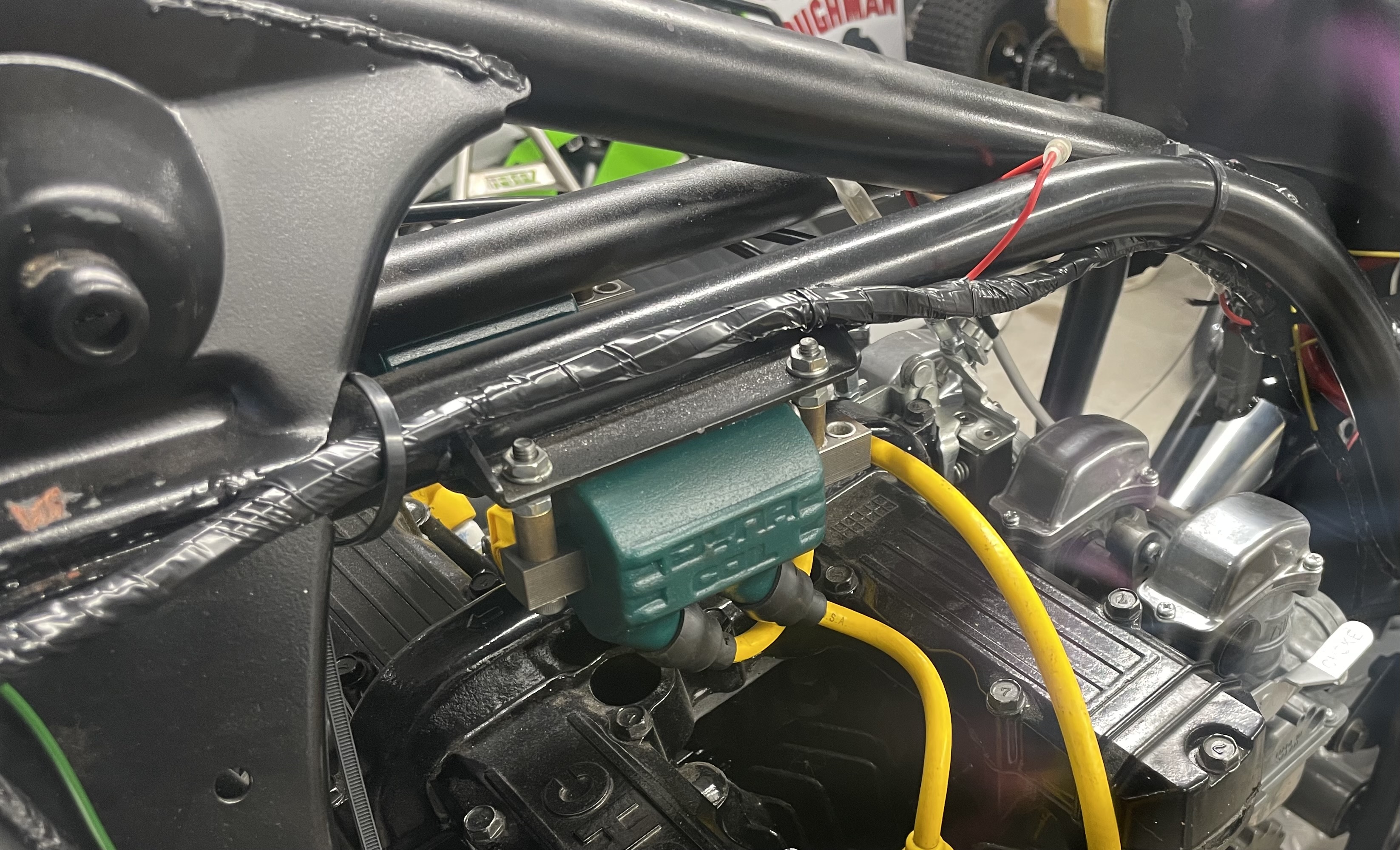

Not posted for a while so thought I would update. It’s progressed a good bit. I built my first ever scratch built wiring loom, well happy with it as it’s a tenth of the size of the factory one and has all the functions I needed. (Ignition and lights) lol. Any nice to haves were junked. Kitted out with the finest of cheap shit switch gear we will see how long the last bit it’s coming together. All I need now to fire it up is a mechanical advancer as I can’t fine one anywhere.
Remaining jobs - Rear Brake Caliper. Brake lines all round. For filters and chain. Very close! Be ready to put away for winter lol.

Dave I remember now it was hycote spray can stripper. It worked fairly well have used it a few times. Much better than modern notromors.

Paint panther work quite well

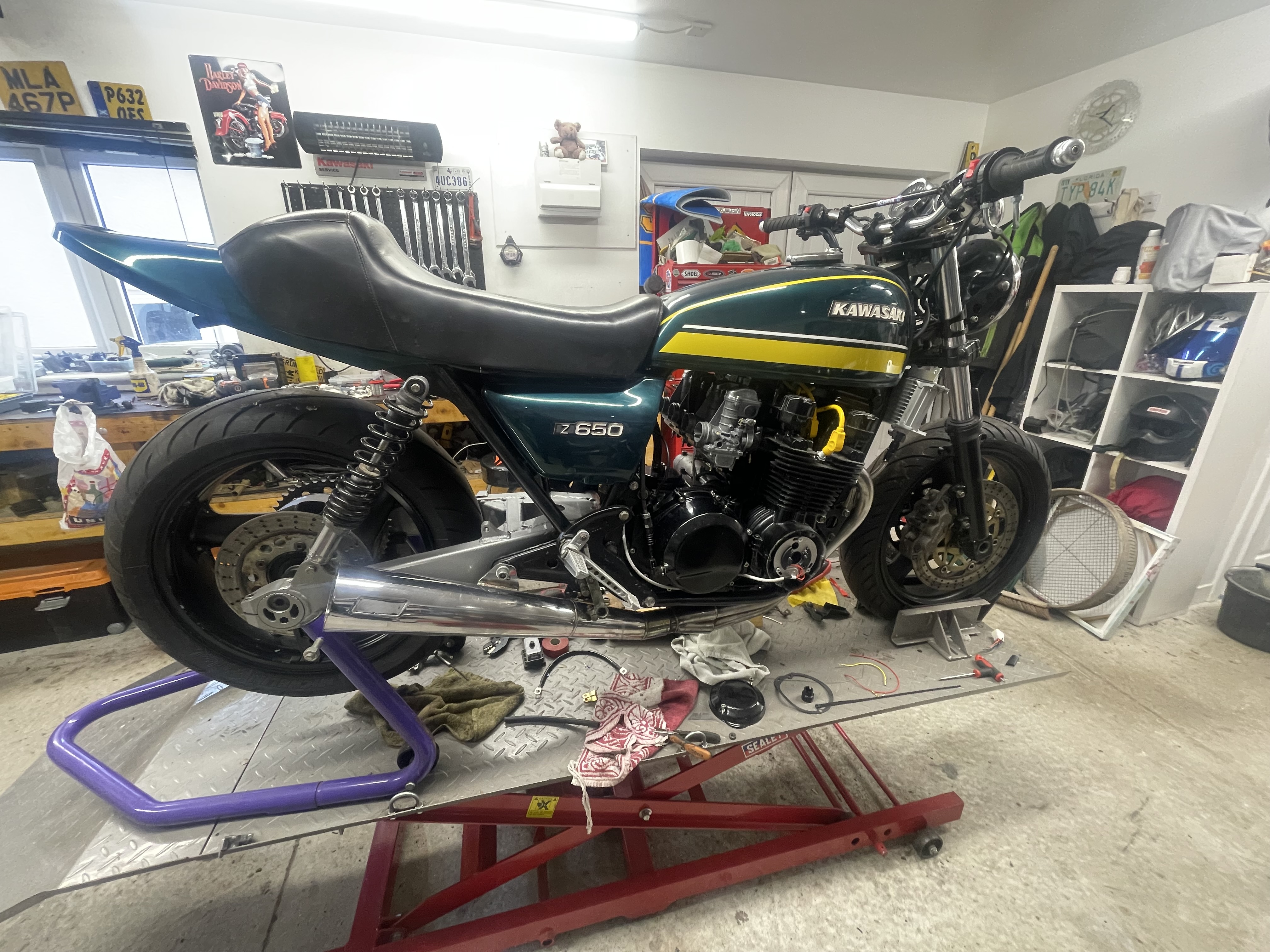

Got the 650 fired up today finally. Usual dodgy starter clutch issues even though I replaced everything when I rebuild the engine. Ugh. Can live with that though. Carbs need a bit of fettling but will be spot on after a wee tweak. Just need to finish my brakes and add a chain for test ride.
