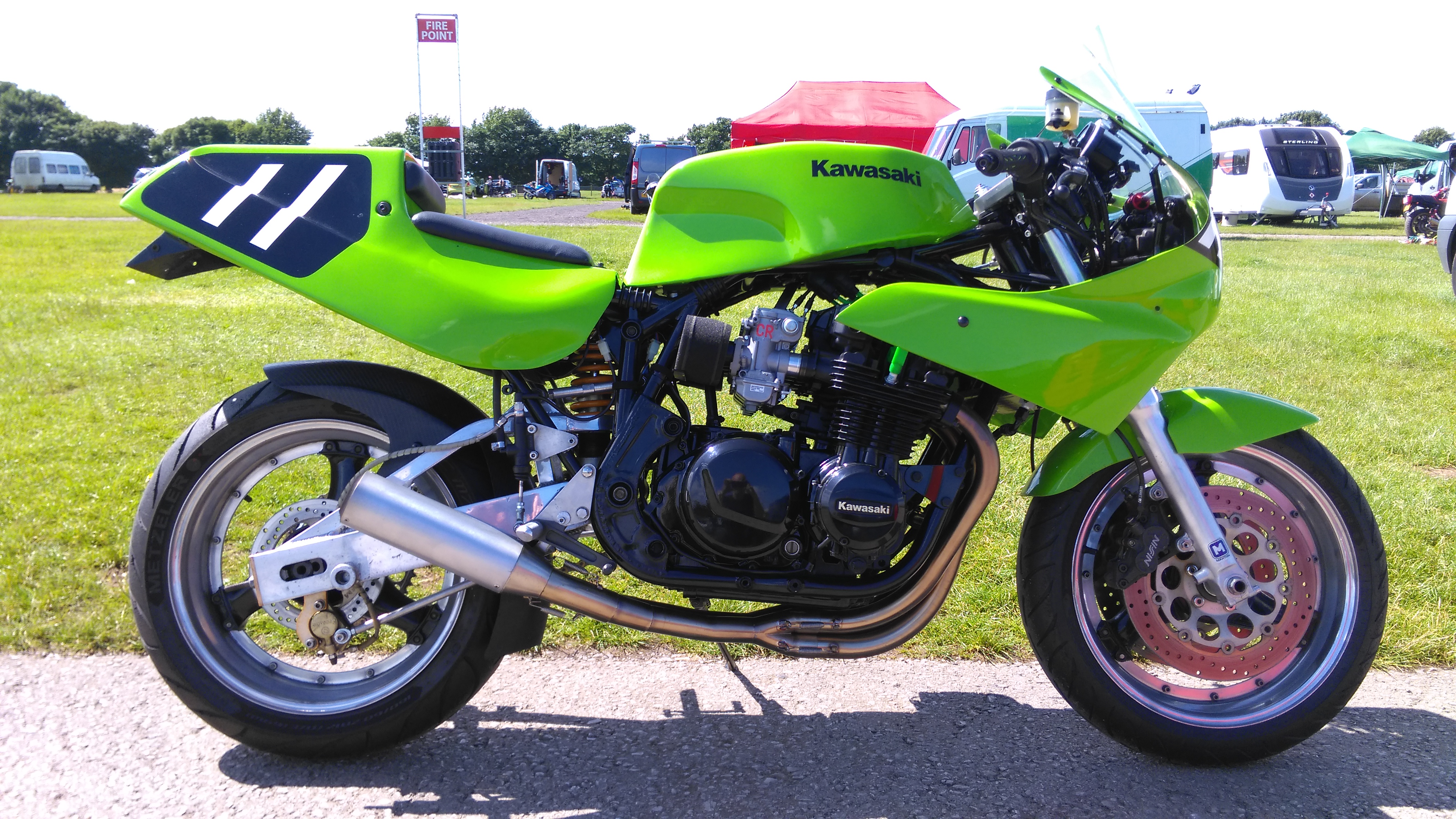

That would have been a lot of drill and tap time but results speak for themselves. Very purposeful and unique into the bargain. Do i take it you run tubes in them? I do with the Astralites because it would be unthinkable for the gasket to let go if a rivett popped or similar. Tubes do cause me a few problems but not something i could consider living without and no real regrets after ten years on track so mustnt complain.
Your built up wheels put me in mind of these a little. Also nearly unique as i believe they are only on the GPz 750's framed by P&M and they didnt make many.
Agree with your comment about the bolts and nuts, it does look a little shonky but there for a reason and it seems to work.
