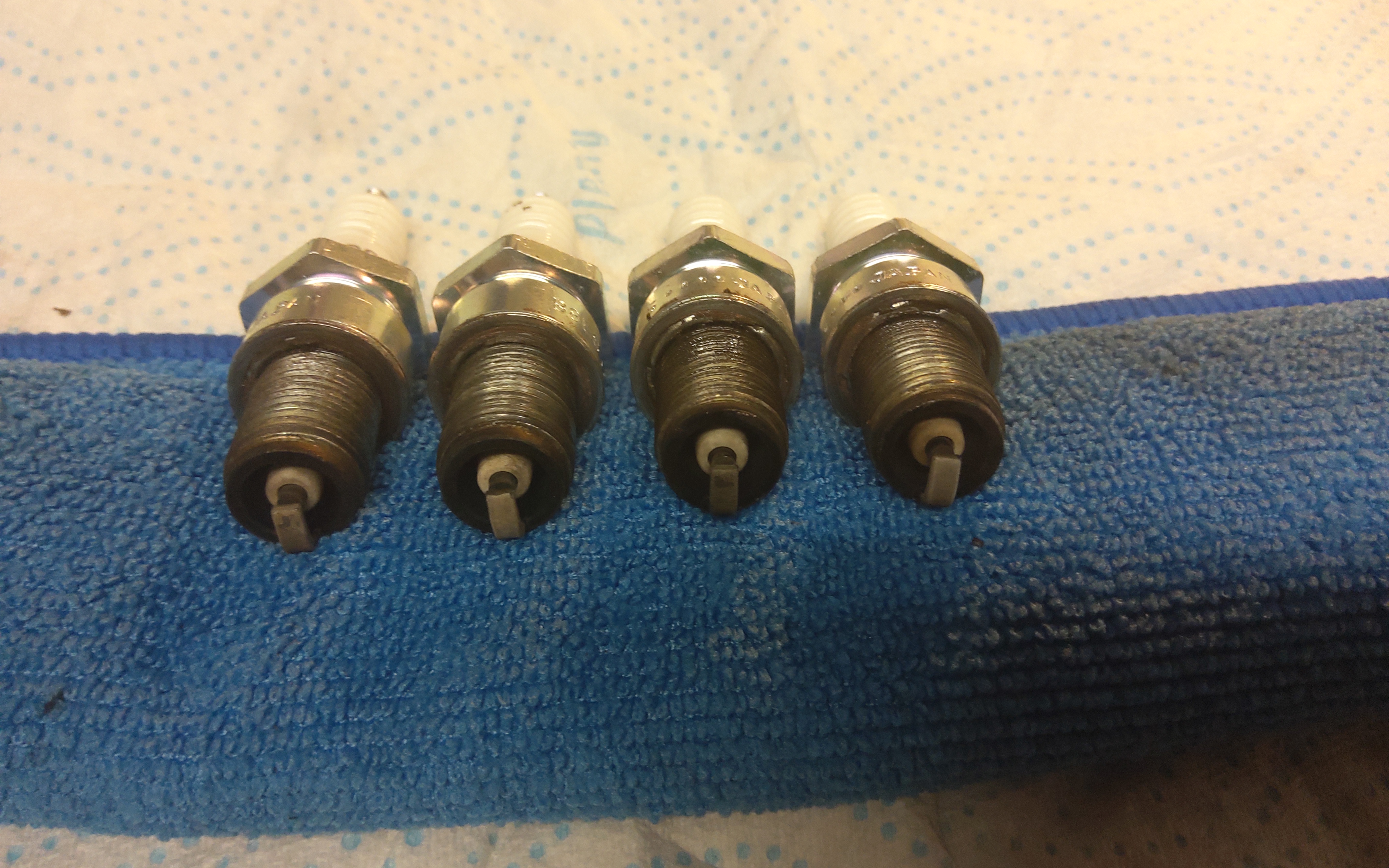

Couldn't check the two head bolts without removing the outer two plugs, so removed all four just to check and was fairly happy with the result (see pic). Maybe a tadge on the lean side but I'll settle for that at the moment. It's running on Esso Supreme (shit free fuel) so near enough what it was originally designed to run on.
Will fire up again tomorrow and hope all goes well with the new HT leads. If it rides OK will be driving up to friends in Bucks so that should give it a good run.
Plugs with #1 on the left through to #4 in order.

They look a little on the rich side, which to be fair, is more useful for air-cooled engines.
I have been using this for a few years and find / have found it to be very accurate, in that it predicts and is representative of changes i have made whilst using it.
http://www.wallaceracing.com/plug-reading-lm.html
QUOTE: NOTE: If the base ring has a full turn of colour with some spots of heavy dry soot, then jetting is too rich, REGARDLESS, if the porcelain is "BONE-WHITE", jetting is still TOO RICH !!!
NOTE: Do not look at the porcelain to read jetting !!!
This is how things were in 1977!!
http://www.dansmc.com/spark_plugs/spark ... talog.html
You can enlarge any pic by clicking on it.

Cheers Al. After 51 years on a bike I still believed that the condition of the porcelain was how you checked the mixture. Thanks for setting me right. Every day's a school day!
