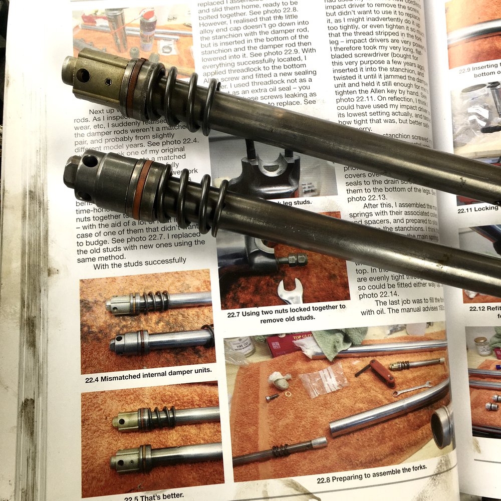

#32 PostAuthor: Johno23 » Sun May 09, 2021 2:55 pm
Stripped down the forks today. The dampers are different but only in the shape of the top bit. Does this matter as I can’t see what difference it would make to have two the same. Also, do I need to change the piston and that orange washer?
