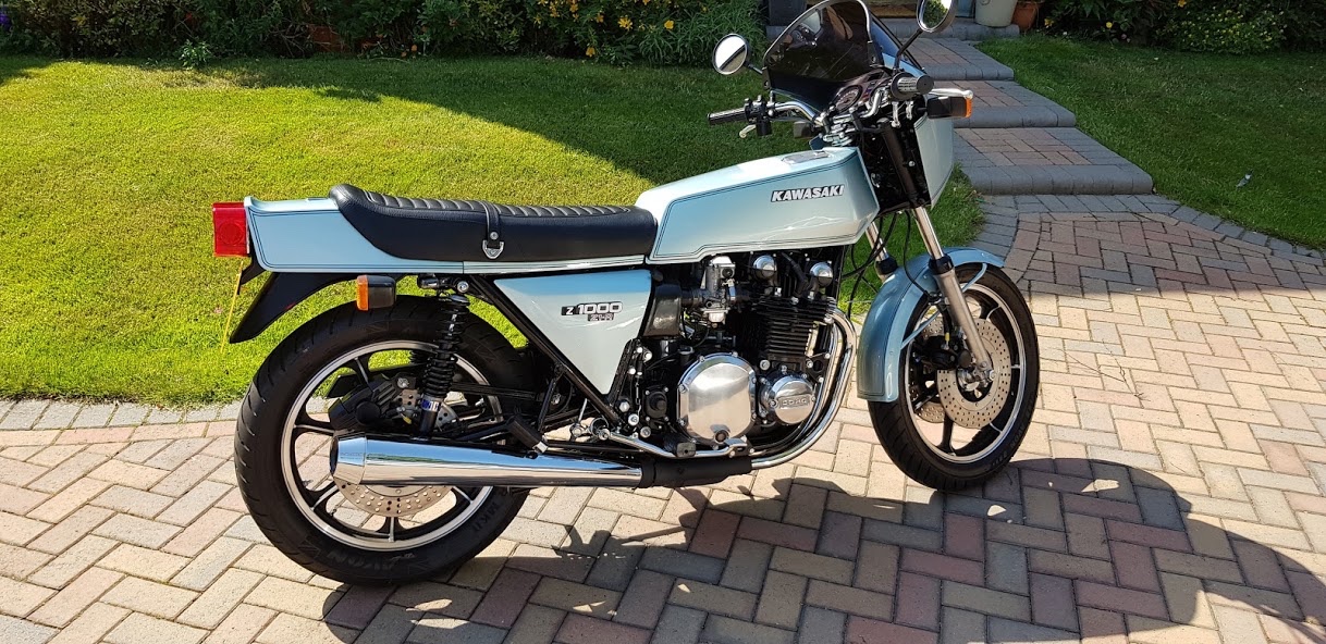

Very nice job, well done :up

That's lovely, well done. I completed a Z1R this summer and it's identical to yours. Only thing I've got to sort is the self cancelling indicators.....maybe !

wheelysteve wrote:That's lovely, well done. I completed a Z1R this summer and it's identical to yours. Only thing I've got to sort is the self cancelling indicators.....maybe !
Looks the bollox mate and is a real credit to you - well done to you too! :up :up :clap
Re: Z1R - The Work Begins!
#49 PostAuthor: Philippe » Wed Oct 14, 2020 4:03 pm
Hi bulldogbobby
congratulations! Very nice bike, she looks like new!
If all the retorations were done that way the good times would roll again!
Posts: 756
#50 PostAuthor: r3sc » Wed Oct 14, 2020 4:11 pm
That is stunning! What a machine, a true thing of beauty! Well done!

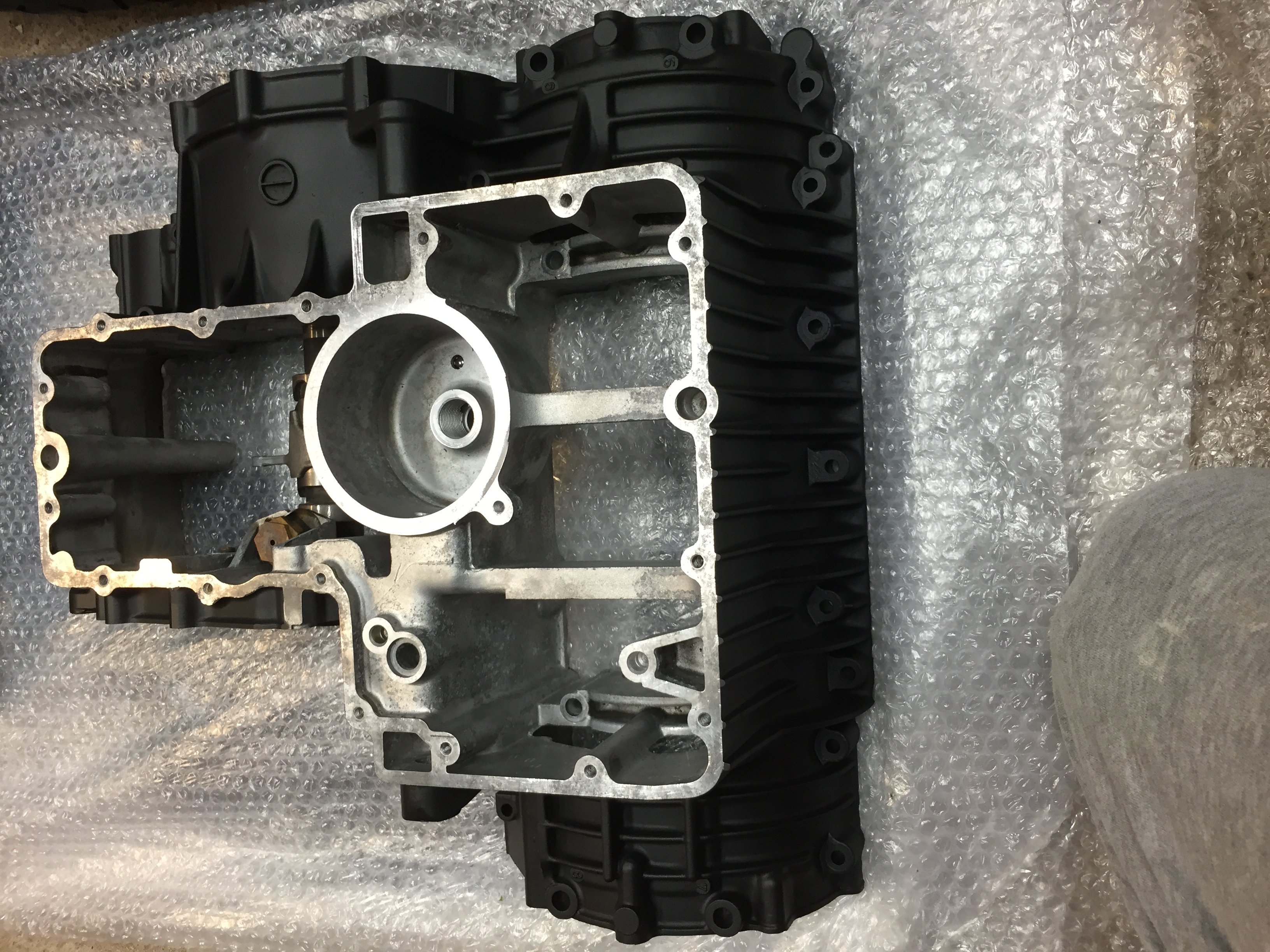

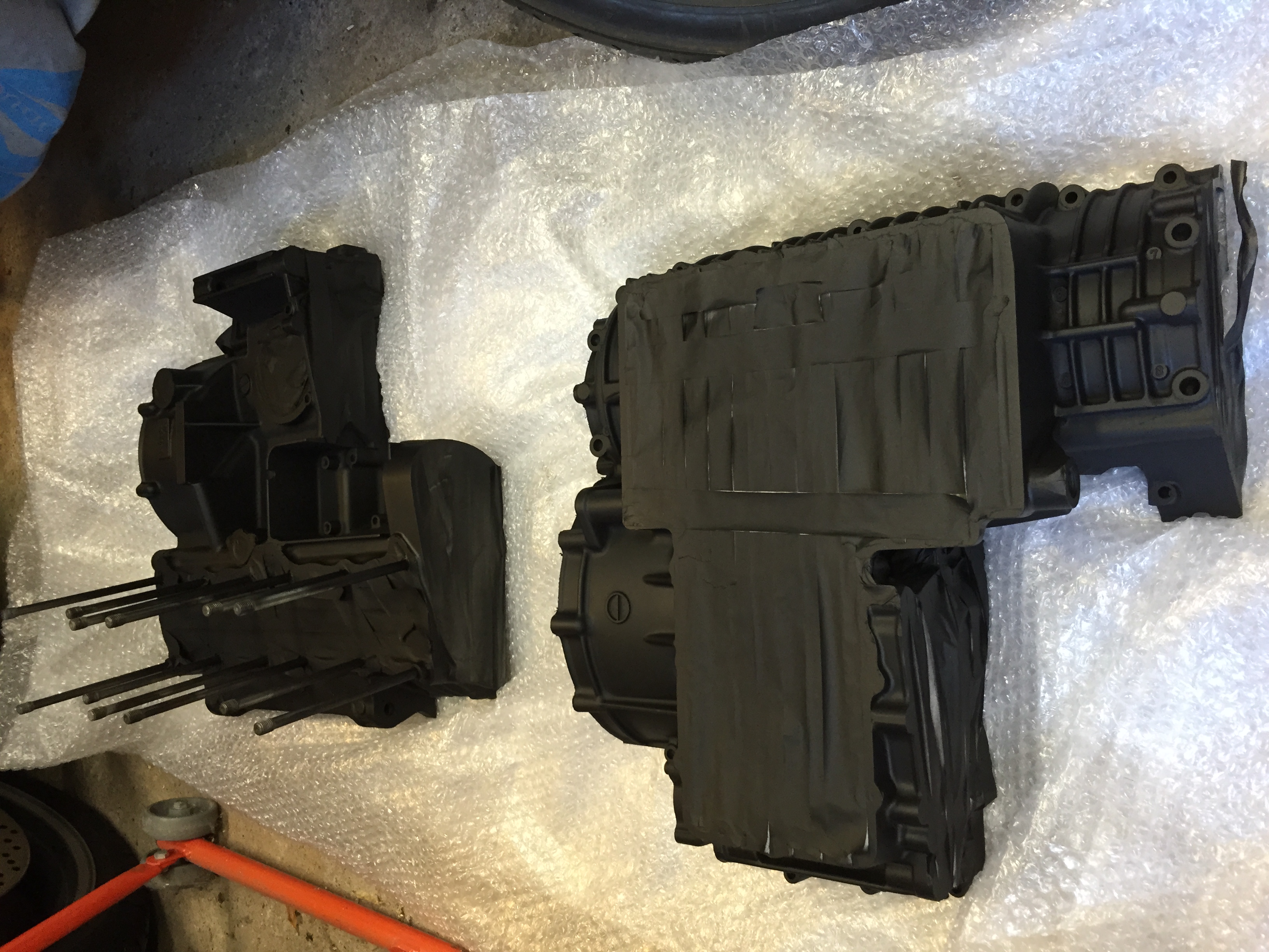

stunning well done,which engine paint did you use in the end? Any thoughts tips?
bulldogbobby
Posts: 254
Joined: 19th Feb 2008
Location: Norfolk England
#52 PostAuthor: bulldogbobby » Thu Oct 15, 2020 9:30 am
weaver wrote:stunning well done, which engine paint did you use in the end? Any thoughts tips?
Thanks all the comments :up
Weaver - I used SIMONIZ Motorcycle Heat Dispersant Paint but I don't think they make it any more? (HO-SIMVHT145C). Think it's been replaced with Enamel paint (SIMVHT32C)
I cleaned everything THOROUGHLY using a combination of degreasers and an ultrasonic bath then just followed the manufacturers instructions - the only real tip I'd give regarding painting is to spend time on the prep and to make sure you wait until the missus is out before you use the oven to bake the paint............... :D
