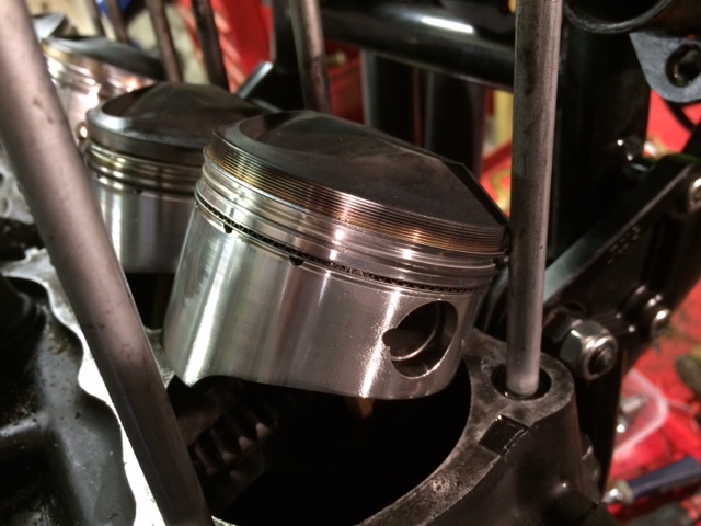

Can anyone identify the pistons ?
The numbers dont seem to be Wiseco

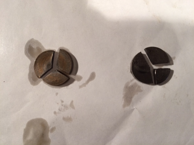

shims are under bucket on unitrack heads so it is correct
unusual to see broken shims
I had a smashed shim on a Z1 engine recently and a badly fitting bucket caused it
it would not compress when cam lobe struck it so something had to give and the shim shattered

paul doran wrote:unusual to see broken shims
I read somewhere (maybe on this forum?) that some people ground old shims down to a smaller size rather than buying new ones, and this was likely to effect their "hardness" and cause them to break.
Could be the cause, or an old wive's tale?!

Just a thought ..... have they used the correct valve spring retainers for the shim under bucket ?
I believe they are different to the shim over bucket ones and maybe that broke the shims
I will stand corrected if that is not the case that they are different
