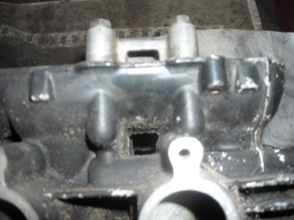

as promised, some pictures of the dirty, dusty '72 Z1 head with the original colour on.
I think that the paint is black, I rubbed the dirt and grease off at one spot.
As you can see the intakes for the vacuum meters are in the head itself, it's not the first model Kawasaki used, after approximately engine number 2200 they changed the intakes for the vacuum meters to the carb holder rubbers.

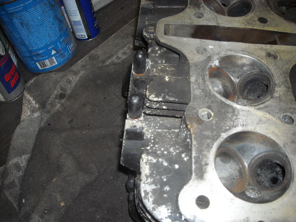

Here you can see the original paint, it's at the backside of the head.
As far as experimenting with paint by KHI is concerned: everything is possible !
I think the frenchies repainted the head, and when you remove the valve buckets you could find TWO shims on one bucket. It happened to me before! A 0,05 mm shim under a 2,15 mm shim. I gues they were short on 2,2 mm shims...

I buffed some of the fins back with a dry rag and it did reveal a more black finish so it has oxidied , but incredibly evenly - so it must have been the heat as the crankcase black is still black, even though the texture of the fin makes it look different - so good news for me that Im wrong (again) and I can paint everything black

go for it! Use good, heat resistant, satin black paint and she'll be beautifull again!
