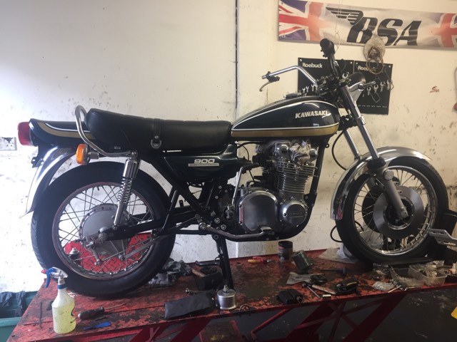

#33 PostAuthor: chrisw1 » Thu Feb 01, 2018 7:11 pm
Couldn't help trying the bodywork on ........it was too tempting :)

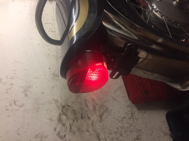

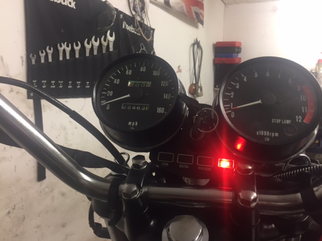

#35 PostAuthor: chrisw1 » Sat Feb 10, 2018 7:40 pm
First signs of life .....will try for a spark tomorrow :)

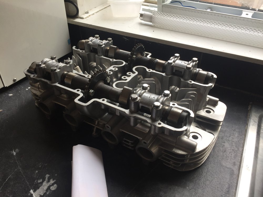

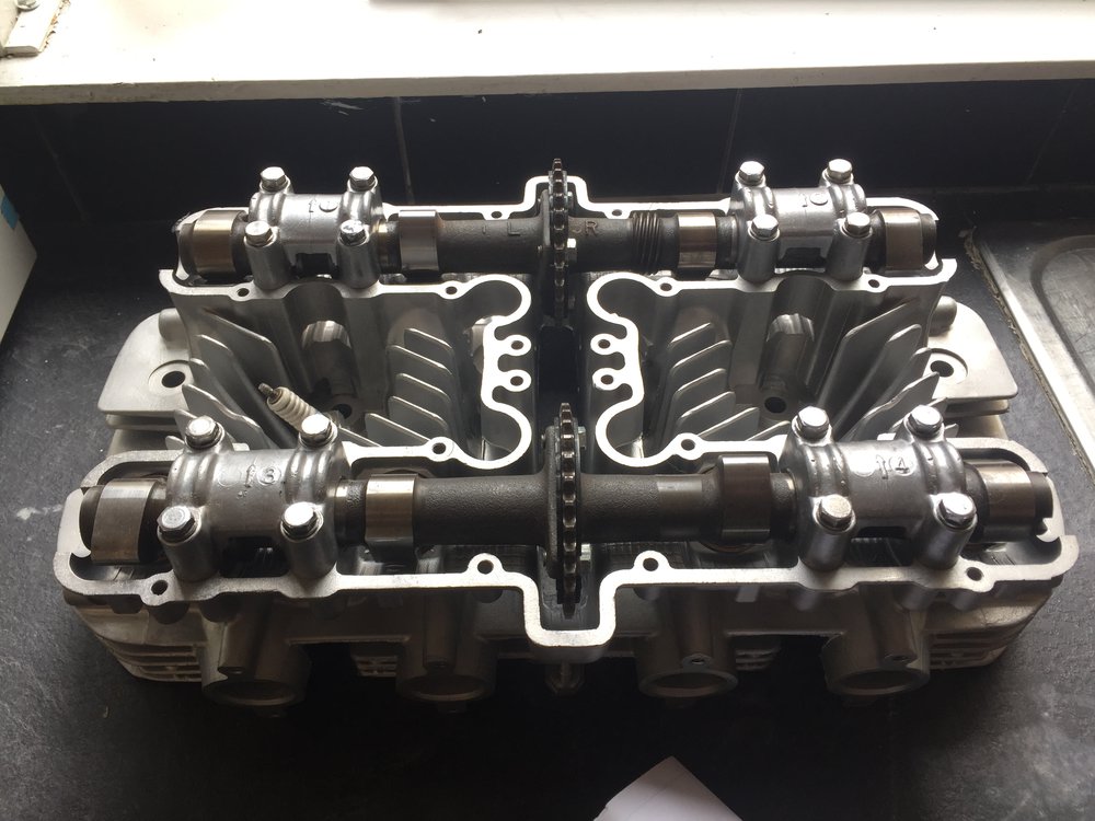

Been a while since I posted ...a leak in my bathroom and one thing lead to another and new central heating ..new bathroom ...... full house decoration etc became priority
Anyway I took a closer look at the head I was using and found the cams tight in the caps and then a crack etc etc so I started the hunt for a replacement several heads later I found one that was suitable for rebuild at zpower and dropped it off at Engine tekniks in Westhoughton ,
Picked it up this week with new guide liners or guides where needed , several new valves , seats cut and shimmed up ready to fit
Will try and get in the garage this weekend to fit it
