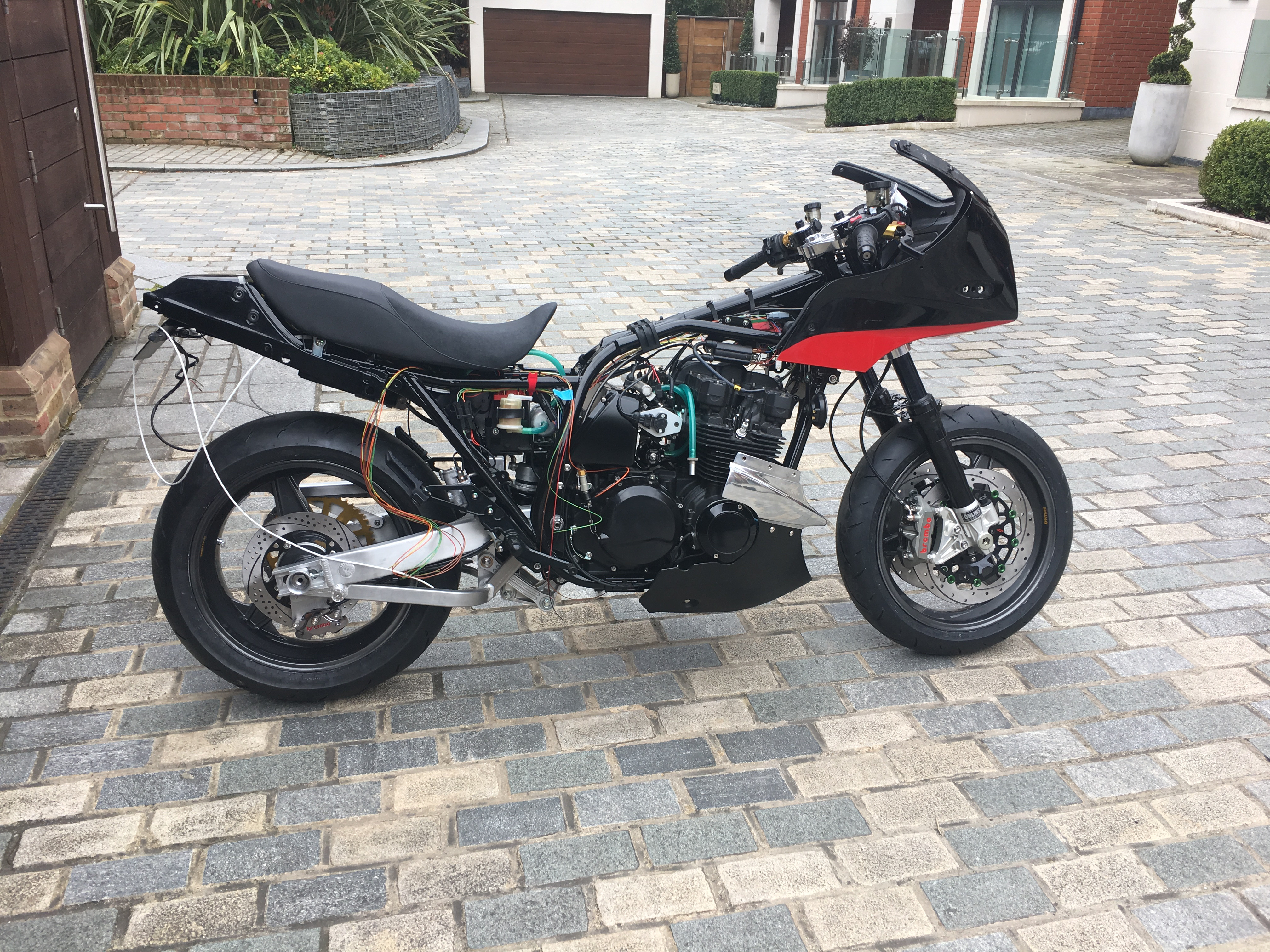

#314 PostAuthor: LondonZ1 » Tue Aug 06, 2019 3:15 pm
My 750 turbo is almost finished. The bike has an all-new fuel injection systems with a Motec ECU and it's off being mapped and getting an MOT. Almost everything else is done. There are some very minor things outstanding (a few fasteners to upgrade, a tweak for the hydraulic clutch bite point, revised battery tray) but it's 99% there. Ignore the black hoses, they are temporary fuel lines for the first start. Sorry for invading the Z1 space again but some of you seemed interested and it is a big air-cooled Kawasaki. Racefit built a lovely 1-off inconel/titanium exhaust and Flying Tiger did a stunning job on the paint. When it's actually on the road I plan to take it back to Harris and get it weighed. I am hoping for 130-140bhp and about 20kg less than standard, mainly from the suspension and wheels. I think the original wheels were made out of cast iron. My plan is to use tis bike, not sell it, so hopefully I will see some of you at future events.
