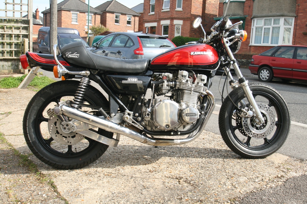

I have a spare Marving 4 - 1 you can have £100 ? May need to see how the rear mount fits though, before buying ?
Rear mounting bracket needs rechroming, and where downpipes meet needs a repaint.
picture with exhaust fitted.

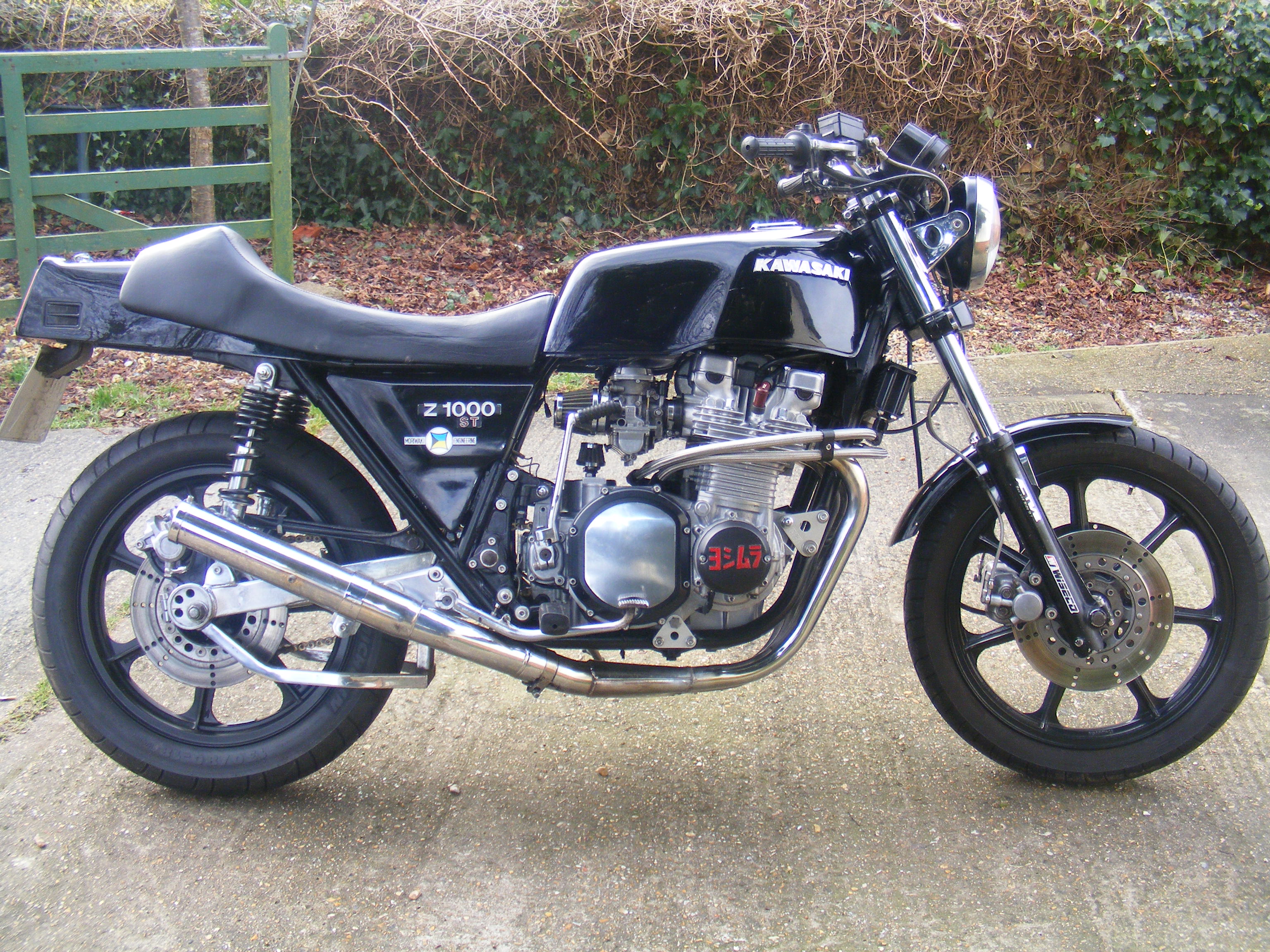

Merry xmas all ,since my last post have only covered 200 odd miles.Thanks to Adrian H who kindly offered me a nice condition Marving pipe ,managed to make it fit and looks much tidier than my old harris! Need to sort a proper hanging bracket at present it fouls the rear footrest so have had to remove it for now.

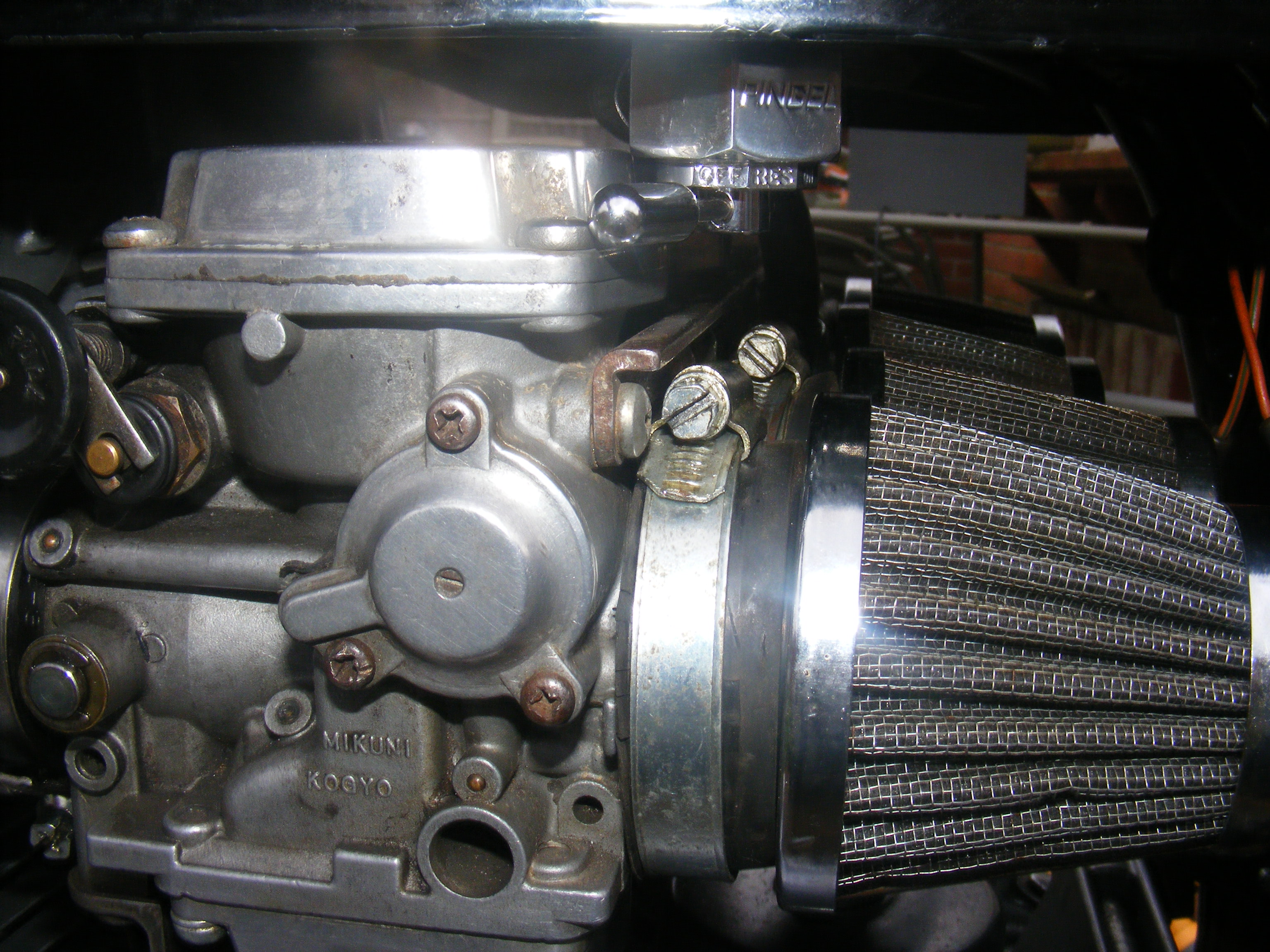

took this pic today after a run down to Bournemouth to visit a mate ,have also fitted a Pingel fuel tap now ,my standard one fouled the bigger cv carbs also it seems the bike is running lean at higher revs ,Debbens advised trying the tap which would flow more fuel..roads weren't great today so was being quite careful out but did seem to be pulling better ,if it dosn't cure the problem will try bigger jets at present they are 132.5? would be interested to know what other people are using in similar carbs?thanks
..looking forward to getting out a lot more next year now all the hard work is done! cheers Stan.
