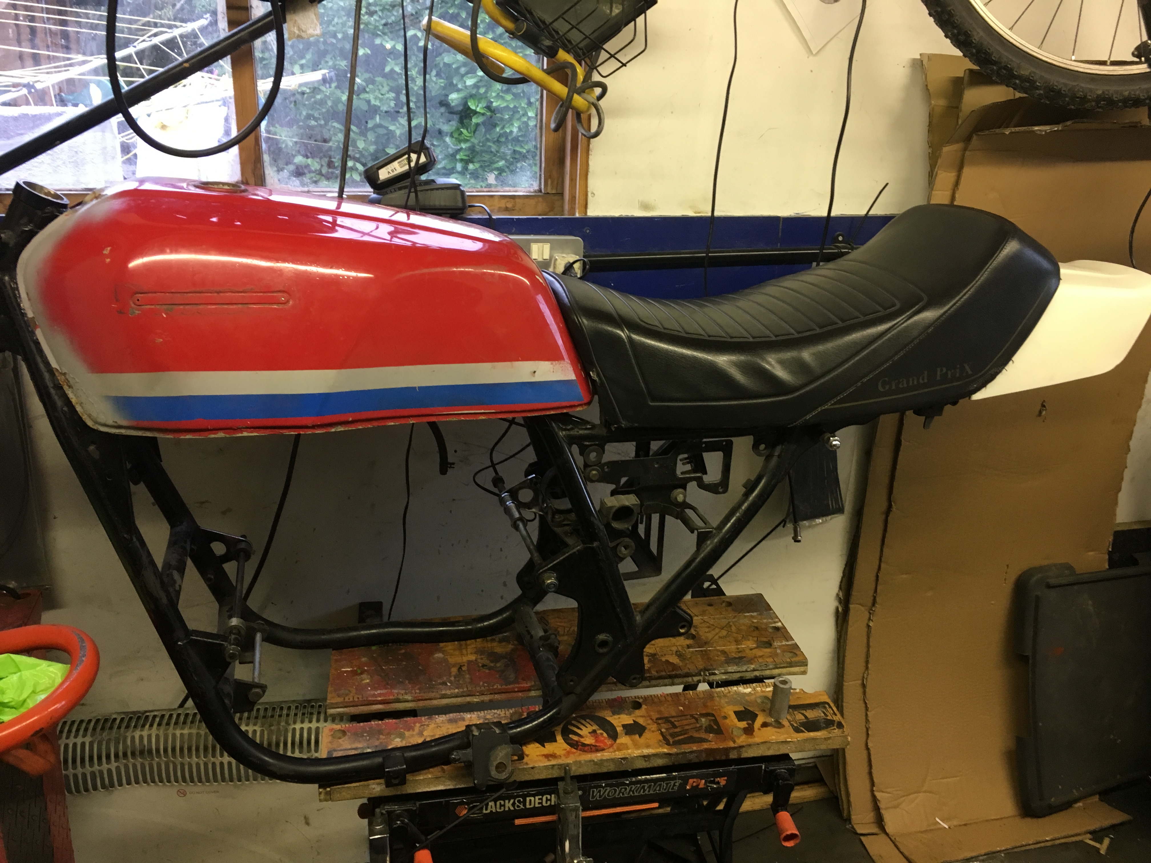

#16 PostAuthor: KWACKERZ1 » Sat Jul 08, 2017 5:47 am
seat

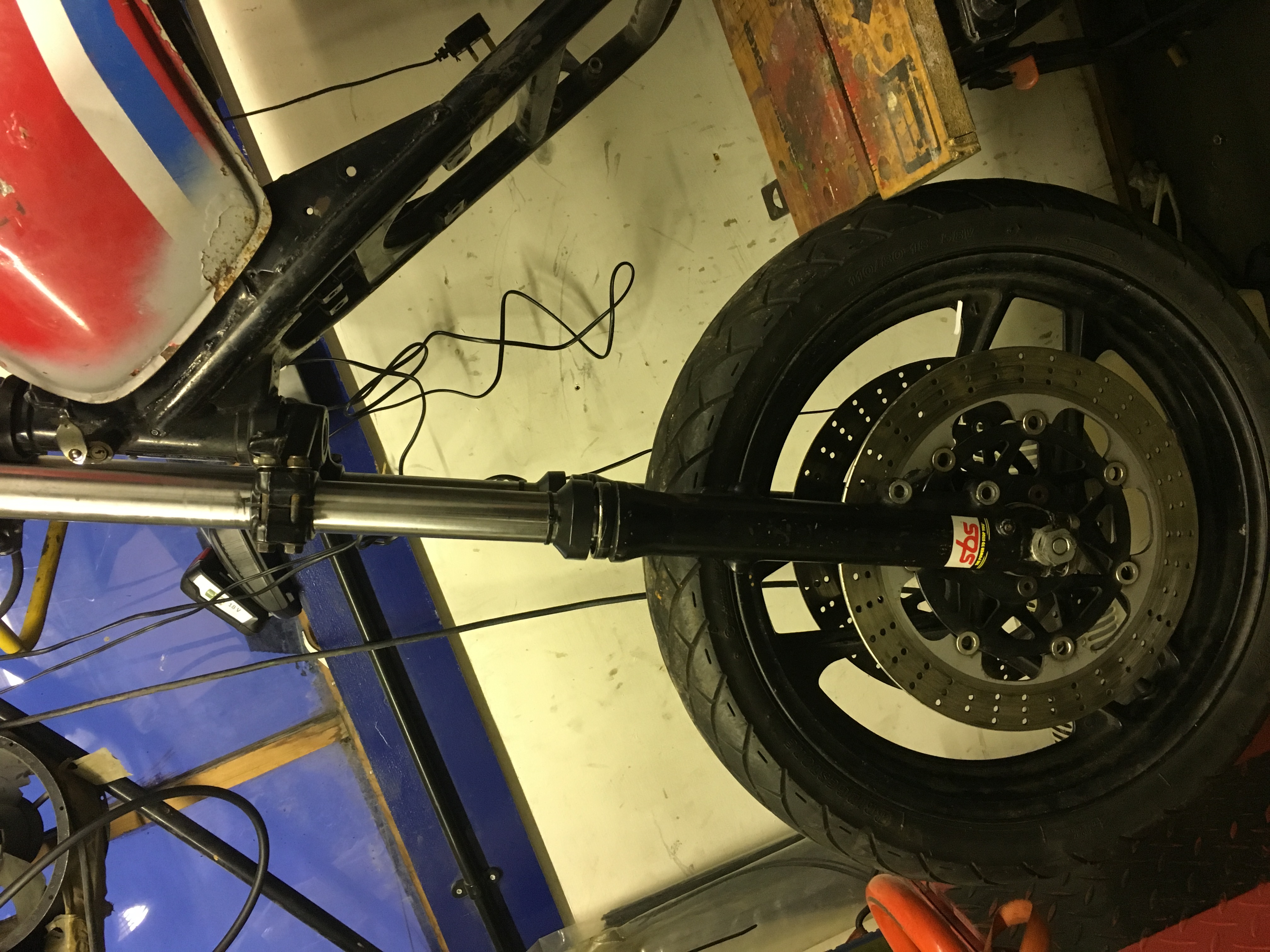

#17 PostAuthor: KWACKERZ1 » Sat Jul 08, 2017 5:49 am
tail and forks and wheel.
