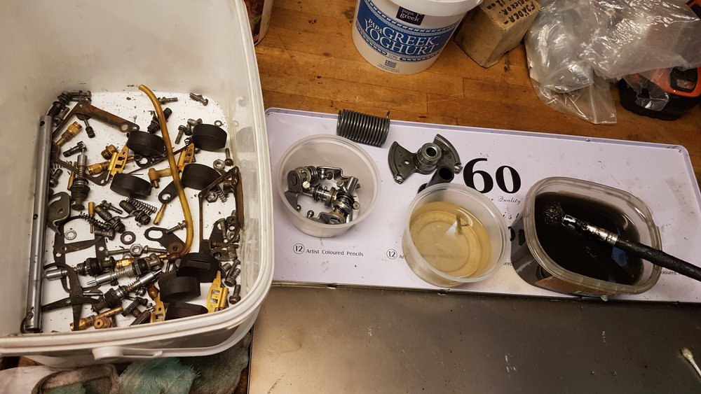

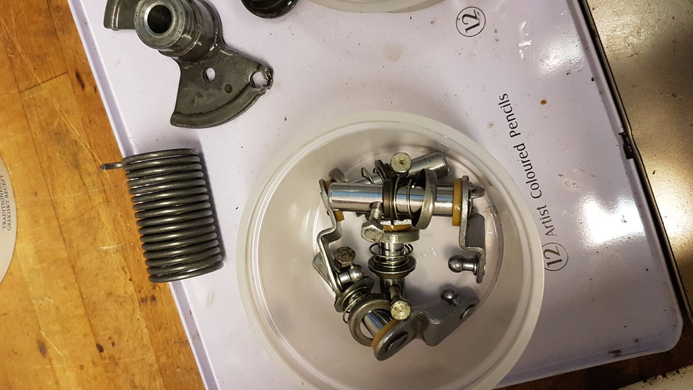

I started to clean bits to the carbs. Lots of dirt...
Parts are mostly okey, but many will need a fresh coat of zink plating.
The bike is a late 74, frame numer 33' something, meaning it has the later carbs. Not the carbs with a float with center bolt. That what z1enterprises guide said, but now I can't find the guide? There was other useful information there, anyone now what happed to their year guides?

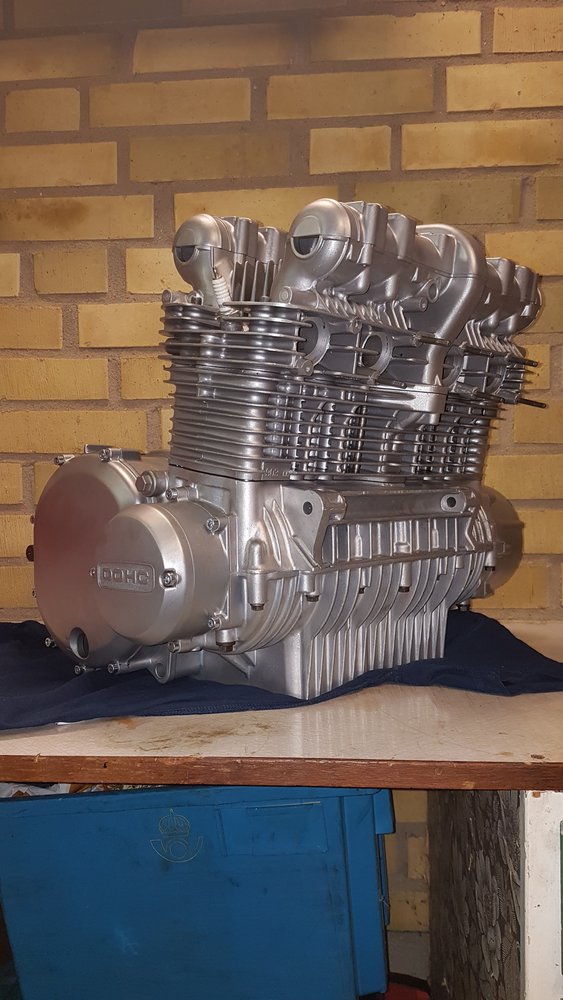

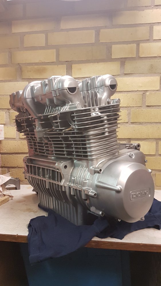

The final measurements has been taken on the engine cases and it has been dry assembled with internals to secure that the mismatched case fits. And it does. Very smooth assembly and no force needed to get the cases together. Case bolts wasn't harder on any side indicating offset either.
All case covers was mounted to secure that the sides was inline and no issues there.
I put the cylinder, cylinder head and cover in place to get a feeling for what the result is going to look like. Judge by yourself but I'm definetly satisfied. Great job from Aquanife water polishing it. If you don't want to send your parts to Denmark you could buy a complete blasting unit from him. https://www.facebook.com/AquaNife/ or http://www.notesracing.dk/.

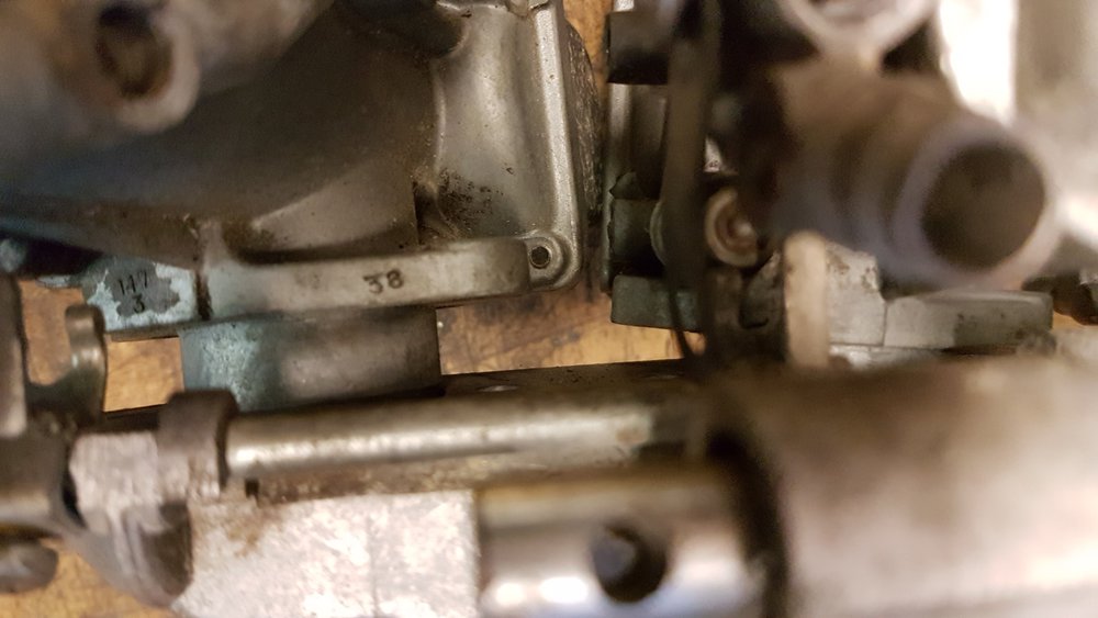

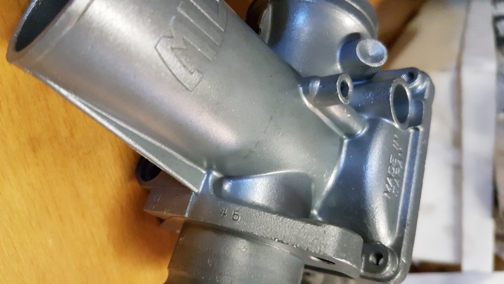

Back to the dating issue. I found another source, an ebay link. http://www.ebay.com/gds/KAWASAKI-Z1-900-CARBURATORS-TO-ID-CARBS-/10000000007737625/g.html According to the link bikes with chassis nr higher than Z1F-32817 should have the newer kind of carbs.
I found date stamps on the carbs. 45 which would be May 1974. I compared it with a set of the older carb type I have (in pretty bad shape), stamped 38, August 1973.
My plan was to use parts from the older set to get the correct carbs going. I will need the chocke axle and chocke levers but it feels a bit sad braking a 73 carbs. Any one having carb spares or know if newer parts from a 26mm carb will fit?
