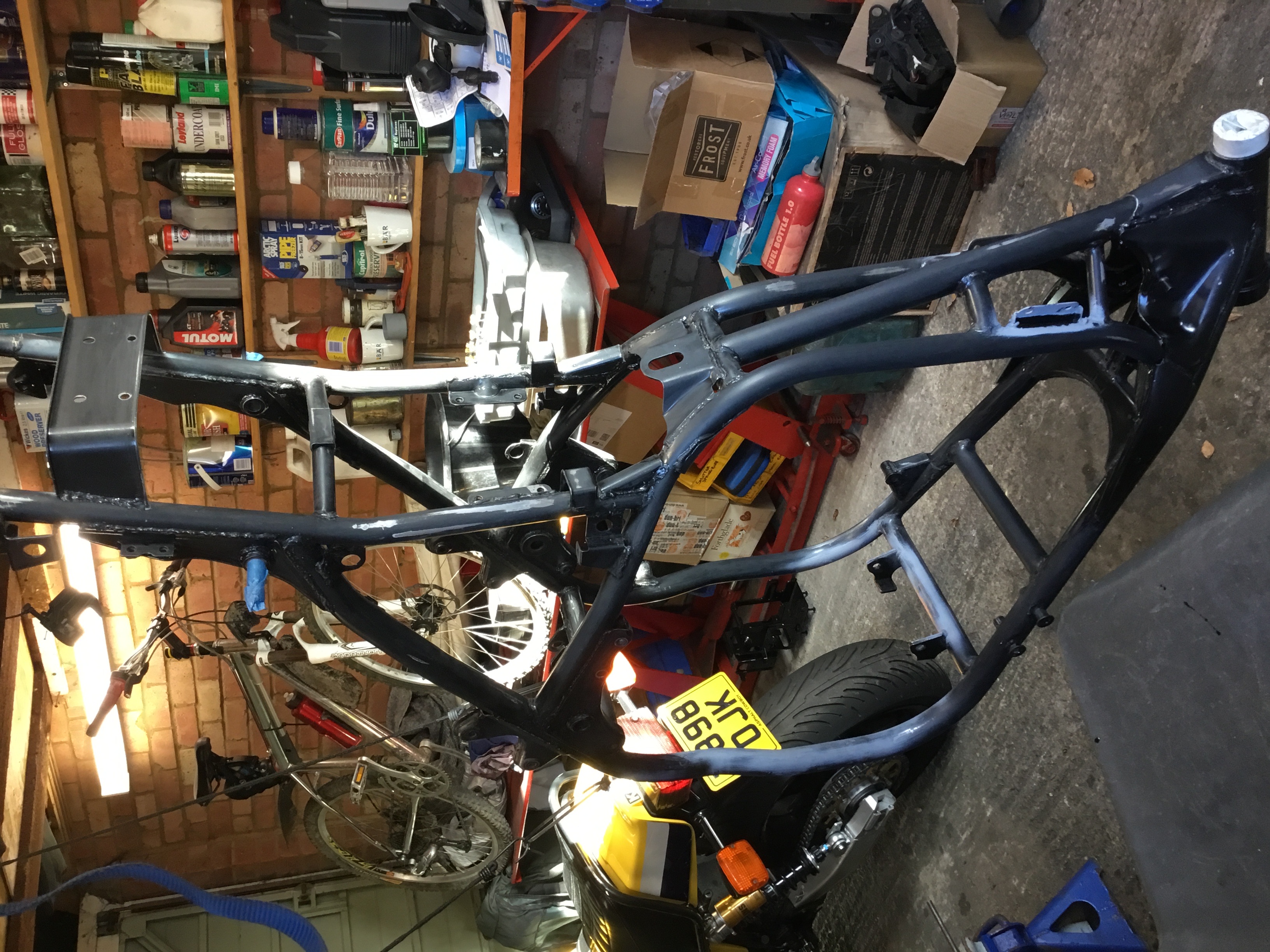

I’ve started painting some parts but need to wait a few weeks for the right atmospheric conditions to do the frame. In the meantime I’ve done the swing arm and a few ancillaries.
One thing I notice is that they must have electro static painted at the factory as the very thin coating easily covers all surfaces without this build up of crud you can see in the second picture. I will dress and brush this area once the paint is hard.

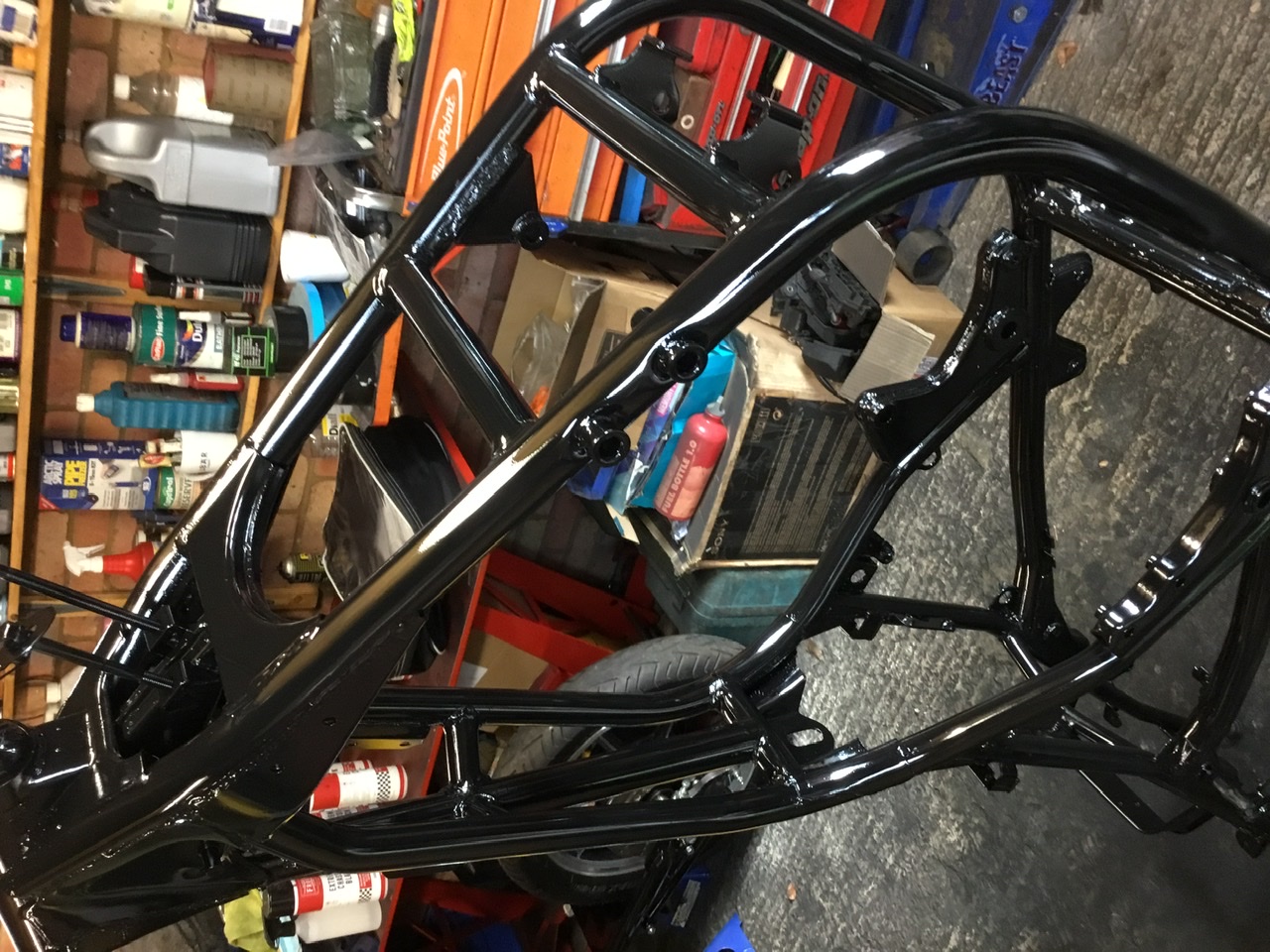

This has been a absolute marathon. On the plus side I have an acceptable finish on the frame, on the minus side I now have shares in Frosts. A rattle can job and the first I have undertaken in a very long time I have had to apply a base coat which despite my best efforts with preparation revealed many imperfections. From scrapes on the underside of the main loop, probably bad handling by me, to light damage from the chain at some point in its life. I’ve primed, base coated, rubbed down then given it two coats over the last two days. I don’t know how good the iPad photo will come out but let me know what you think.

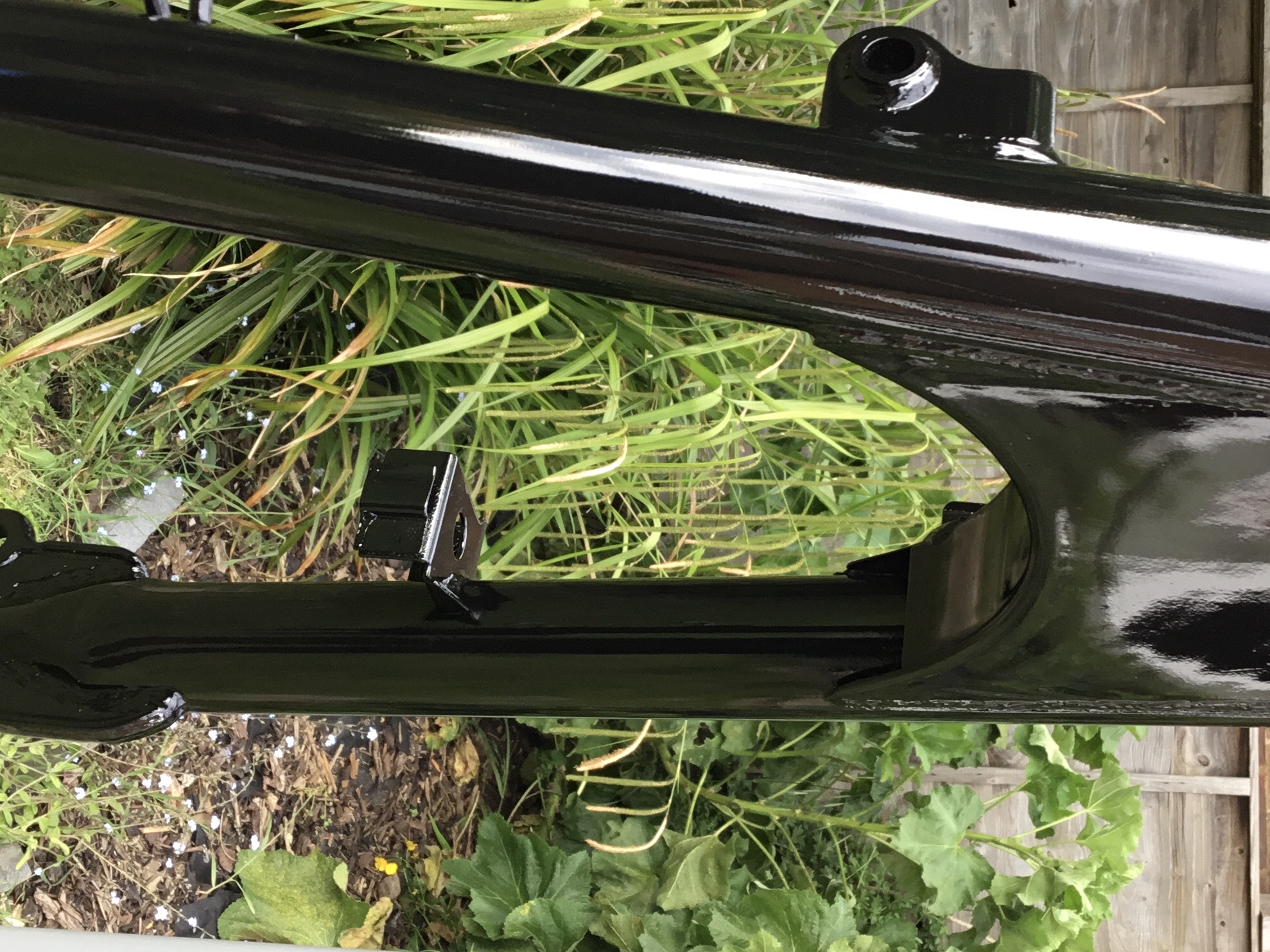

Experience with the swing arm a few weeks ago has shown me that Frosts chassis paint takes a very long, read weeks, to harden. Yes it’s dry within a couple of days but is very susceptible to marking. The plan is to leave it hanging up in the garage for at least two weeks before touching it.
Here’s the swing arm which is now fully hard and I will say I am very pleased with the end result.

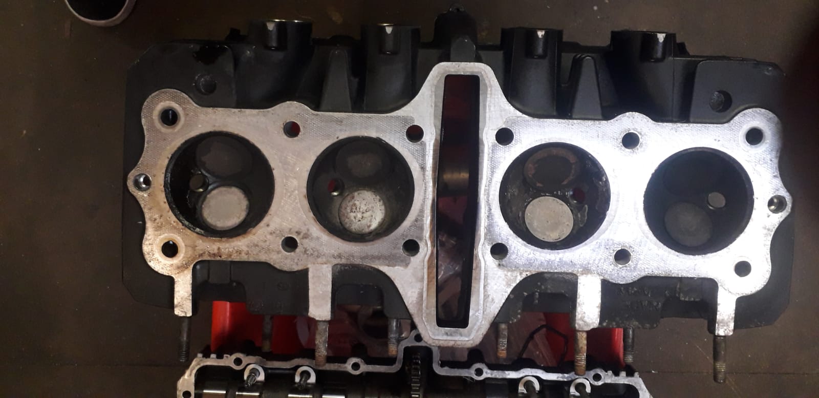

His comment on the internals were that they are among the nicest he has seen. The head has been obviously running well and he foresees no major works required. Nonetheless a full strip out and check of valve and seat wear will be carried out.

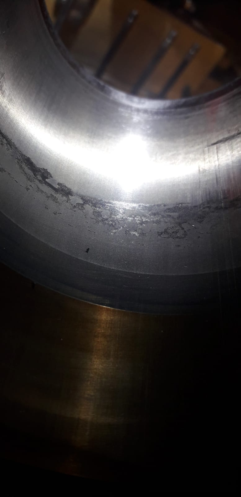

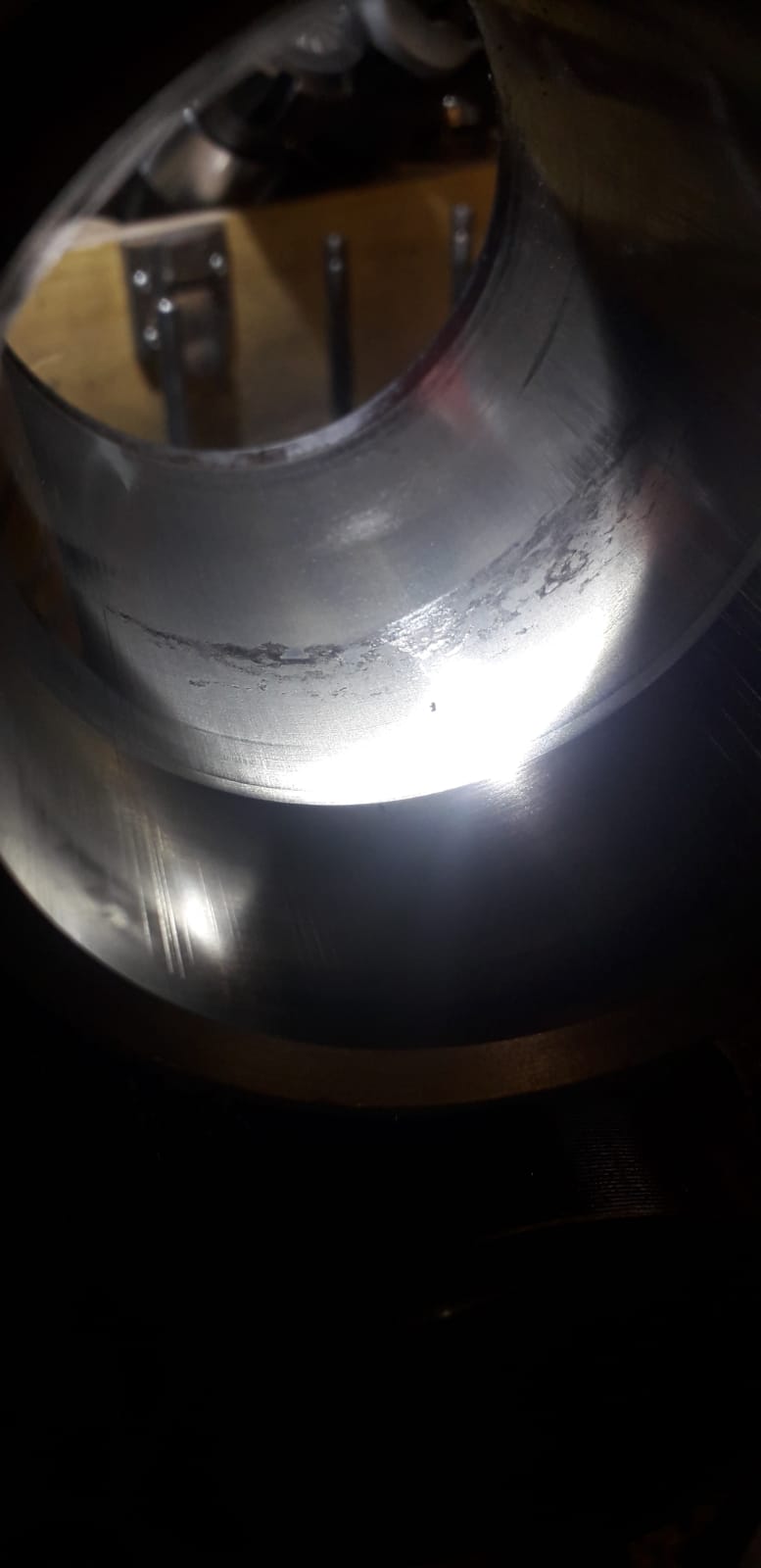

The bores though are a different matter. From my purchase of the bike in 2011 it smoked on the right hand side. I had always assumed it was due to the fact that it had been standing for 10-15 years in Madrid with the PO and as a result the valve seals had given up.
As you will see it is the bores in 3 and 4 which suffered from not moving for all that time. This will necessitate a rebore as they are too deep to hone. Non K pistons will be used at his recommendation and are 1mm oversize.
