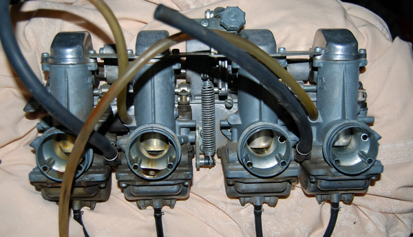

I have obtained some more carbs, these have not been ceramic cleaned and are off a running bike with a similar set up, these will be assessed over the coming months, compared to the A4 the low rpm fuelling is shite on the Ltd.
That said the jetting is pretty much spot on mid range upwards - it pulls like a train up top!

Spent a few hours cleaning out the extremely clean spare carbs, same 26's but different jets and needles.
Going to be interesting to see 'if' and how she runs.

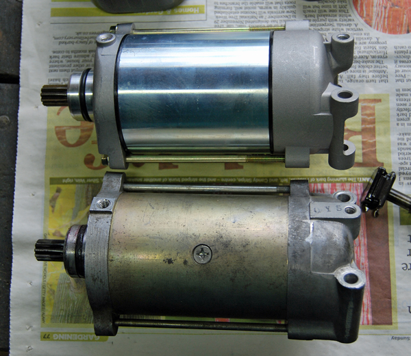

Update..

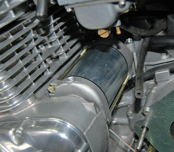

Parcel has arrived from Jeff, Motobatt and new solenoid/starter wiring ready to go..
So after getting a fair anal reaming by Customs and the Vat office - one 'Ricks' starter motor ready to fit. (original pictured bottom).
A neat and tidy installation, the mounting is identical.
The wiring connection is at the other end of the starter, the same as the later 4 brush starters.
First test was with the original starter but with the Motobatt - although it turned over a touch faster when the motor was cold - it still struggled to start when hot.
Second test was with the 'Ricks' starter and original battery - the torque over the original starter is immense, the motor span really fast - hot or cold - fitting just the starter would have been a right result.
Third test was with the 'Ricks' starter, Motobatt and a new shorter lead from the solenoid to the starter - we now have hyperspeed - it turns over so fast it sounds like a modern bike - now we start first time every time - if not sooner!!
I'm not easily impressed but - foo kin ell :9

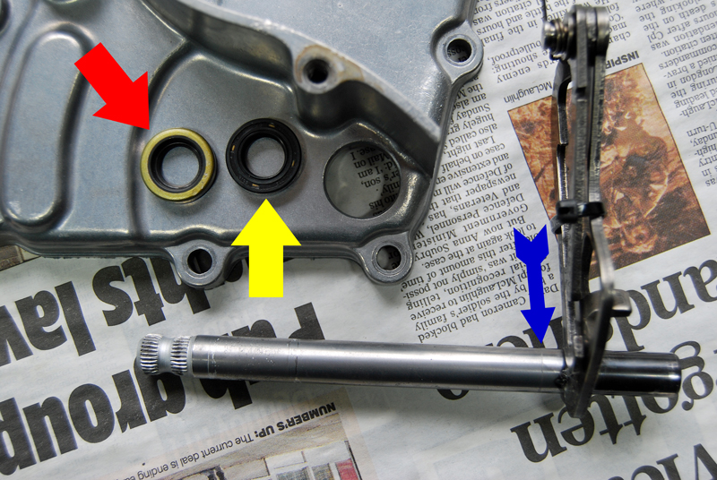

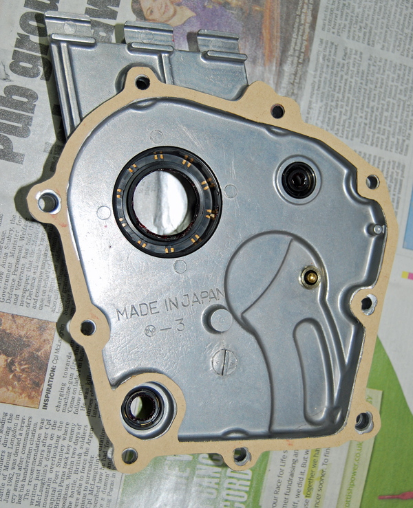

As the weekend turned out wet - I kept my limited spare time productive by addressing one of the two minor oil leaks coming from the nearside casings.
First I tackled the small weep of oil coming from the gear change shaft, nothing dramatic but the odd spot of oil makes allot of mess and is annoying.
During the original rebuild the motor was refurbished using genuine seals, so long as every shaft surface is like new - this is a good idea.
As it happens - the gear change shaft was not perfect when inspected at the time - but as a wear free replacement was not to hand - It got fitted anyway - as is my luck - sod's law dictates it was always going to weep!
The standard OE Kawasaki seal (indicated Red) is an old fashioned single edged seal, this lined up with the shallow wear groove (indicated blue) running round the shaft - which caused the weep.
The modern replacement seal I chose to use (indicated yellow) is a twin edge seal, It has the same 5mm thickness, 12mm inner diameter, 20mm outer diameter, with garter spring - and is somewhat cheaper than the factory original at £1.50! each - 85p each if bought in 10's!
I got mine from a local bearing/seal supplier, they are available from almost any similar stockist.
So as to make both seal edges sit on clean part of the shaft - I measured the location of the wear groove and set the seal either side of it - as it turned out it was a flush fit with the outside of the casting instead of the inside as previous, as the outside second seal won't get lubed much I lubed it with rubber grease.
I made a temporary gasket for testing purposes - I'm no skinflint but genuine ones are expensive and the original stuck to both the casting and case like wet sh*t to a blanket!
The gear change shaft seal can be seen protruding 0.5mm on the inside of the casting - this causes no clearance issues.
I'm going to run it like this for a thousand miles or so to see how it goes before replacing the gasket with an original.

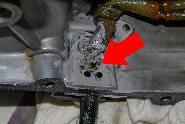

Next.... the dreaded wicking of oil through the wires from the generator cover.
I've tackled this leak before - but it's back.....
Hinckley
Posts: 255
Joined: 21st Jun 2012
Location: UK
#7 PostAuthor: Hinckley » Mon Feb 08, 2016 12:03 pm
Update.
The double edge seal on the gear selection shaft has done the trick, no weeping so far.
Result!

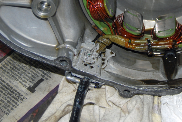

The weeping generator cover has proven a touch frustrating!
As said I've tackled this before - I'm going for shares in new gaskets.....
The Wurth sealant is suitable for use in oil, it showed no sign of failure and was certainly hard to remove.
I'd used this sealant as the original silicone sealant I'd used was not stuck to the casing when I dismantled it last time.
After cleaning It was impossible to tell where it was leaking from.
It had to come apart again for inspection.
On first appearance the gasket was a tad darker where it crossed the grommet, it appeared to be weeping from here.
Then it appeared to be coming down the wires themselves.
The woven cable cover is itself covered in some kind of clear sealant which does not appear to let oil through.
On closer inspection a pin hole ended up being the no1 suspect - but after filling with oil it was not the culprit.
Somehow it must be wicking it's way out down the cable - so a new grommet and a re-wire with modern cable is next.
More to follow on this.....

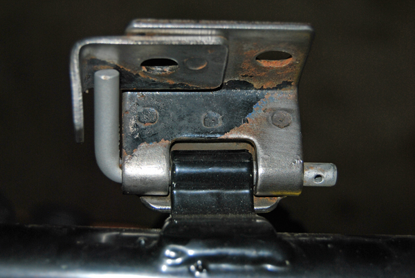

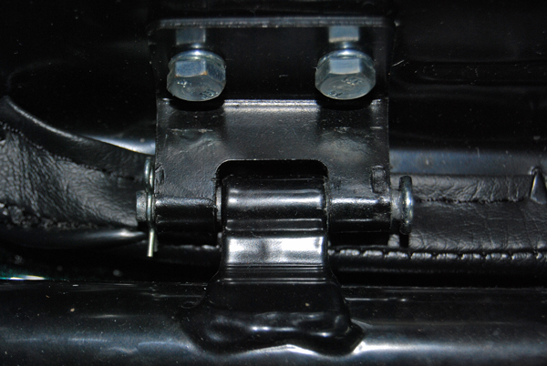

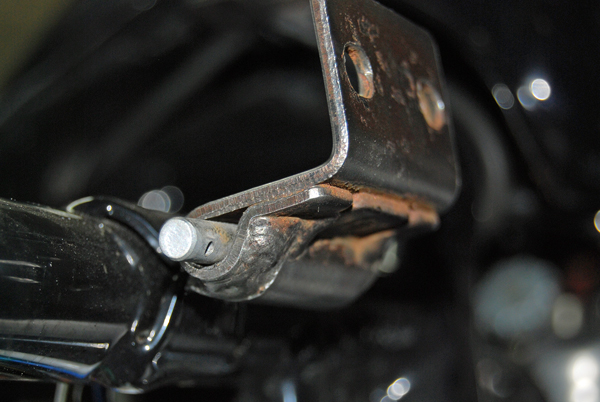

Next on the agenda was to tackle the "Saddle resting on the Side Panel" issue.
It was puzzling me why it was doing this, all became clear when Taffus found the answer in his Z900 thread - http://www.z1ownersclub.co.uk/forum/vie ... at+stopper
Discontinued item 53009-032 is the answer - or a bit of metal and a welder....
During the resto I'd replaced the saddle with a new one.
I'd discarded the old saddle to storage without looking at the original hinges.
Not looking at the old hinges meant I didn't know the new ones did not have the stopper.
I'd wondered what the side bracket was for on the brackets shown in Taffus's thread.
I dug out the rusty old hinges and had a play.
Both had the original L shaped retainer pins, both had the side brackets, the front hinge also had the stopper welded on.
With the L shaped pins in place I found they had marked the side bracket in previous use - I think I sussed it.
And of course with the stopper - it stops the seat before it leans on the side panel - simples.
A trip through the blaster and a coat of paint and we will be good to go.
You learn something new every day!

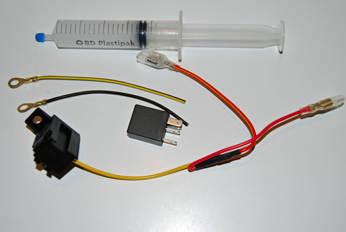

The modifications seem to progress in a haphazard fashion....

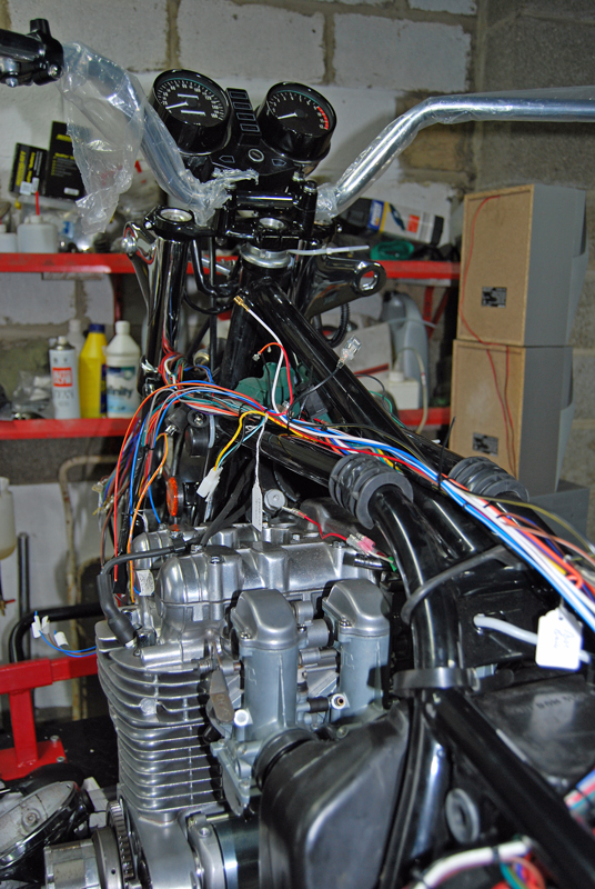

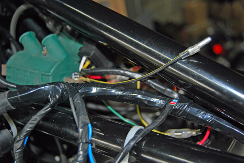

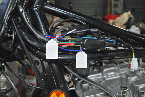

The Ltd wiring was a bit of a pain, the Ltd handlebars have the wiring running through them, the standard bars do not.
The Doremi Z1 harness I had bought for this mod was adapted to fit.
I'm using pattern switchgear to delete the hazard switch.
Reverting to chrome headlight supports will clean up the lines without ruining the Ltd look.
I knocked up a dnya coil feed mod, this time using a micro relay.
The pattern Ltd loom I'd used on the resto was suffering from corrosion of the terminals, so I now use DC4 silicone grease on all connectors, filling a small syringe made filling the connectors a bit easier.
I mounted the micro relay base on the offside coil mount.
Brake outtage sensor still fits on the nearside mount.
Just in case it helps - I ran earths from the coil mounts back to the battery, I have no idea if this will make any difference - but belt and braces and all that.....
All fits nice and neatly under the tank, the extra blue wire on the pattern switchgear will be deleted.

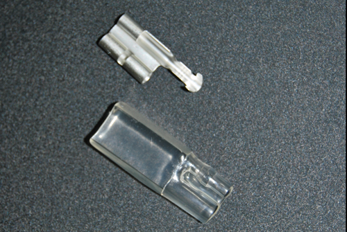

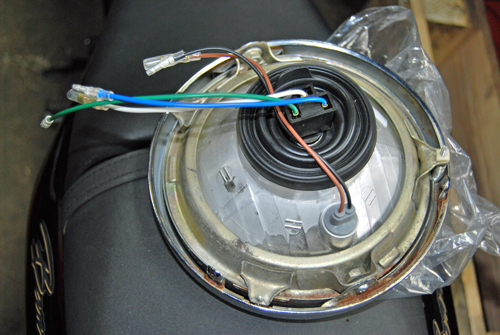

I picked up some Jap spec bullet connectors from one of the online terminal suppliers, these make adding extra earths etc, a doddle.
So the pathetic 40 year old sealed beam unit is being replaced by a nice new H4 unit from ZFever.de....
Sidelight bulb - doh! - need another earth then.....
I'd only planned for earths from the two indicators and one from the headlight.
[img]Z1000LTD_2903167.jpg[/img] Not enough available space to display pic
so I made up an adaptor lead - instead of joining the two indicator earths together - Doh!
[img]Z1000LTD_2903168.jpg[/img] Not enough available space to display pic
The beauty of modding the loom yourself - it all fits without ramming the headlight in.....
[img]Z1000LTD_2903169.jpg[/img] Not enough available space to display pic
You can never have too much chrome!!!
[img]Z1000LTD_29031610.jpg[/img] Not enough availavle space to display pic
The ZFever lamp has a flat beam pattern - and is nice and bright!
The unit ZPower supplies has the kick up for driving on the Right!!!! handy for going abroad then :smak

Gus
Posts: 1515
Joined: 17th Mar 2007
Location: Gloucestershire
#10 PostAuthor: Gus » Tue Mar 29, 2016 4:10 pm
Hinckley wrote:
Could you tell me where you got those Bad boys from?
Gus
"Set the GRINDER on it"
ADE
Posts: 311
Location: Shropshire
#11 PostAuthor: ADE » Tue Mar 29, 2016 5:25 pm
Gus
Posts: 1515
#12 PostAuthor: Gus » Tue Mar 29, 2016 5:46 pm
Hi Ade
Thanks for that.
They must have added them more recently as that's where I bought the rest of my connections and they weren't available at that time.
Gus

#14 PostAuthor: Hinckley » Tue Mar 29, 2016 8:13 pm
Sorry GUS been out - yes that's where I got them from.
Japanese bullet terminals.

#15 PostAuthor: ColSZ1B » Tue Mar 29, 2016 8:50 pm
Their terminal "kit" seems a bargain @ £23.
