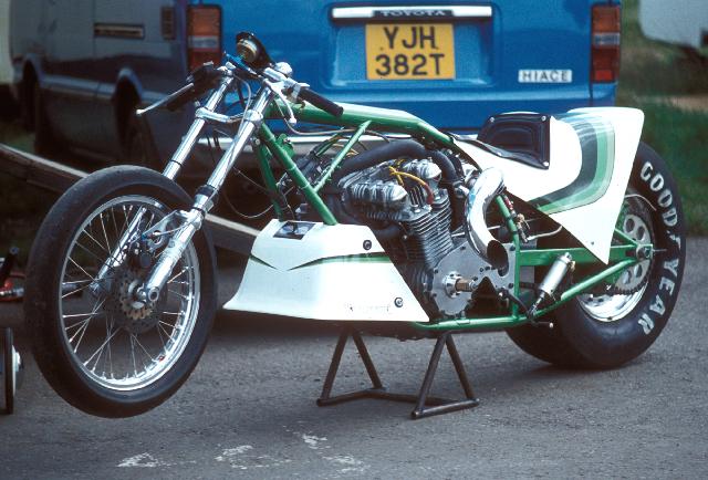

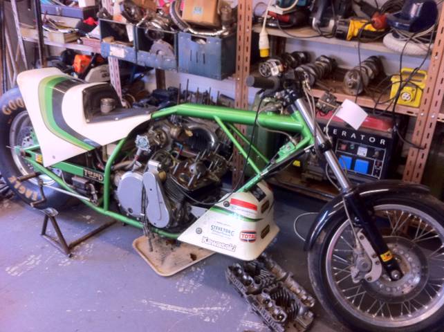

Here's a pic of the machine as it should be.
And here as it has been for nigh on 30 years since it blew over the line at long marsden

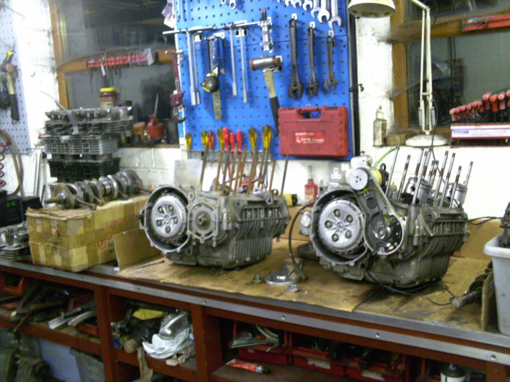

I have now got the engine and spares on the bench for inspection

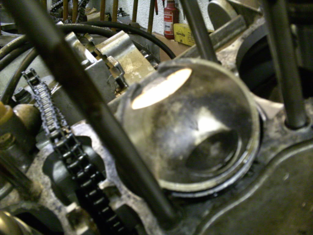

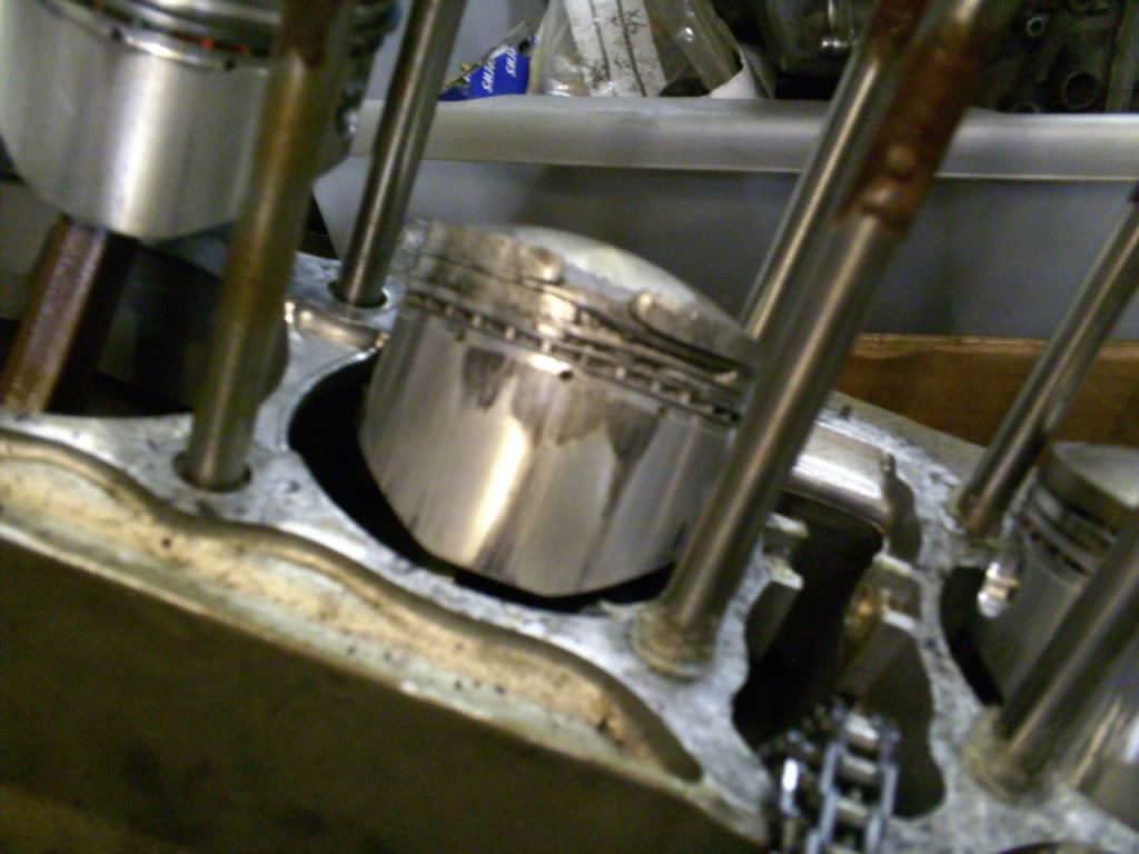

Pulling the barrels reveals the the cause of the engine failure .
Both center pistons suffering from detonation and the excesssive heat that running 30psi of boost will create.

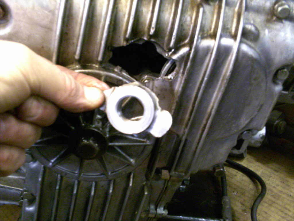

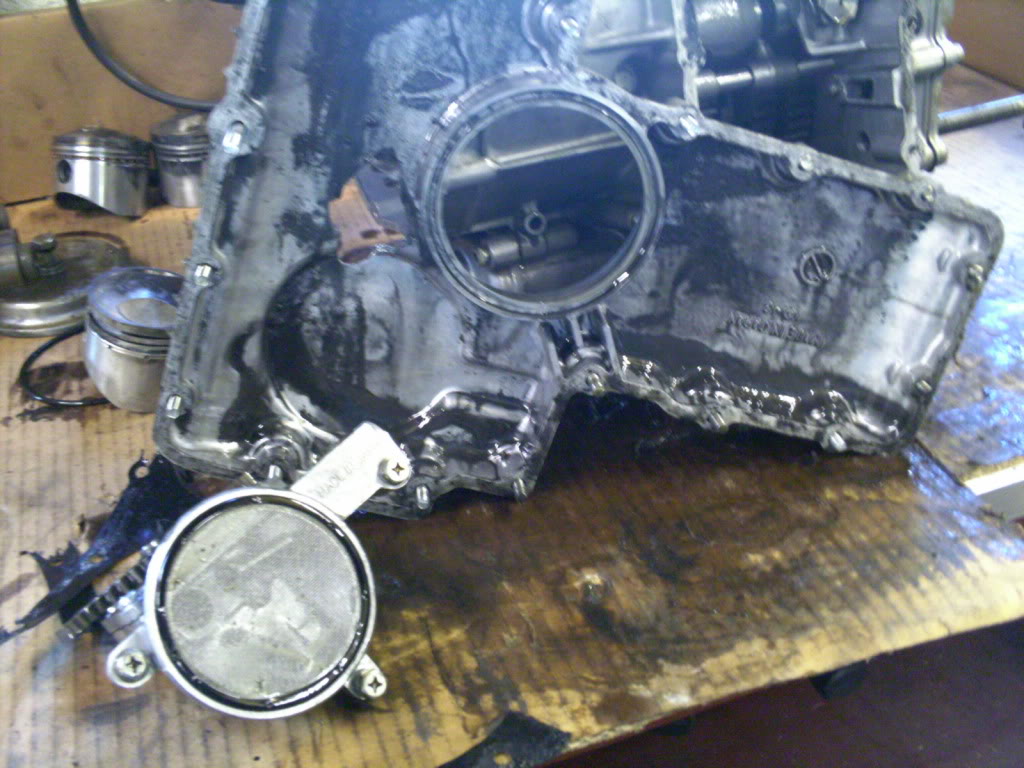

A little mystery for now is how this lump of sump got ejected from its moorings ?
Initially i thought the the camchain had snapped,wrapped around the crank and had destroyed the main bearing cap with shrapnel exiting through the sump, but a quick inspection revealed the chain is untouched and peering through the hole shows the cap intact and everything turns freely
It should all become clearer once i get the sump off

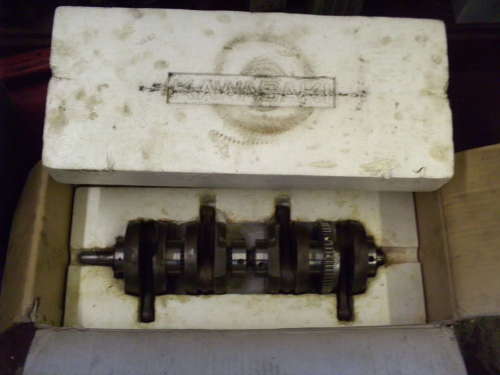

"New" welded crank from Chris Applebee still in the kawasaki box soon to be woken from it's slumber.

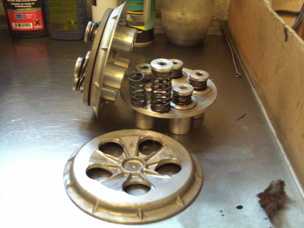

And belt and braces approach to clutch slip .

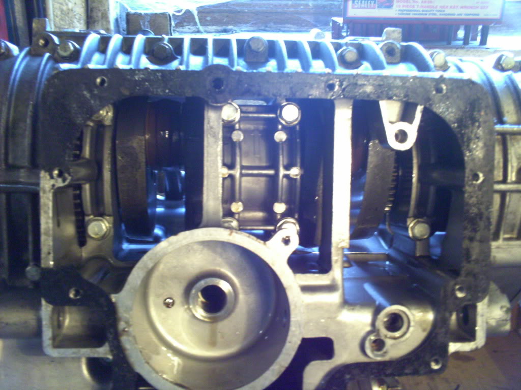

Well! i pulled the sump this morning and found nothing wrong downstairs that could cause the sump damage.
Nothing unexpected but more interestingly nothing i expected either.
Oil pump is std, no rear pick-up, not even a gate and the black sludge is only clean oil and assembly lube.
Everthing is in excellent condition so far and if you didn't know it could have come straight from the track yesterday.
Crank is just a welded std one, nowt special or lightened and no cap support or hd crankcase studs.

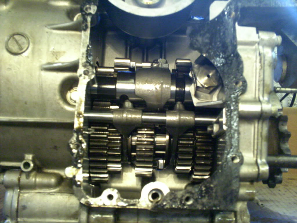

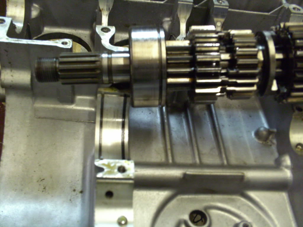

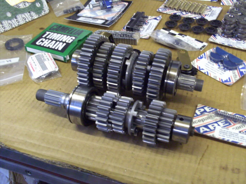

Same for the gearbox .
Apart from evidence of freehand undercutting it's std z900.

I thought the same about the sump plug when you said the camchain was intact Rob. The bike is very low, maybe it got rolled over something getting loaded into a van or over a kerb and the sump plug got hit?

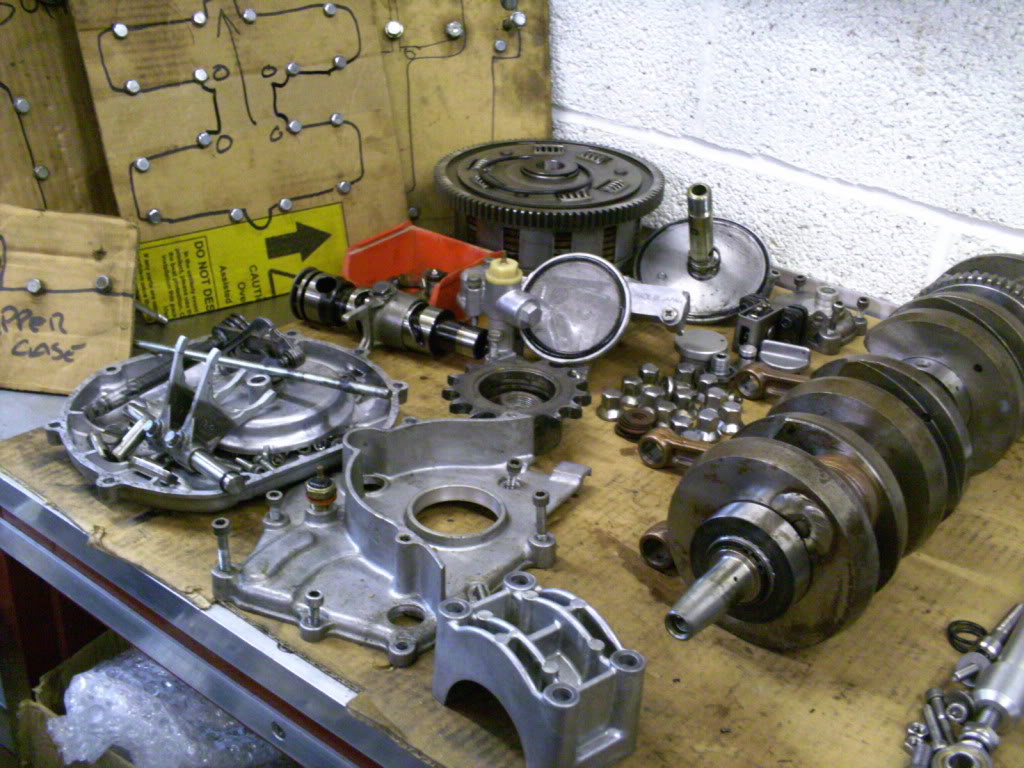

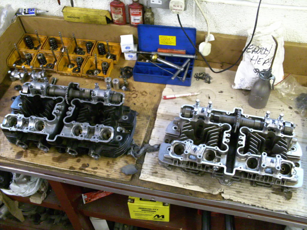

After very close inspection most of the engine parts are either worn out , unsuitable or just plain buggered and all the usable parts that don't need any major work are in this pic and are mainly from the spare engine.

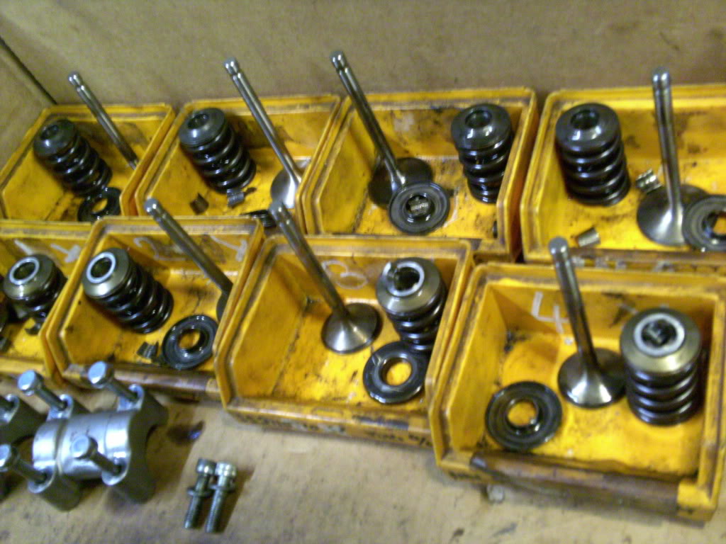

This thing is fighting me all the way and both heads need everything re-newing, the seats are pocketed and all the correct cam caps need sorting as they were all mixed up in a box with some others
Burnt valves,sagged springs,odd retainers and old style square keepers.
All this needs replacing.

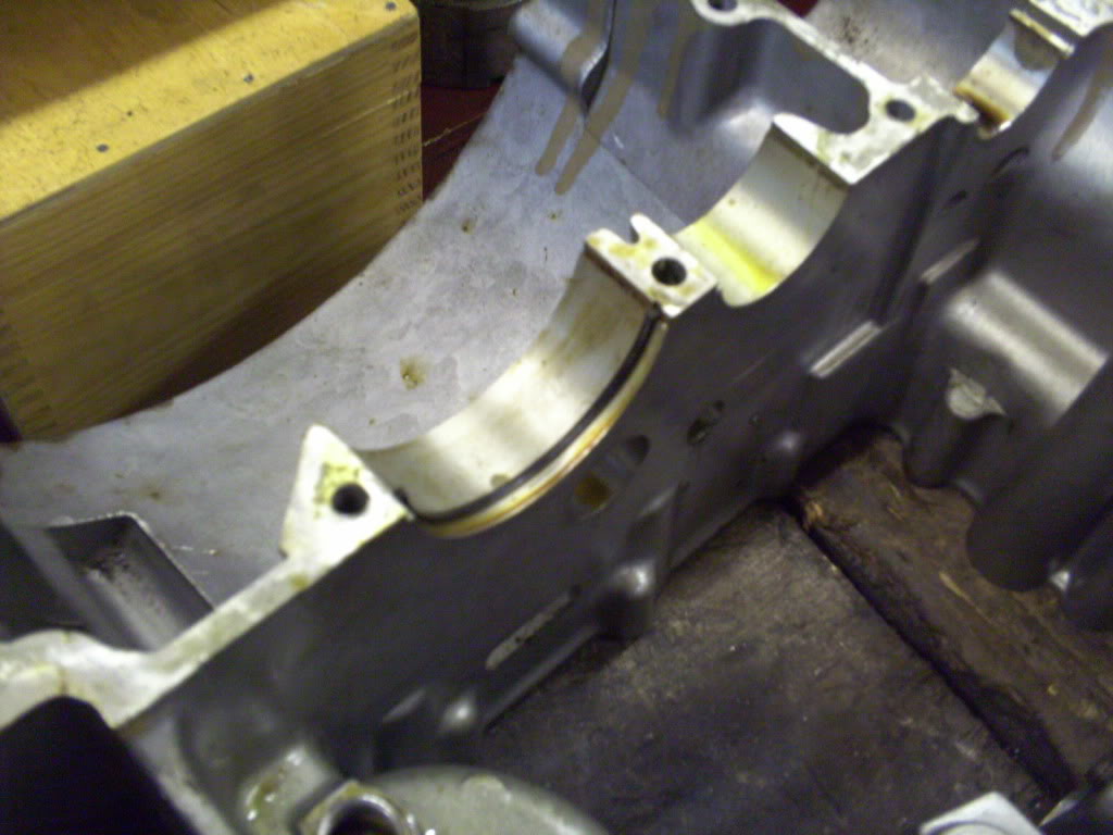

Have chose to use the spare crankcases as the others have been bored out for a big block and as a result will be more prone to flexing and will be weaker around the barrel studs.
On the upside these cases have had the groove for the bearing retainers machined on the inside of the case in BOTH case halves for a more robust construction so it's just a matter of flipping the bearing 180 deg to fit and they will also help reduce the halves moving independently
Groove in lower half which the std cases don't have.
All this means is that there are now several large boxes of tasty parts currently winging their way from Pitstop Performance in the US to help fill in the (large) gaps.
Not so much of a rebuild now ,more like start from scratch :roll:

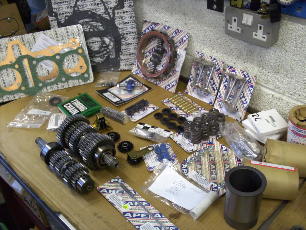

Postie finally delivered a big box of goodies from the US .
Almost every internal part is being replaced .
Even bought a complete refurbed undercut gear cluster.
It's a joke that this item shipped from the states cost nearly half the price delivered than the cheapest quote we got for labour to undercut our own.

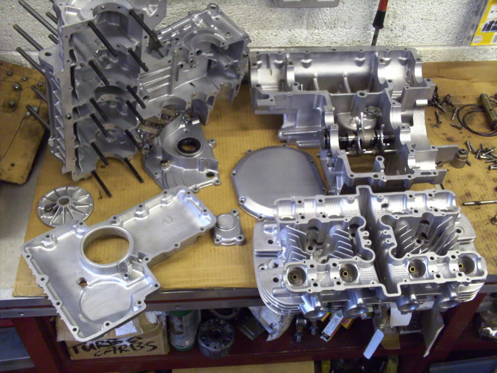

While we were waiting for the parts to arrive the cases etc have had a trip to the aqua blasters so i could make an immediate start on the re-assembly.
A few hours work saw the Oil pan gate, HD case studs, valve guides , oilseals and gear selector fitted
The barrels are now away getting bored for the 72mm MTC turbo pistons so this gives a few days to sort out the head.

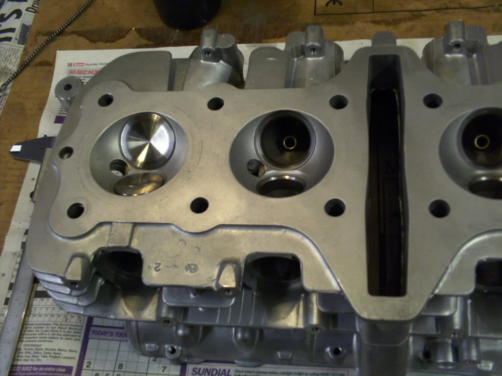

The seats were pocketed and even tipping the std size valves left no clearance with the thinnest shim so fitting oversize valves gets everything back in usable range.
Now just have to open up the throats to match and take full advantage of the larger valves.
