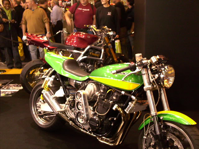

Couple of pics from the NEC.

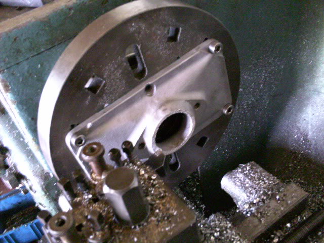

More development for the Drouin.

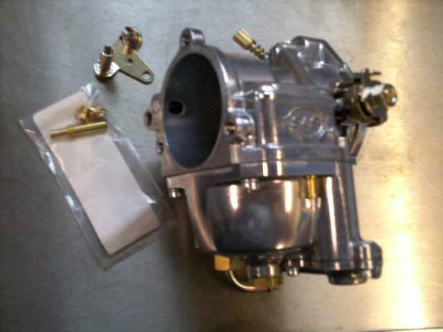

Brand spankers S&S Super 'G' shorty carb.
Just a little bit bigger than the Mr Turbo carb i had fitted :)

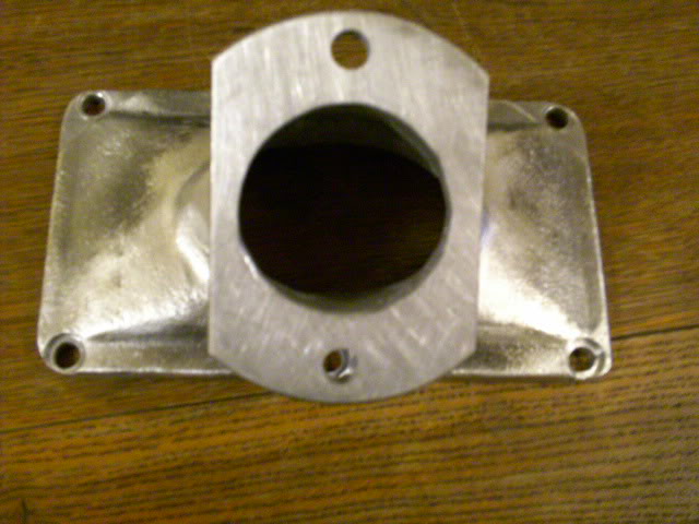

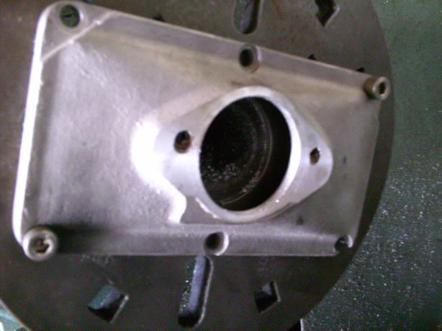

First job was to make up a new flange

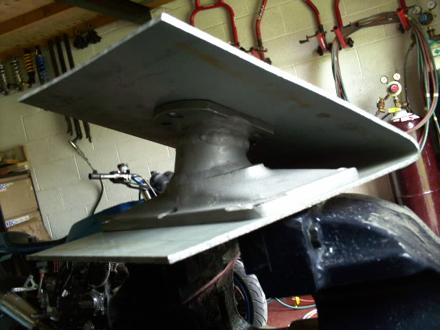

Then knock up this simple jig to keep the carb angle correct
Carb needs spacing out 20mm so that its accelerator pump doesn't foul the frame

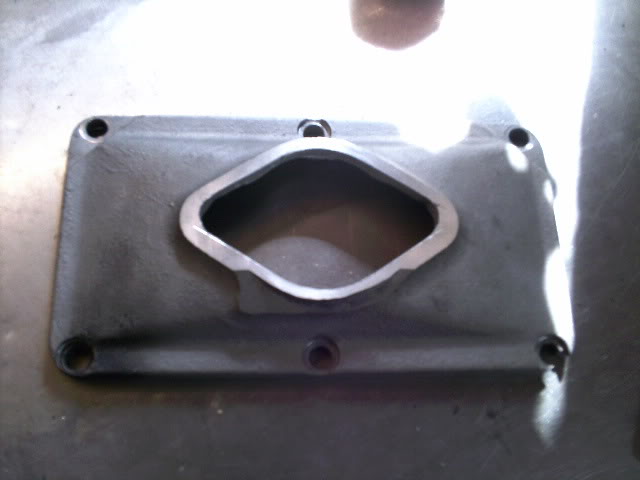

Now to chop off the old mount and face it up on the lathe
And bore a hole the same dia as the new carb

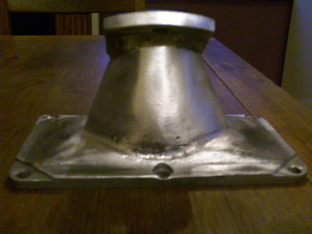

Then open up the manifold so the fuel has a less restricted run to the blower

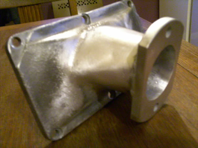

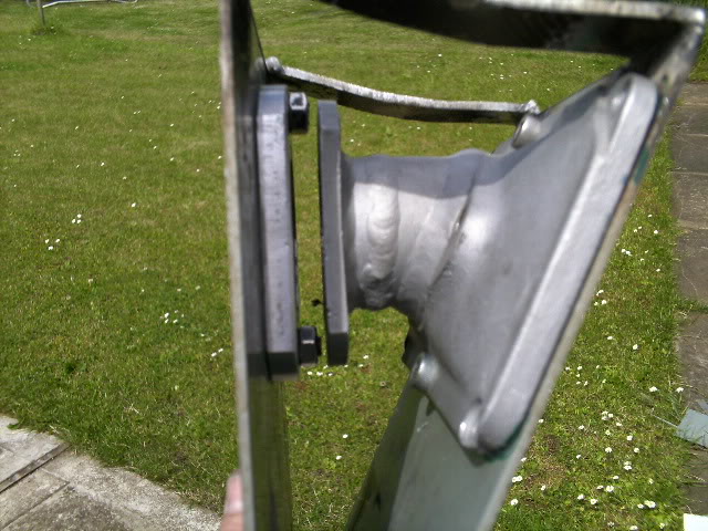

Now just got to bridge the gap
Posts: 4034
#315 PostAuthor: zed1015 » Mon Jun 27, 2011 9:21 pm
Nearly there.
Just need blasting to match the rest of the blower.
Should be able to get the carb fitted by weekend ,Then it's Play time :D ( If it ain't raining ).
