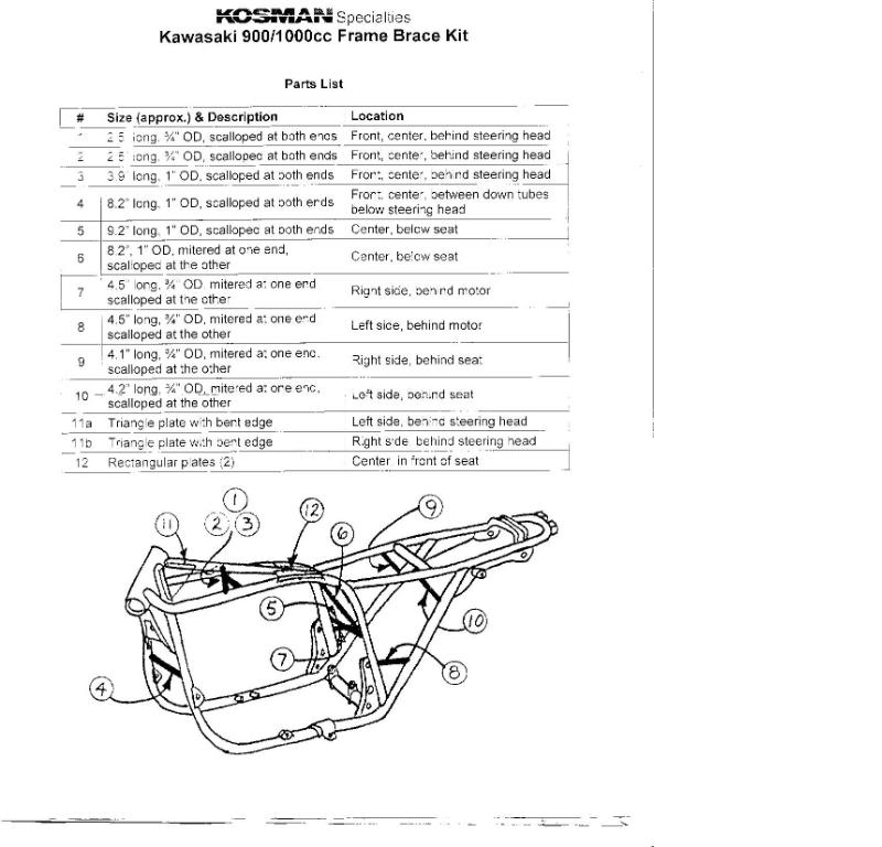

Steve I agree with you and actually agree with Jack also, as if money was no object a frame from proper metal would be my choice.
But if you need frame bracing specs and dimensions its all here.
http://www.z1ownersclub.co.uk/forum/vie ... c&start=30
As I posted it previously.

#11 PostAuthor: Swirl » Mon May 27, 2019 6:01 pm
KWACKERZ1 wrote:Steve I agree with you and actually agree with Jack also, as if money was no object a frame from proper metal would be my choice.
Kwackerz1 do you have the info where this link goes
Posts: 2926
Re: Frame Strengthening
#12 PostAuthor: Al » Mon May 27, 2019 6:10 pm
Was it this??
z Frame mods KOSMAN.png (237.6 KiB) Viewed 4812 times

#13 PostAuthor: Swirl » Mon May 27, 2019 7:09 pm
Al wrote:Was it this??
That's ace thanks Al
