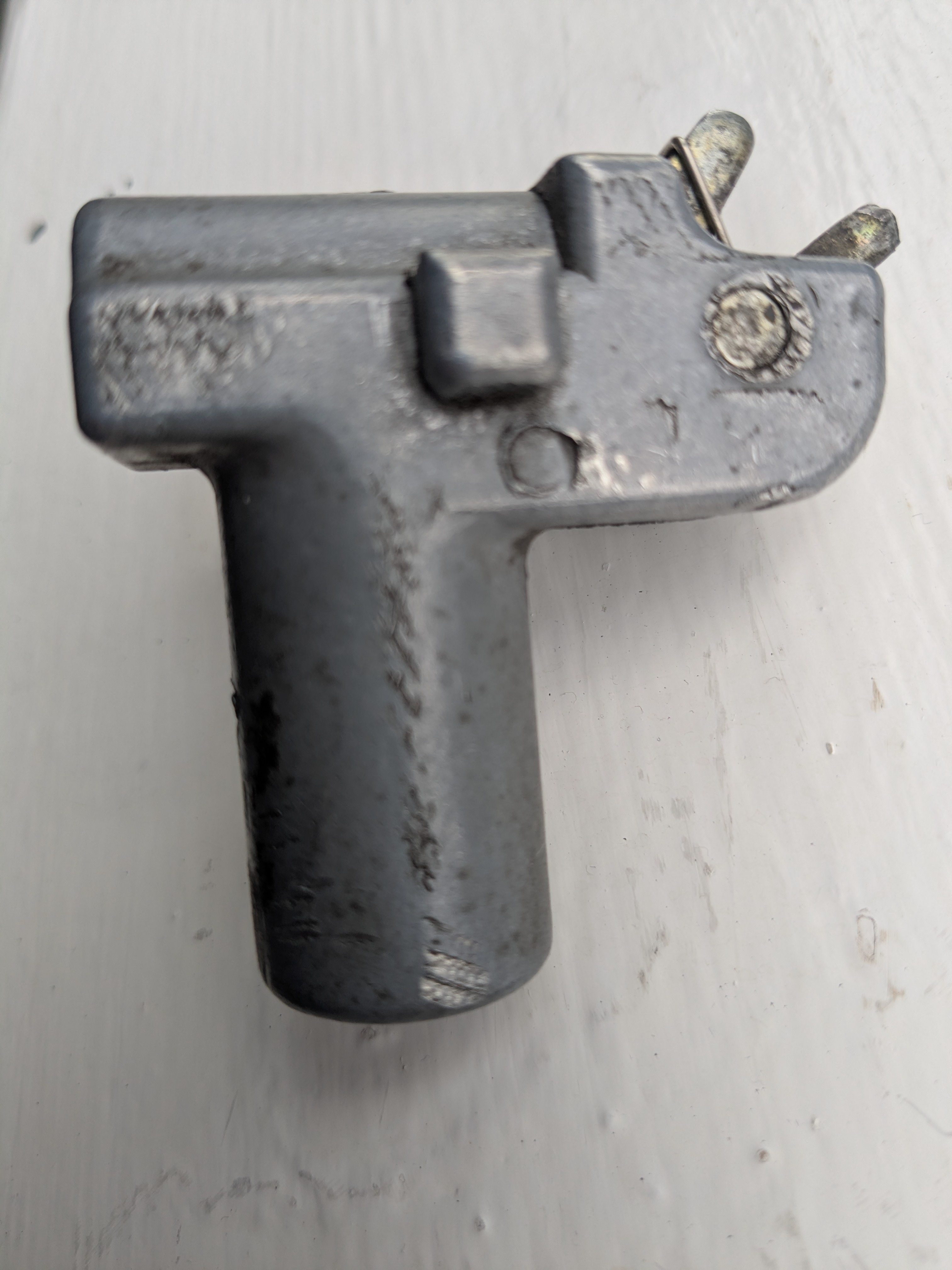

Hi Everyone
I'm looking for help regarding the key for the seat lock on my '78 KZ 1000 A2. I bought the bike at auction earlier this year and it came with 2 keys. 1 of these fits the ignition barrel and the other fits the steering lock. Both keys will slide into the barrel for the seat lock but neither will operate it. The seat lock has a reference L29 stamped on it, but key cutters like Arun locks don't recognise this number. Having a look at other available locks (without keys) on eBay, they seem to show different numbers. I've tried without success to remove the barrel from the seat lock to see if there is a different number on it.
So my questions are
firstly, would the key for the ignition or steering lock originally have fitted the seat lock?.
Secondly, does the L29 reference relate to a specific key?
And thirdly, if I persist with removing the barrel from the seat lock will I have joy in finding a relevant number.
If anyone has a spare working lock with a key that they'd be willing to sell, please let me know.
Andy

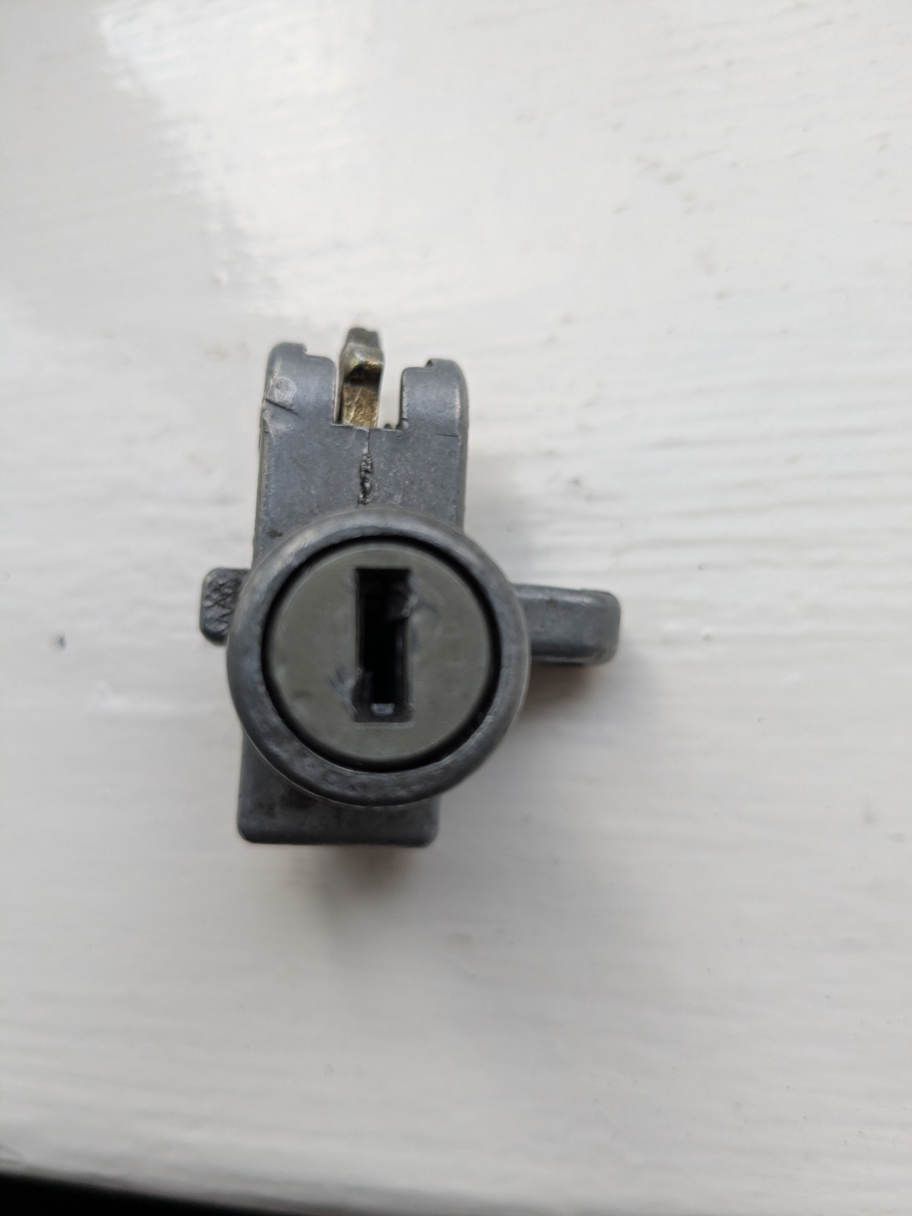

I assume your lock looks like this one below. If so, you should have the key number on the end of the barrel as seen in this part. Also, what key numbers do you currently have?

Hi

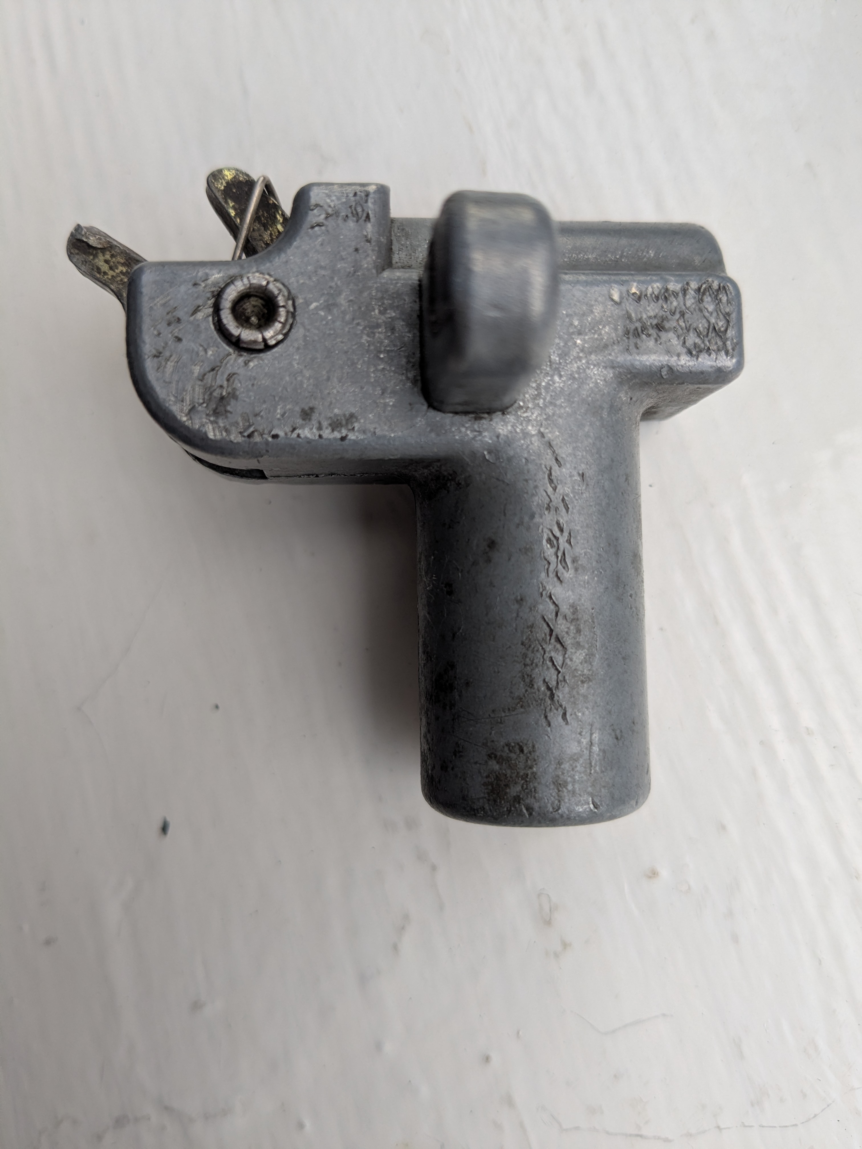

Yes, mine looks like the one in those photos, but without a number on the end of the barrel. This also seems to be the case on lots of others available on eBay, without keys, listed as spares only. Mine shows evidence of vice marks so I'm now thinking that the barrel may have been changed at some point giving me no choice of finding the correct key. It also looks like the retaining pin is also non-original which may back-up my thought that the barrel has been replaced at some point.
Anyway, I will keep looking for a replacement either on these pages, eBay, jumbles etc. Surely there has to be one out there somewhere...............................
Andy

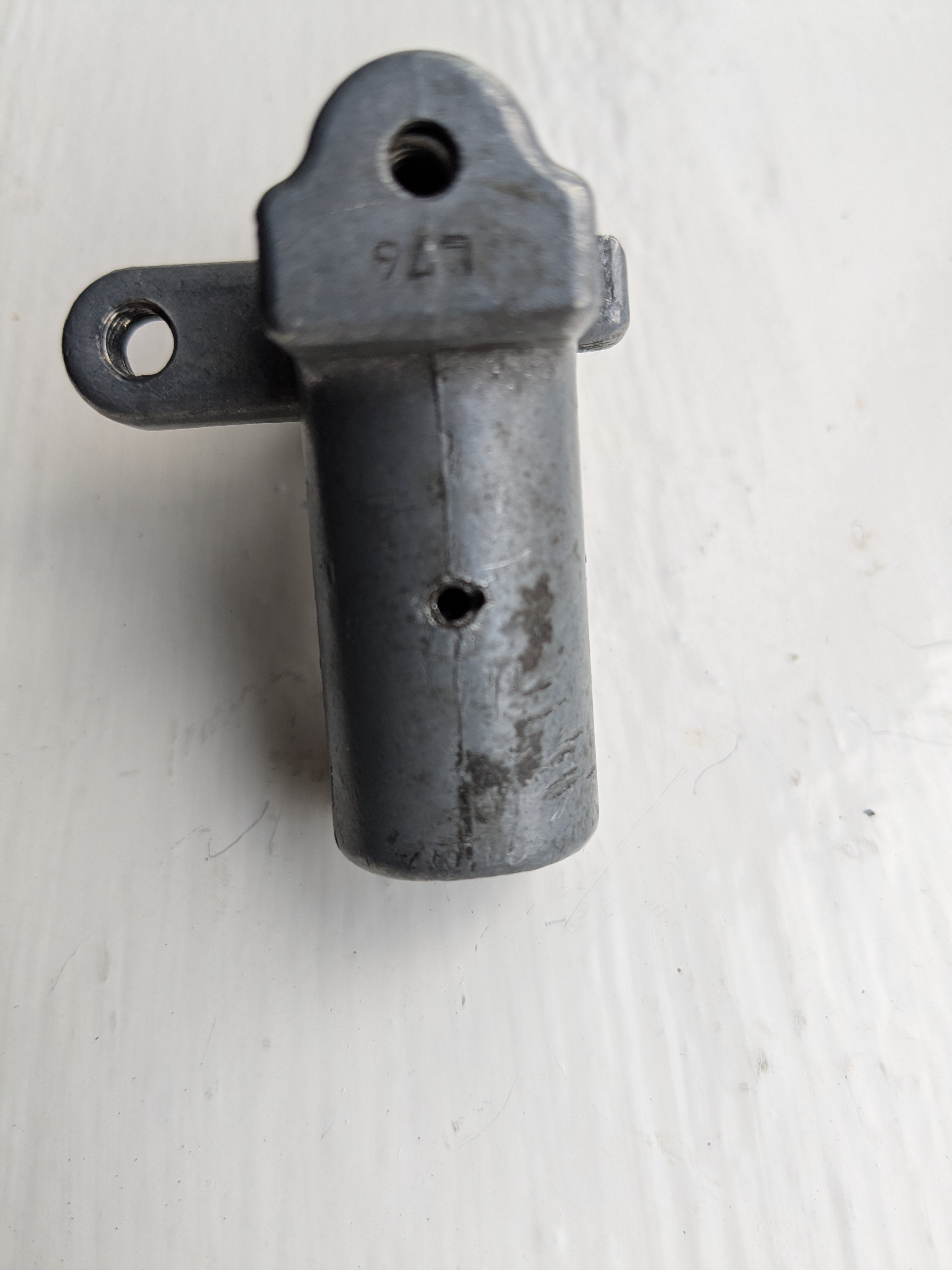

If you are interested, the L76 is a date code for June 1977. If your bike has a White sticker on the headstock for approx July/Aug 1977 then you will know that this is the original lock. There will also be date codes on your other 2 locks.

#9 PostAuthor: andyb » Fri Nov 07, 2025 3:39 pm
Thanks John, that makes sense. Yes it's June '77 on the headstock so probably the original seat lock. All the more reason I'd like to keep it on the bike!

#10 PostAuthor: z2.john » Fri Nov 07, 2025 4:37 pm
if you remove the small grub screw from the steering lock you can drop it out and check that date code. If the same then the key number for that should be the same as seat lock
