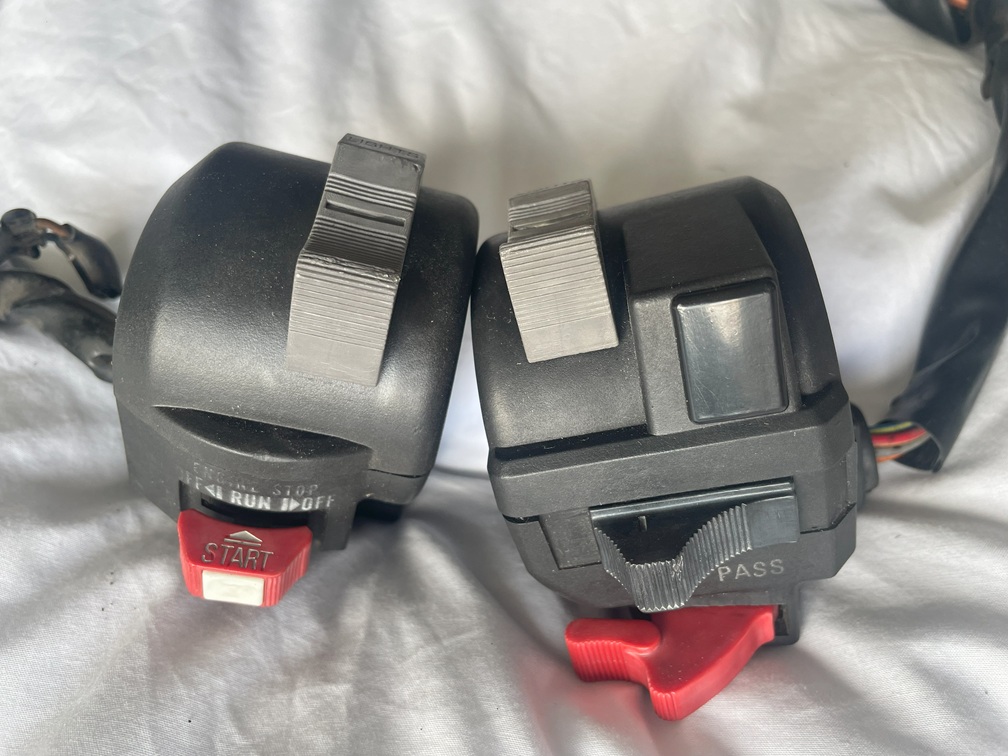

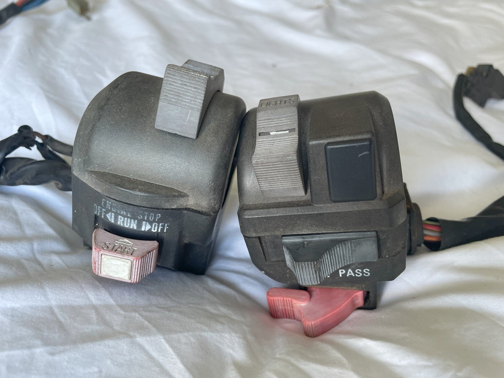

Hi all, I have a pair of GPz handle bar switches where the colour has faded badly. In an attempt to restore their colour, I’ve tried polishing them but that’s not very effective. I’ve seen YouTube vid’s where they’ve used a heat gun, but I can see that will only end in tears.
Does anyone have a recommendation to restore their colour?

Thanks for the advice guys. I had used t-cut on the horn button but wasn’t getting anywhere. In the end I used a wire wheel in a low speed Dremel to remove the bloom. This was good at cleaning up the grooves and left a slightly polished finish. The bumper black works well on the switch housing. It does darken the text a bit but as mine has almost gone anyway, I’m not too fussed.
Thanks again.
