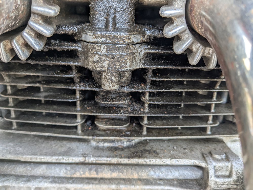

I've recently bought a KZ1000A2 with 31k on the clock. I haven't ridden it in earnest yet but it starts well, and runs and revs freely, no nasty knocks. I noticed some oil residue around the front of the cam-chain casing (see photo) so decided to carry out a compression test, the results of which are
