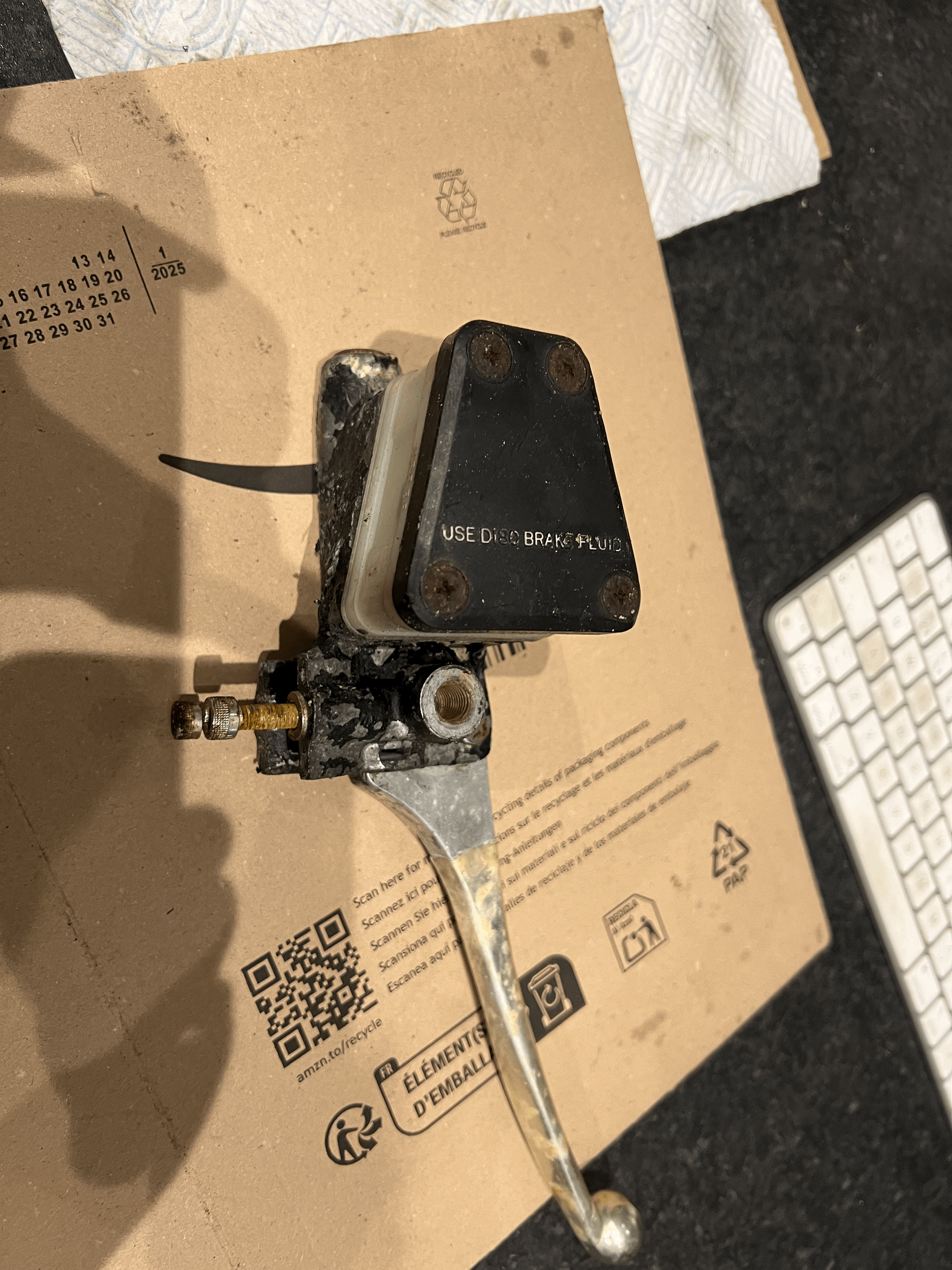

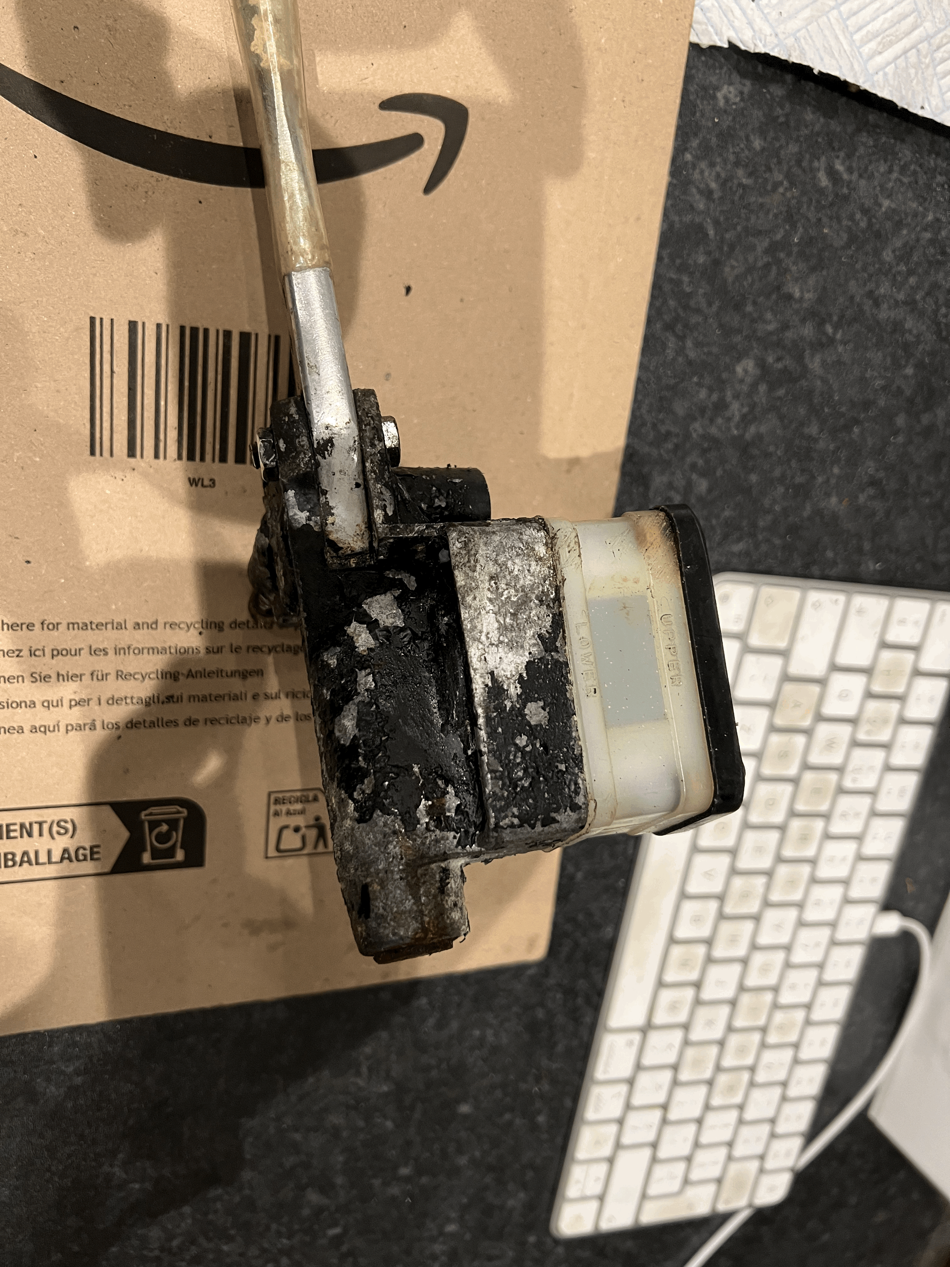

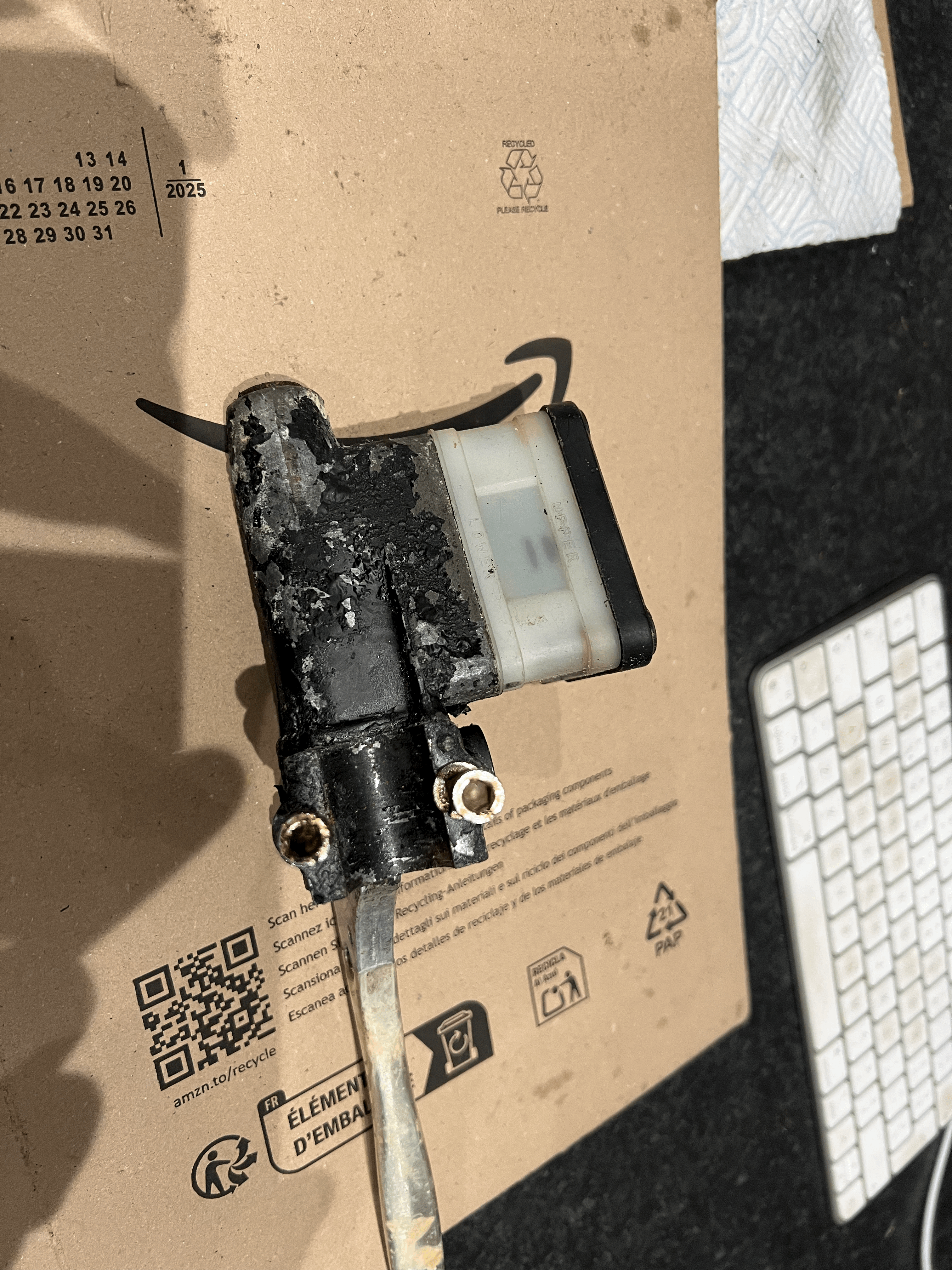

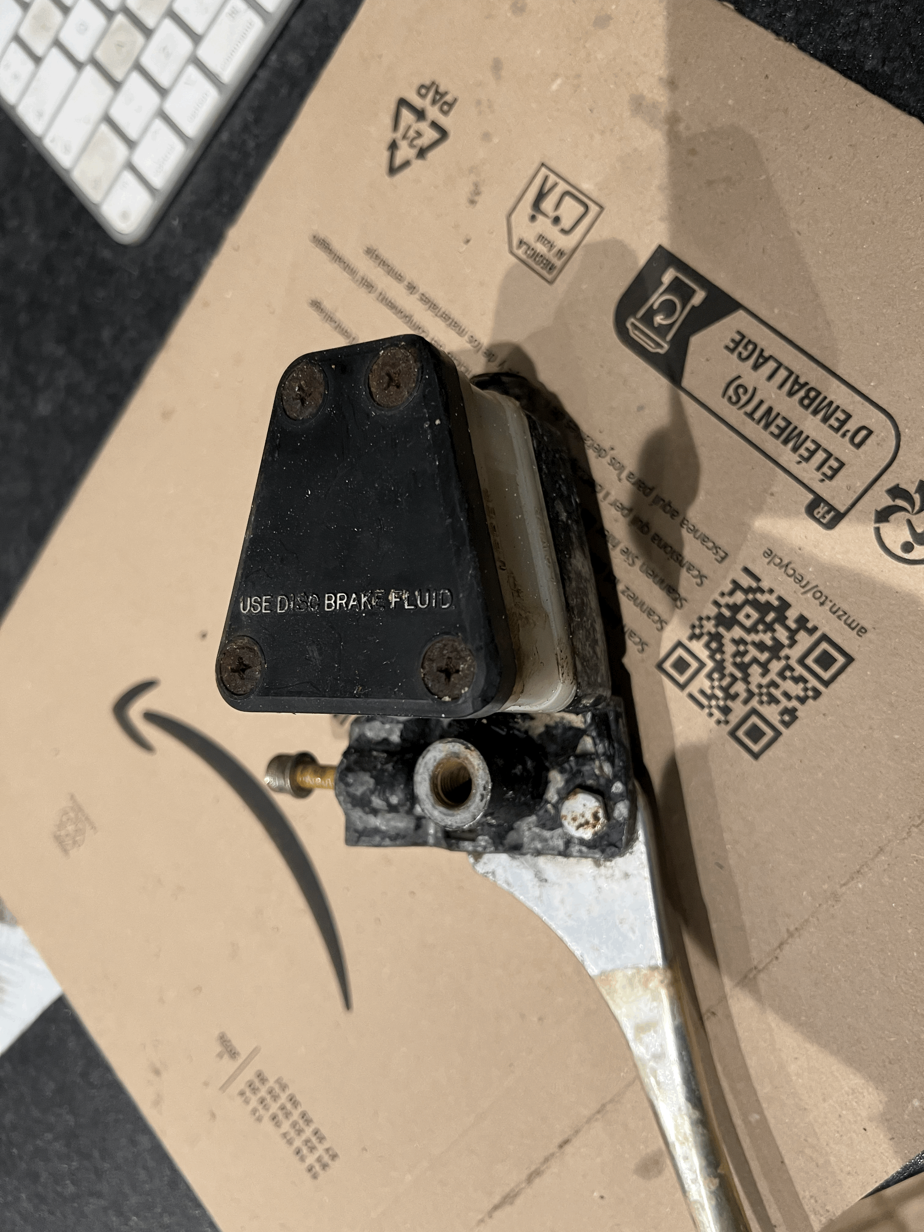

I have this master cylinder which I was told many years ago came from a Z1R. Please take a close look at the photos and confirm if it is of interest.
Posts: 1030
Re: Front master cylinder
#4 PostAuthor: Z1streetfighter71 » Fri Feb 28, 2025 7:31 pm

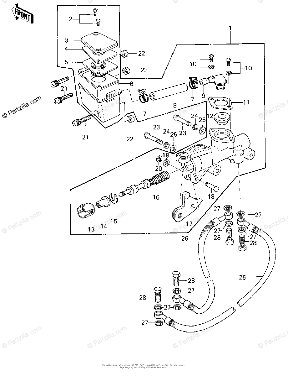

Thats off a Z1000 a2, the Z1r brake system is fairly complex affair, consisting of a brake lever perch that has a cable that is at attached to a master mounted under the cowl with a separate reservoir to the left of the fork, se below.

Agreed, the Z1r didn't have the master cylinder up by the lever, it was down in the fairing and operated remotely by a cable
