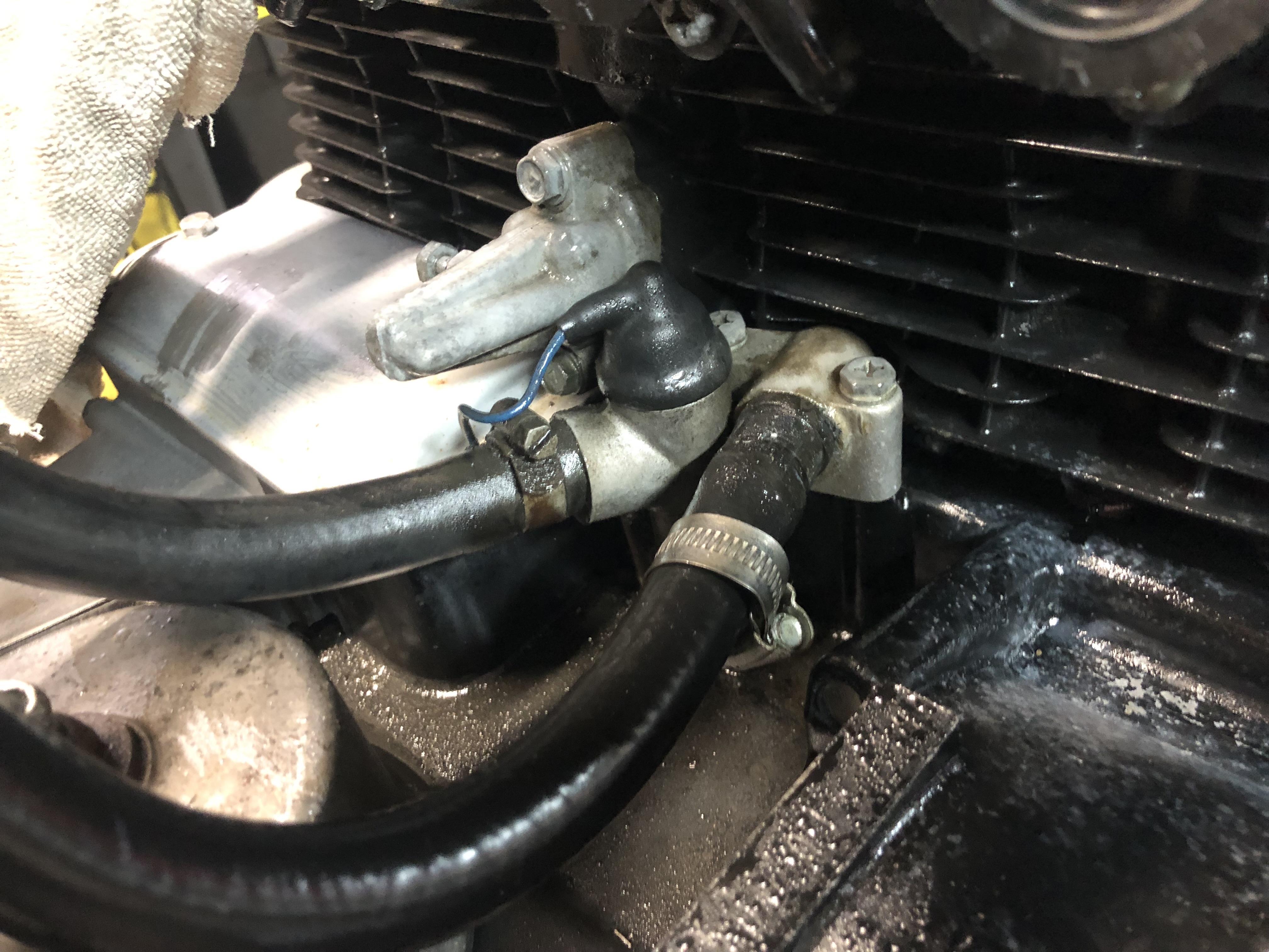

Hello all.
The 1978 Z1R I am restoring has got an oil cooler, which I want to remove. I haven’t seen it mentioned in the parts book or manual so I guess it was fitted by the previous owner.
The two pipes feeding it come from a point behind the barrels.
Can I just take the pipes off from this point and plug the two openings or does it need a circulation of some kind.

You can't just block off the oil gallery.
You need to re-fit a stock pressure switch ( see pic ) in place of the cooler pipe fittings ( or just connect the two with a short loop of hose if you don't want 100% original) otherwise you will starve the engine of oil.

Thanks Z1015
The previous owner must have fitted the part from a later model.
Do you know where I might be able get the part from.

The oil cooler and fittings are aftermarket performance parts and not stock parts from a later model.
Original oil pressure switches are listed on Ebay but asking on the forum in the wanted section will likely get you one from a member.
The switch from any Z1 through to Z1000mk2 kickstart equipped engine will fit.
The cooler fittings are also worth a few quid so selling those would more than cover the cost of the pressure switch or form the basis of a trade..

Thanks very much Zed1015
Yes I found one at Z Power so I’ve bought that one.
