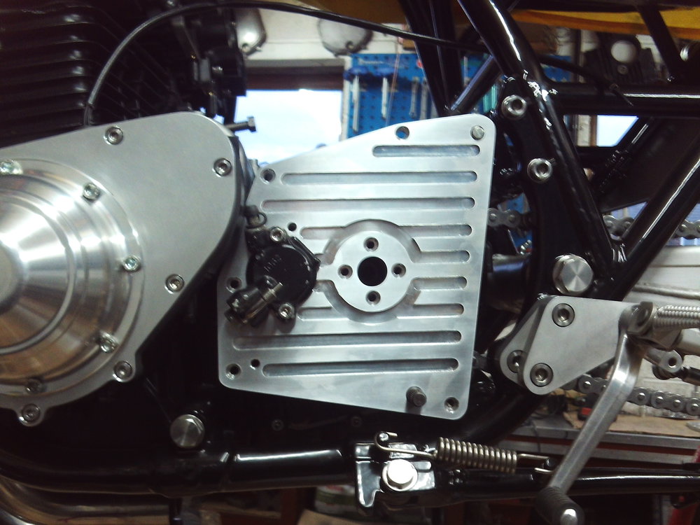

#3 PostAuthor: zed1015 » Fri Dec 13, 2024 3:56 pm
Z1streetfighter71 wrote:zed1015 just finished a savage racecrafters build with one, build thread below. He might tune in and lend an ear. viewtopic.php?f=7&t=45726
Yes! Done loads.
Mostly using outrigger plates as in the attached pic but it can be done using the original sprocket cover.
Favorite slave cylinder is from a ZX7/ZX9R.
