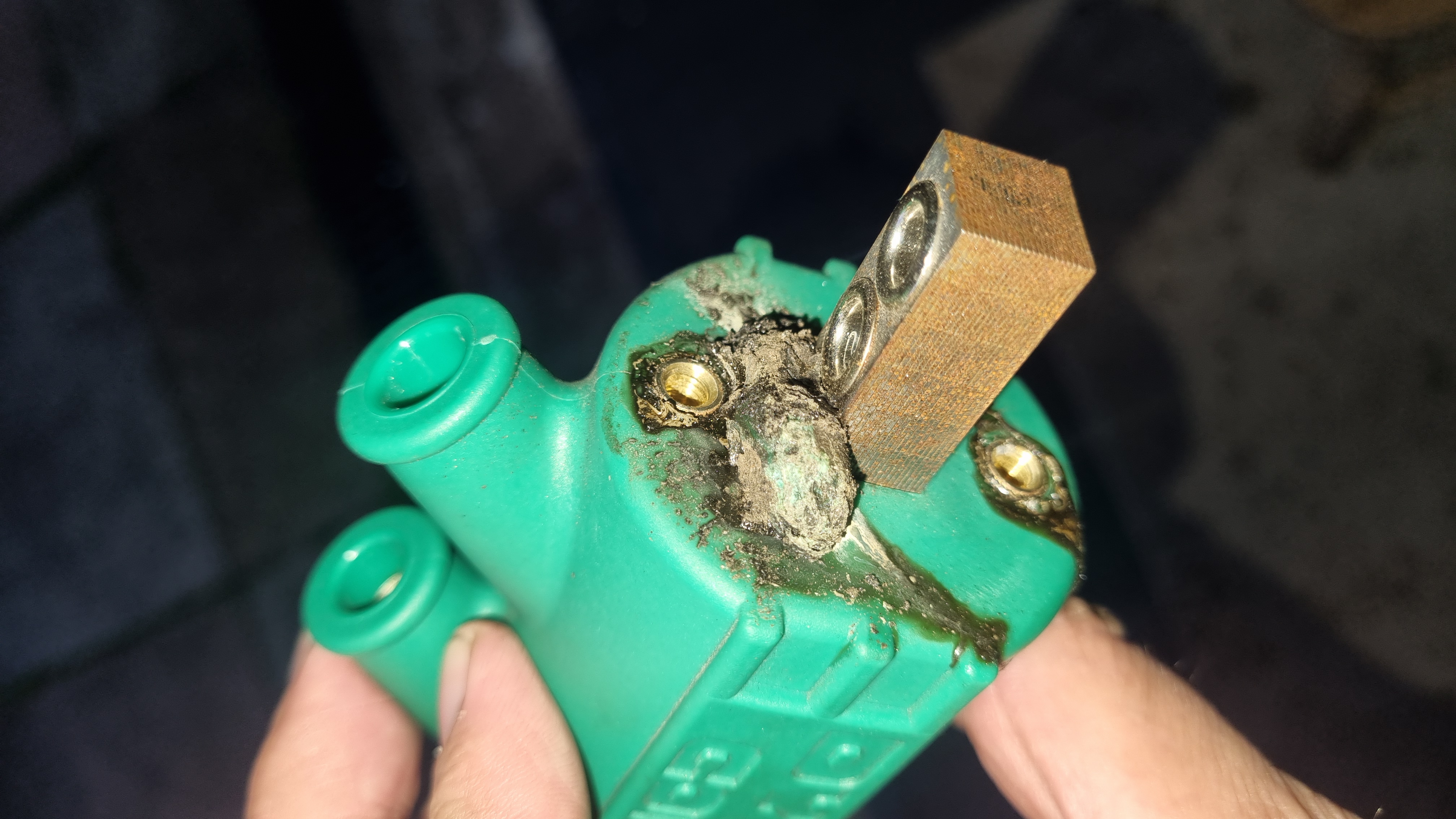

hi anyone had a problem with a dyna coil burning out? Could it be just bad luck or something else other coil is fine and I've swapped the wires on the sender unit and seems to be sending a spark from both sides.?

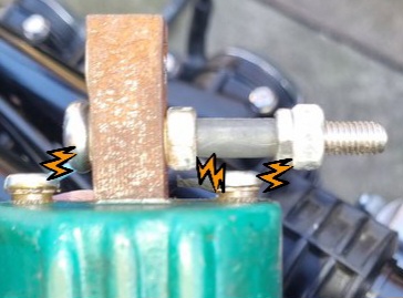

Re: Dyna coil
this is the other side the duff coil was mounted the same

Re: Dyna coil
It looks like the coil core heat sink bar is not actually able to heat sink to the frame and has caused the coil to overheat.
Zooming I'm on the pic shows the nylon Bush going through the core bar and the cross head is seperate from the core bar also which means the bar is isolated and unable to dissipate core heat unless that's a washer under the cross head?
That'll burn out the coil in a pretty short time frame.

So got a replacement coil and changed the mounting arrangements on both to this. Bike fired up and hopefully no further problems. Thanks for the help all.

Assuming the spacer is insulated from arcing then to be 100% confident I would also insulate these points. Easiest way would be to cover or paint the terminal connections. Electricity has a knack of finding the route of least resistance to ground, especially when damp.
