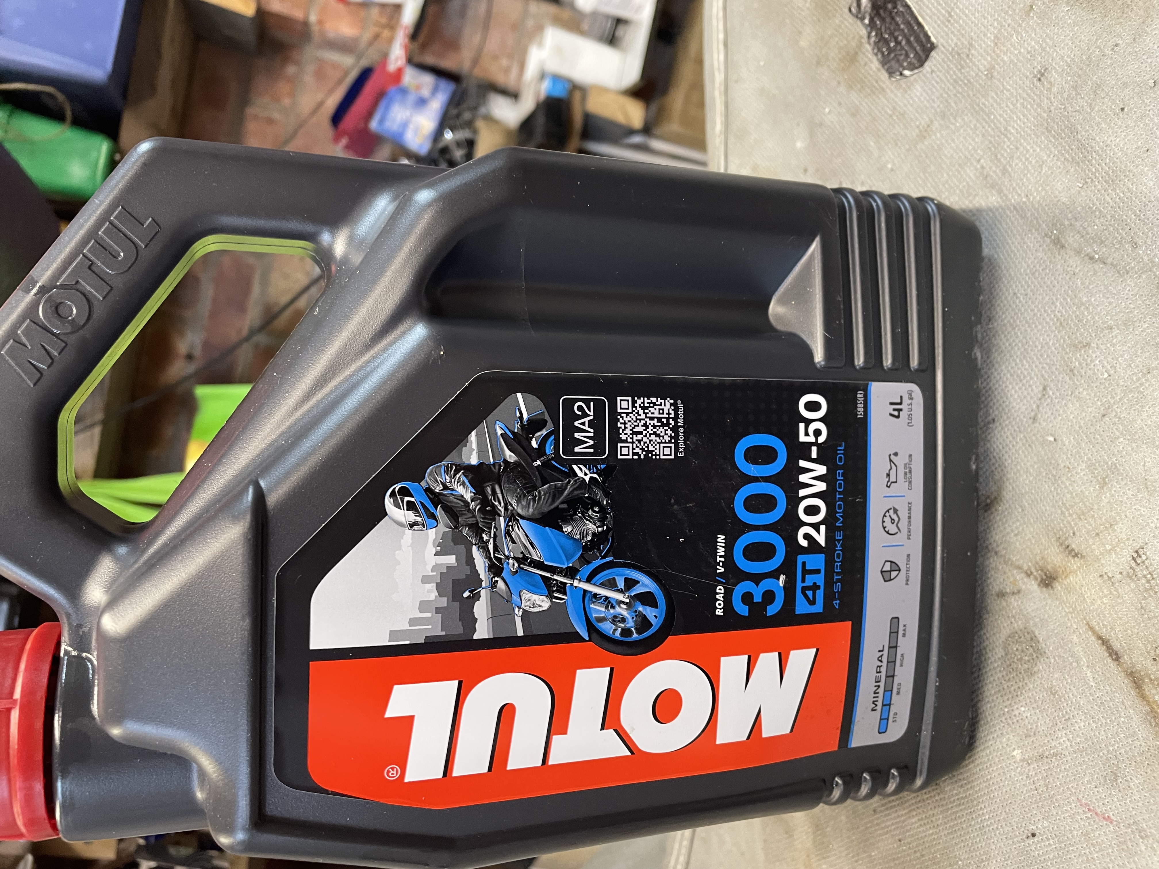

are you running car 10-40 oil instead of motorcycle 10-40? Car stuff has more friction reducers, and will contaminate the friction plates so the clutch plates will slip more and maybe screech.
Or maybe 1 plain plate has overheated and warped
gray
shaggy
Posts: 248
Joined: 5th Oct 2009
Location: Portsmouth
Re: Clutch issue on pull away
#6 PostAuthor: shaggy » Wed Aug 07, 2024 3:35 pm
This is the oil I’m using
