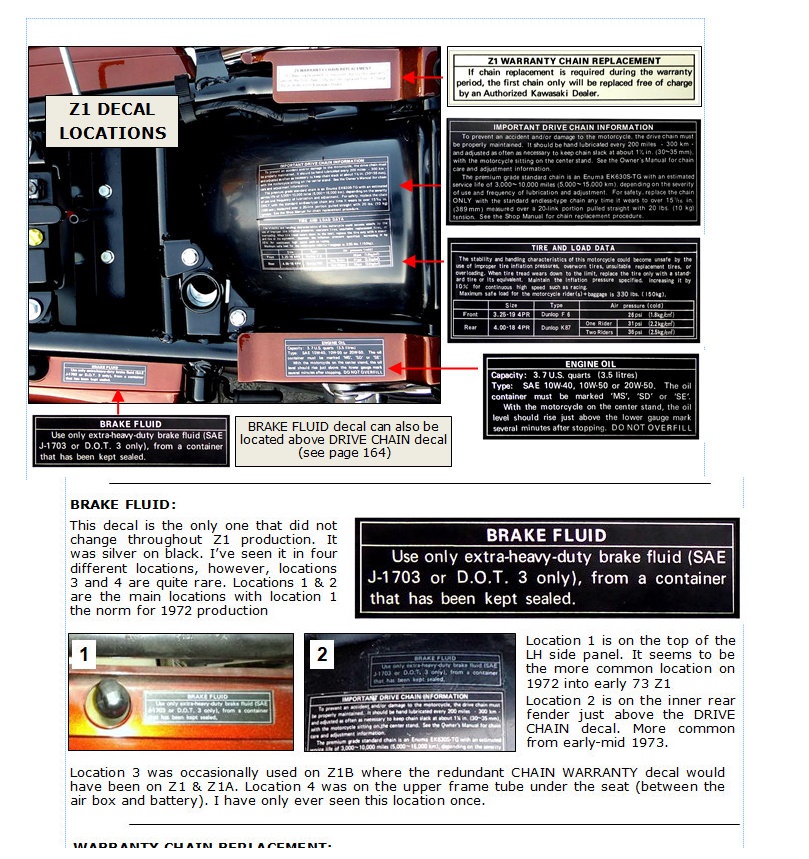

Is there a guide to location of warning decals etc for the Z1B?
I've got most of the decals I think but not sure exactly where they go - any help would be appreciated.

#2 PostAuthor: z2.john » Sun Jun 23, 2024 9:12 am
Fullscreen capture 23062024 100729.jpg (327.54 KiB) Viewed 1244 times

Thanks for the quick response and info. - really useful.
The only one now is the battery vent tube warning which I think goes on the seat pan at the back?
