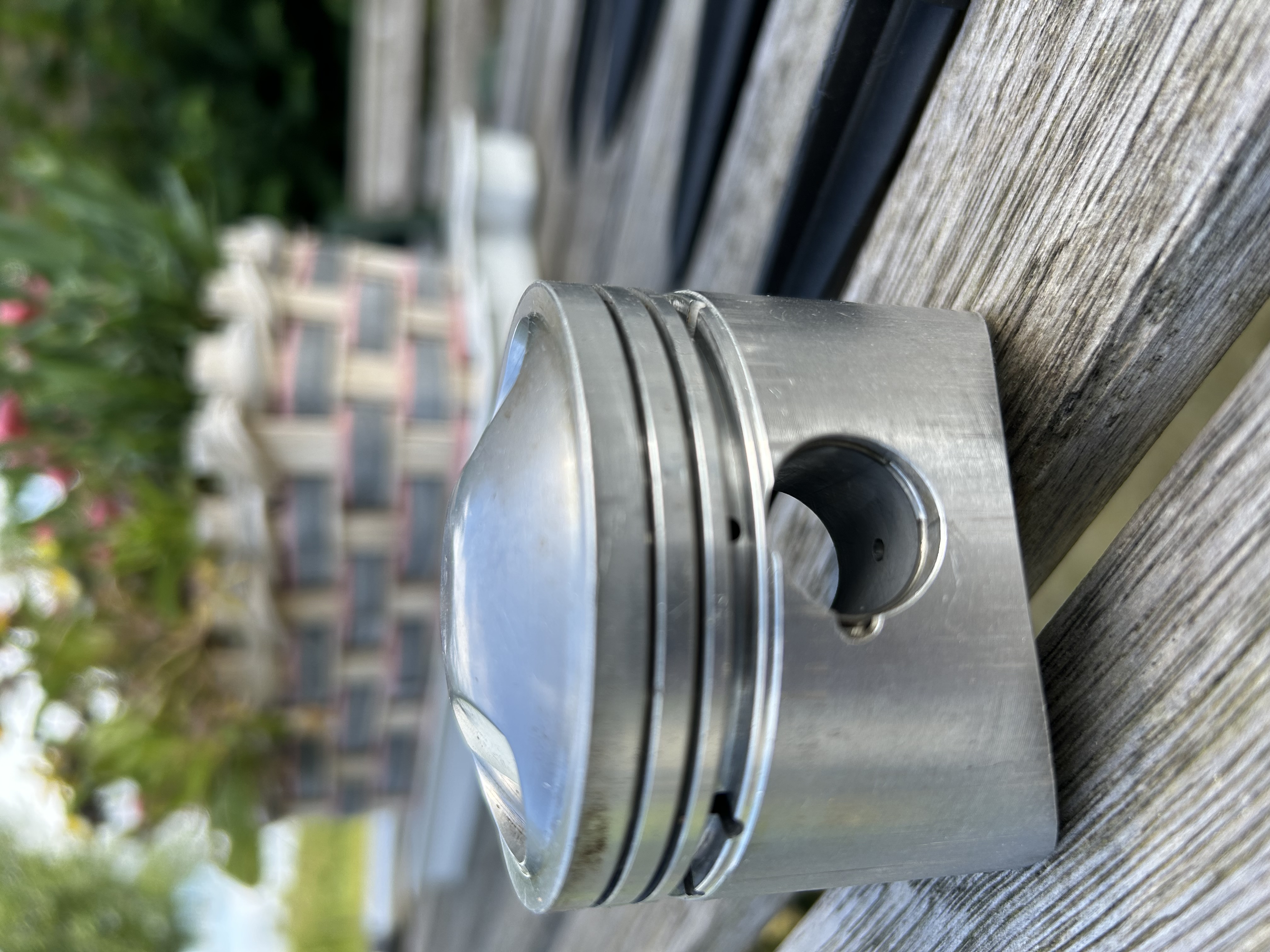

Having my kz900 for 15 years he timing chain and stuff needed to be replaced,so far so good.During the rebuild the bottom oil ring got caught and bent

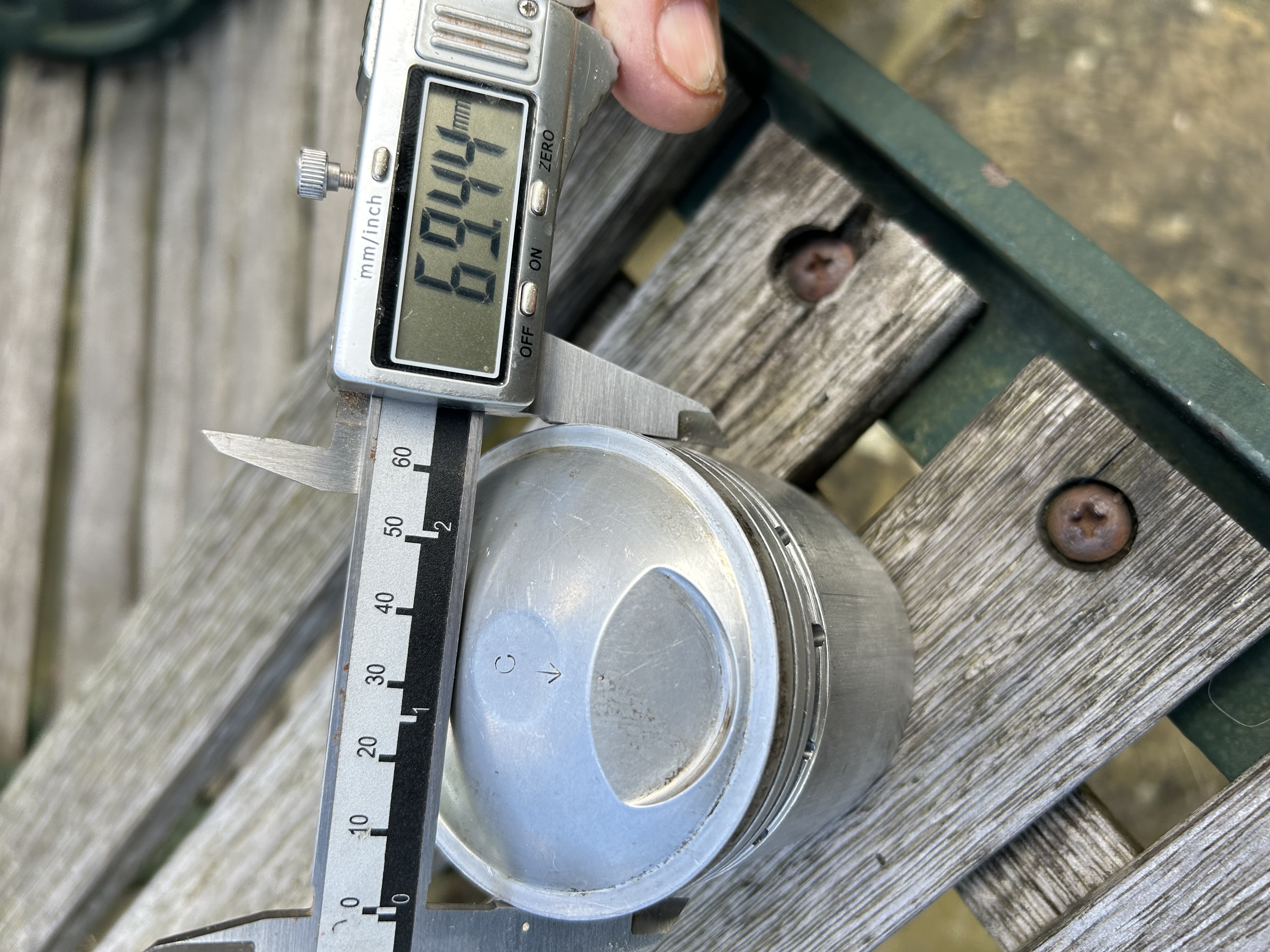

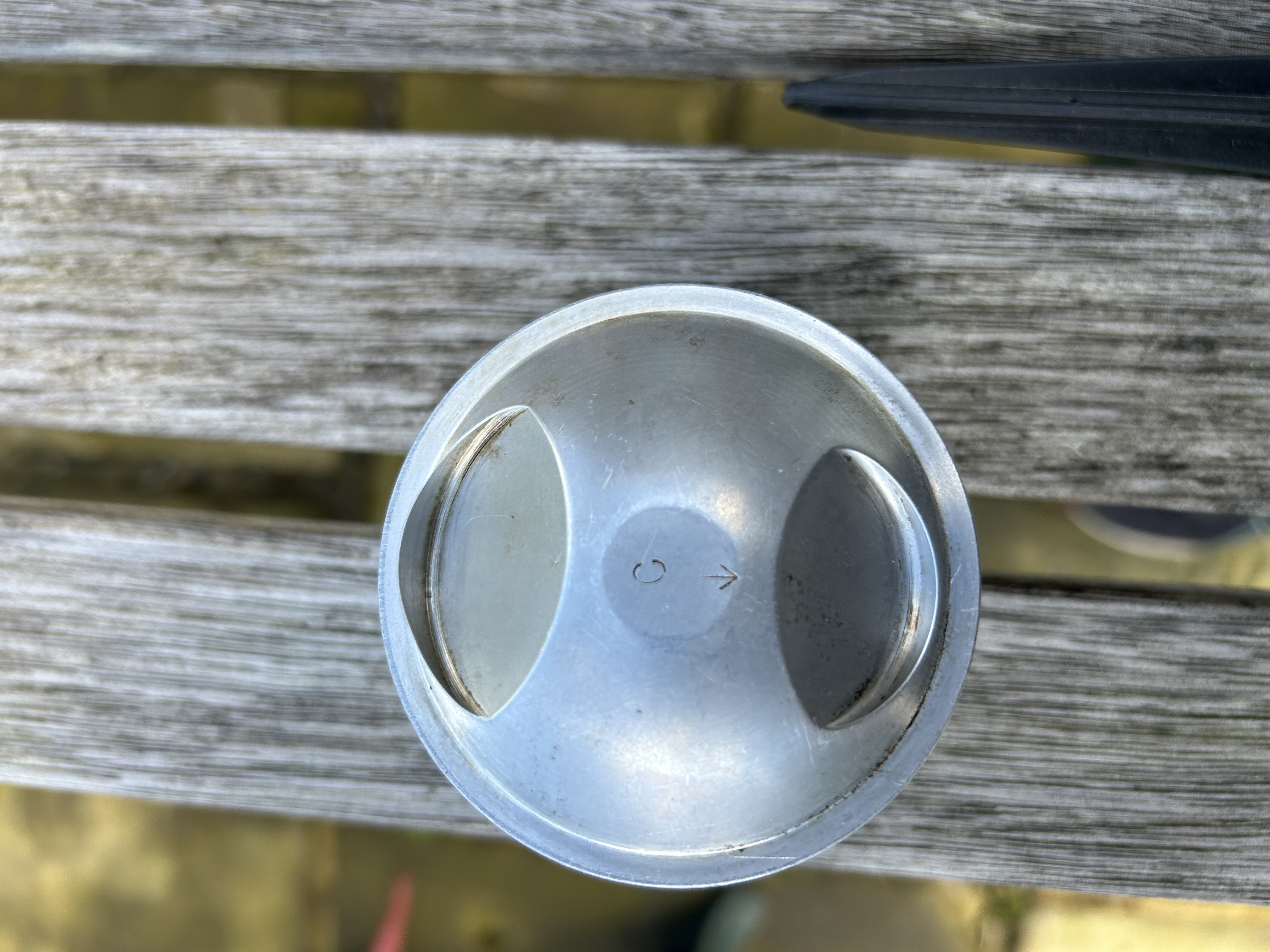

I find out that these are aftermarket high compression pistons 155 on each cylinder the only mark on these is a c in the middle of the valve cut outs.I find that the ring depth of 3.1 and height of 2.7 with a radius of 69.4 is not a standard size.I have been to all the obvious places with no luck.At the moment my only choices are getting the bottom ring slot remilled to except another one or replace all 4 pistons!!!Has anyone any thoughts regarding this?

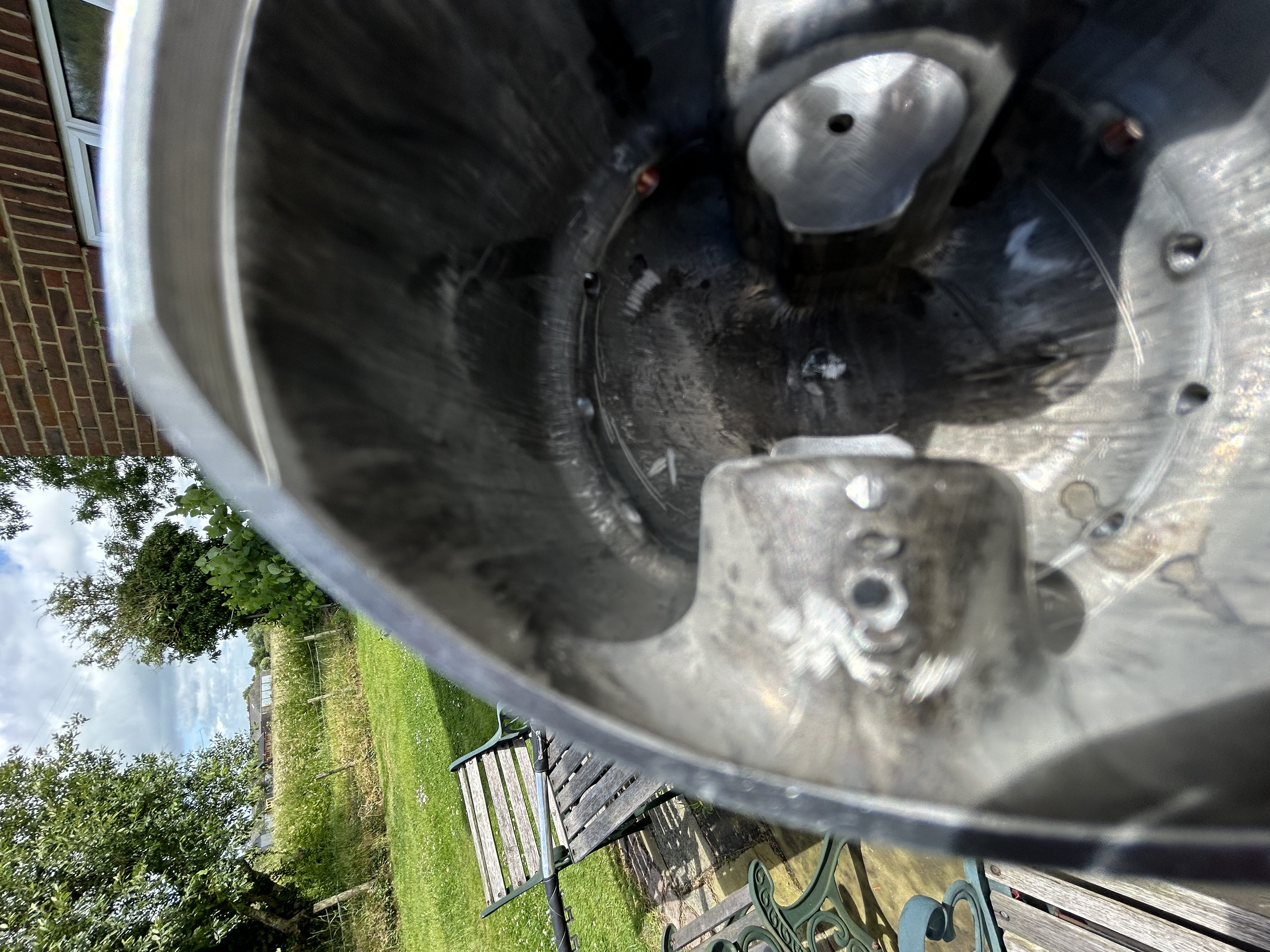

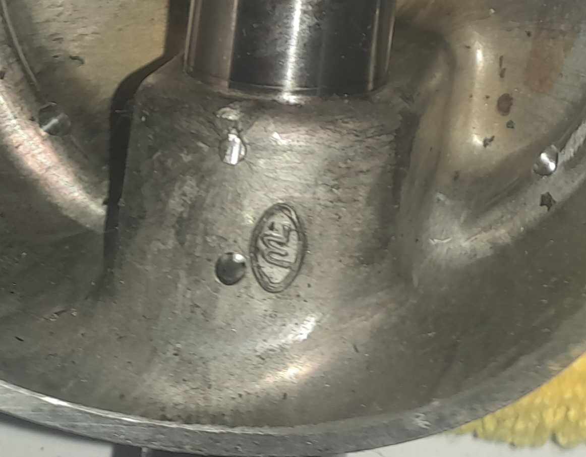

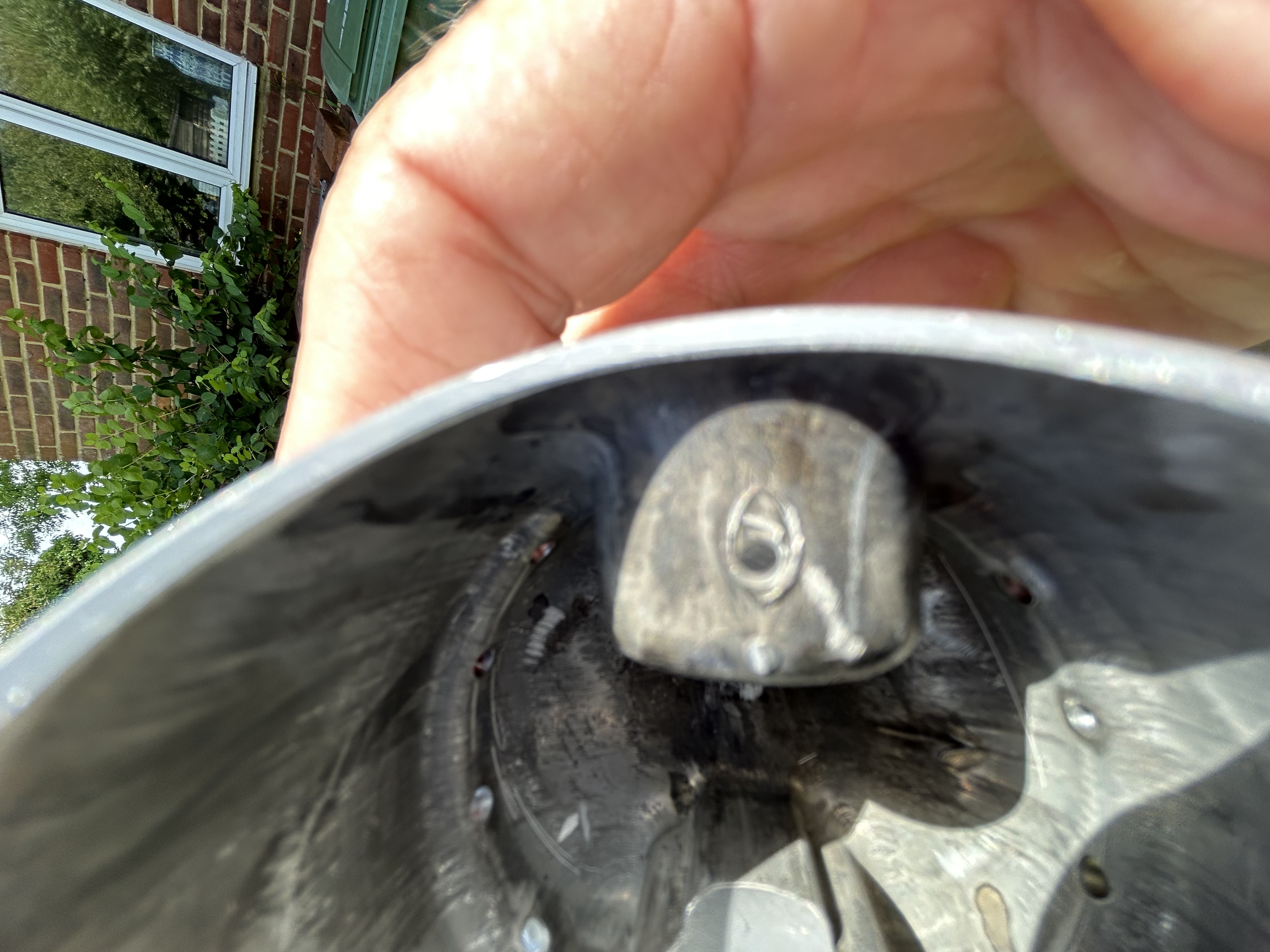

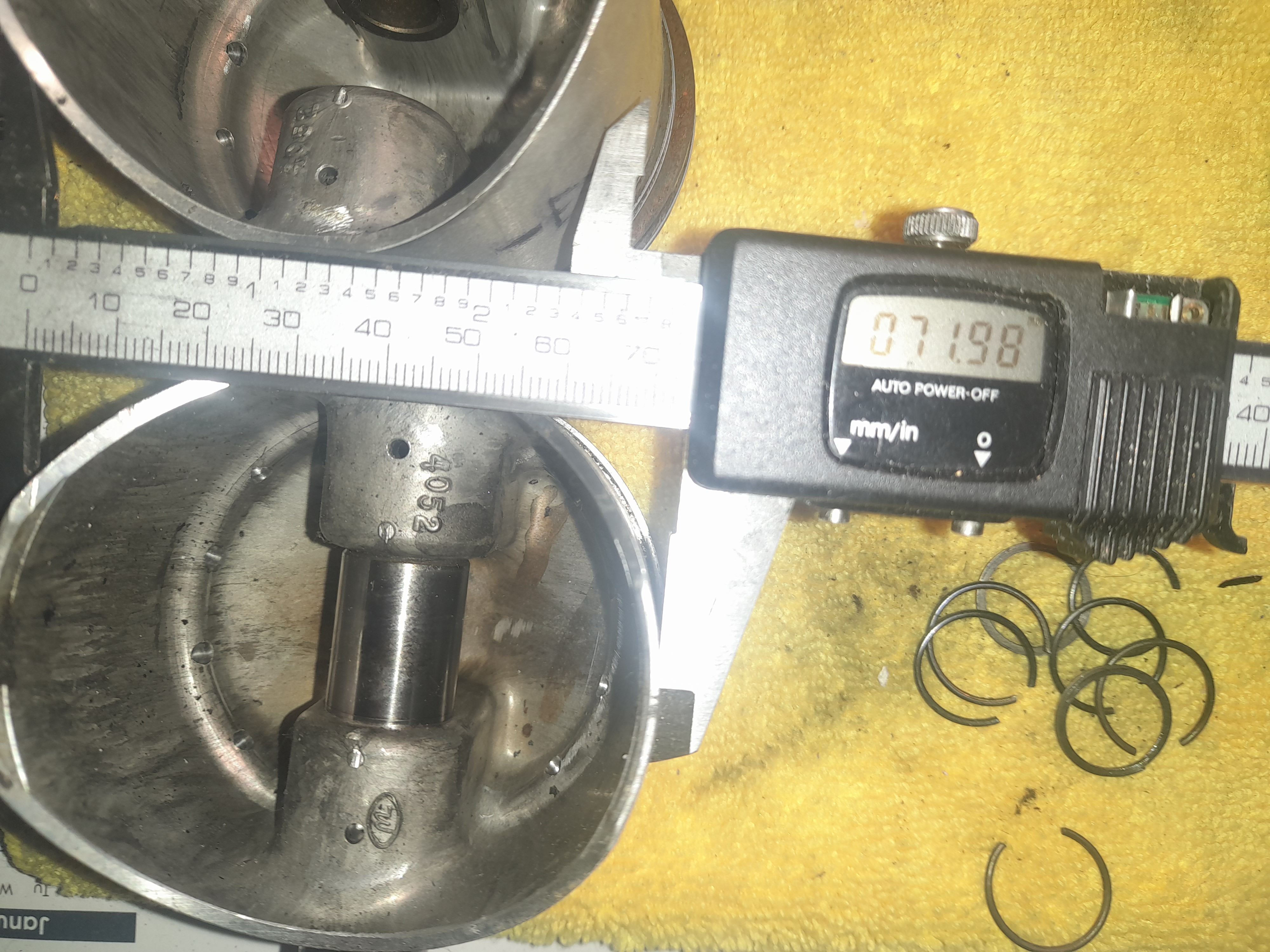

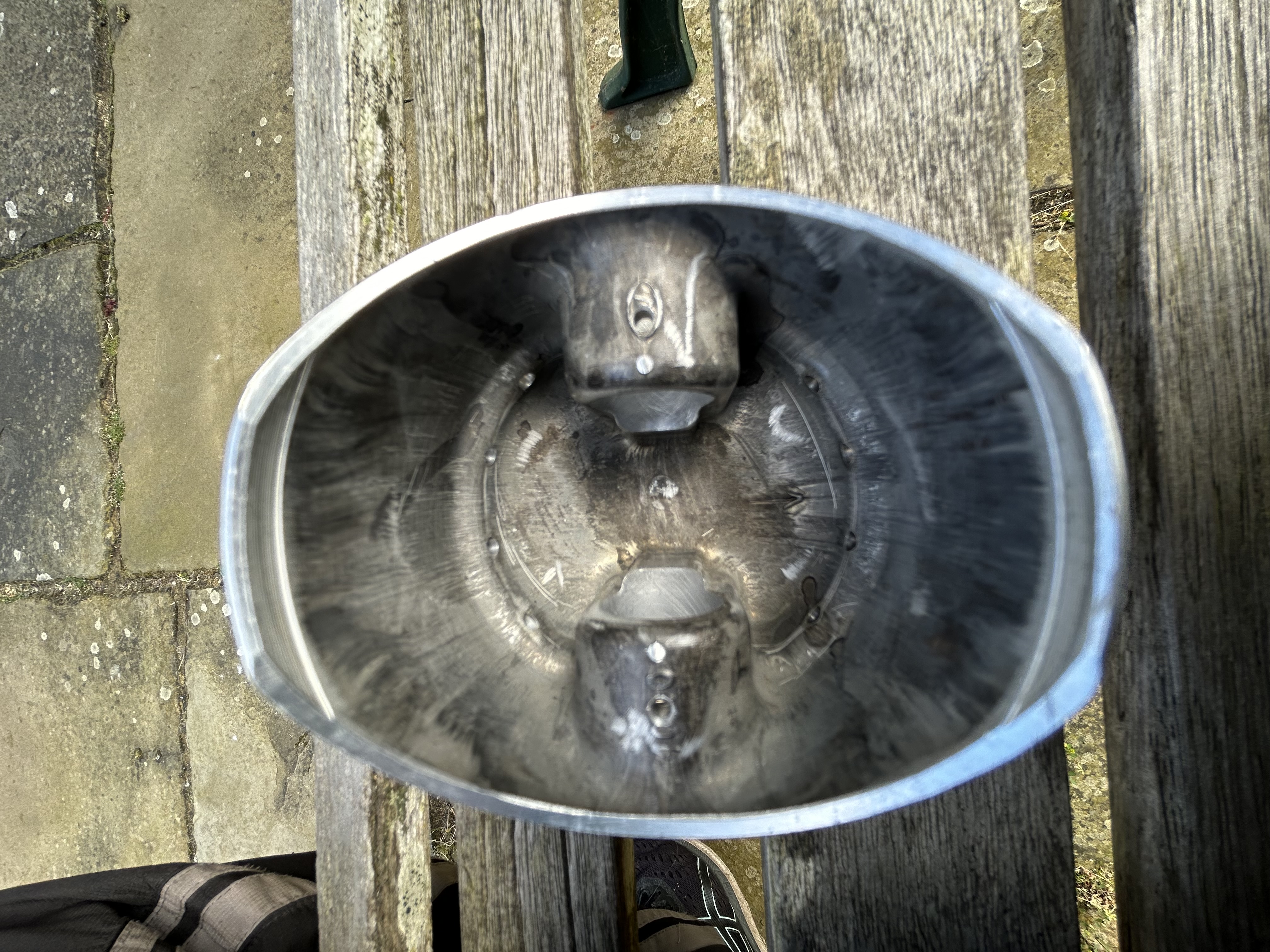

Pic's may help identify the make of the pistons.
There are usually markings inside the piston on the skirt or gudgeon pin boss.
Rings are usually available once that info is known.

Standard size but unfortunately the ring dimensions for the oil control ring are different.So I can’t use the rings from the Z1000J.I am 3/4 through stripping the engine down again , should have the piston out of the block and try to find an identification mark

Those are Wiseco pistons.
10.25 - 1 compression.
The 'C' denotes the ring type = XC which are in common use by Wiseco, MTC, JE and probably others.
Pistons taper inward toward the top so you need to measure at the bottom of the skirt or the cylinder bore which will likely be 70mm - 1015cc but if they are 69.50mm then Eastwood Racing in London has rings for them.
https://www.wiseco.co.uk/products/2736x ... t-69-50-mm

I have measured at the top 69.5 and the skirt at 70 ,Is Eastwood racing the best place to go ?
Re: Oil control rings
Mark W wrote:I have measured at the top 69.5 and the skirt at 70 ,Is Eastwood racing the best place to go ?
Then they are 70mm - 1015cc pistons.
Eastwood Racing is a UK Wiseco importer so probably the best place to start with the search.
