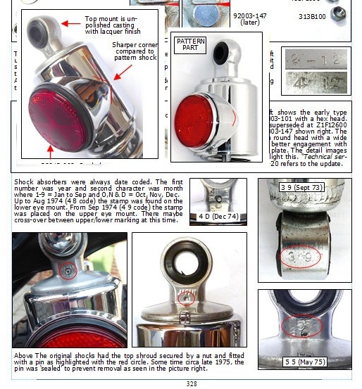

Hello can anyone tell me how you tell genuine rear shocks z1b thanks

Just below the top eye on the stem there is a hole for a dowel pin which isn't on the Pattern items.....

Date codes, pinned top shroud and sharper corner as seen below are the main tell tales
