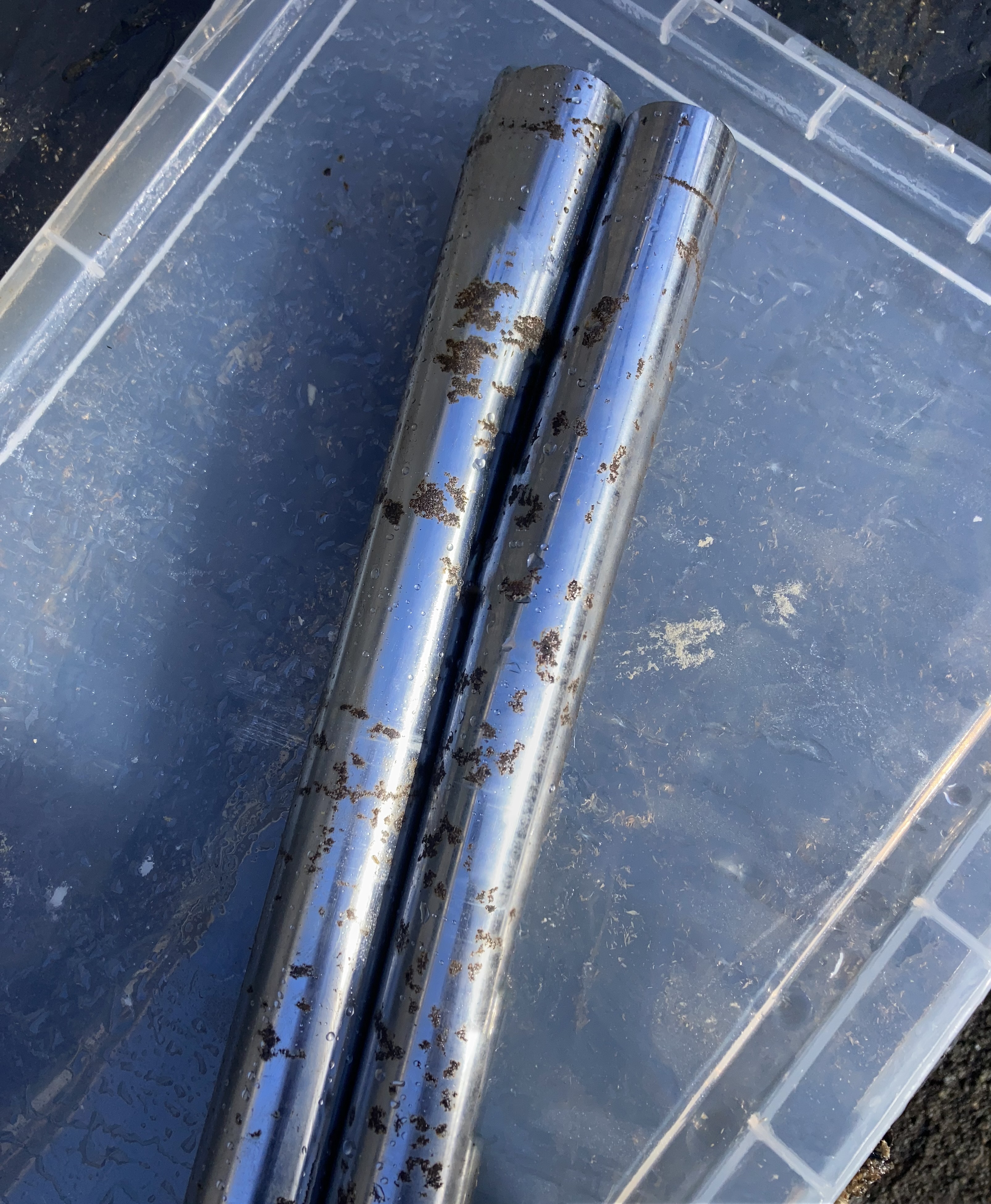

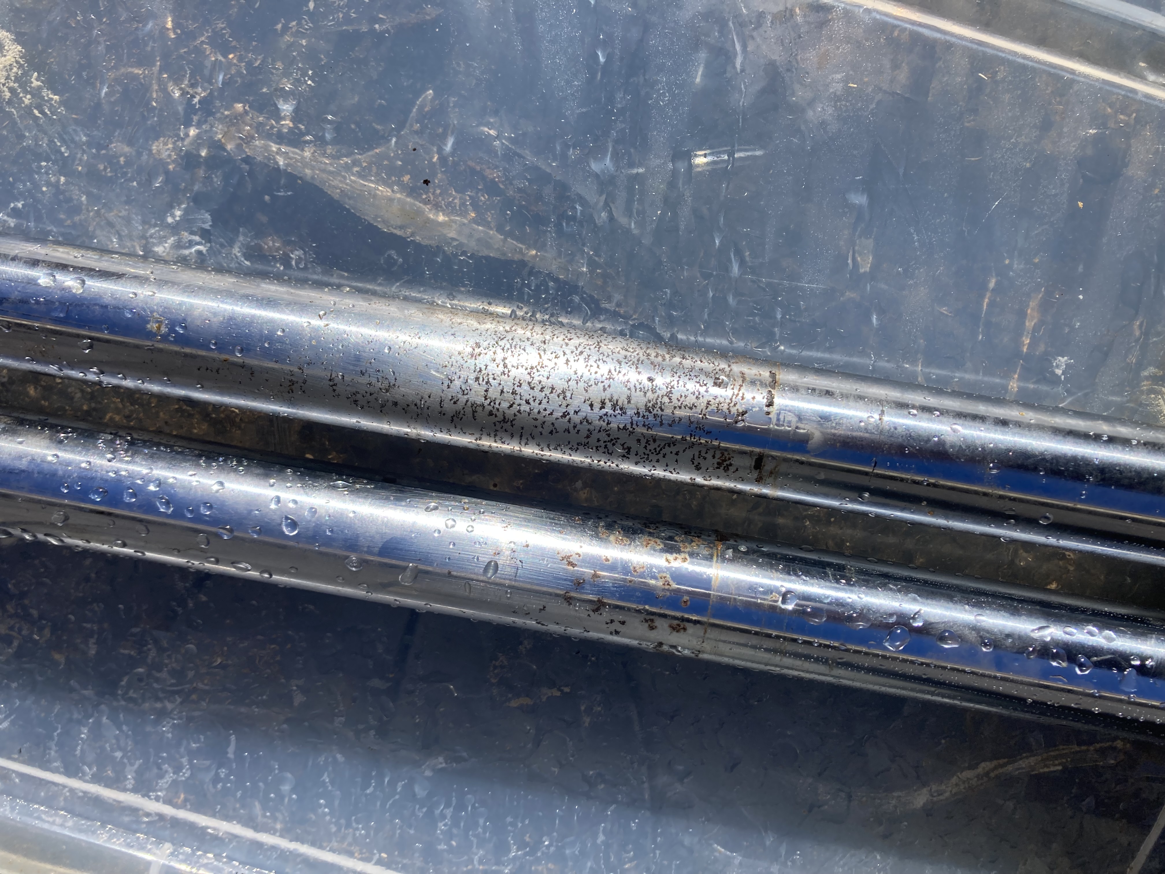

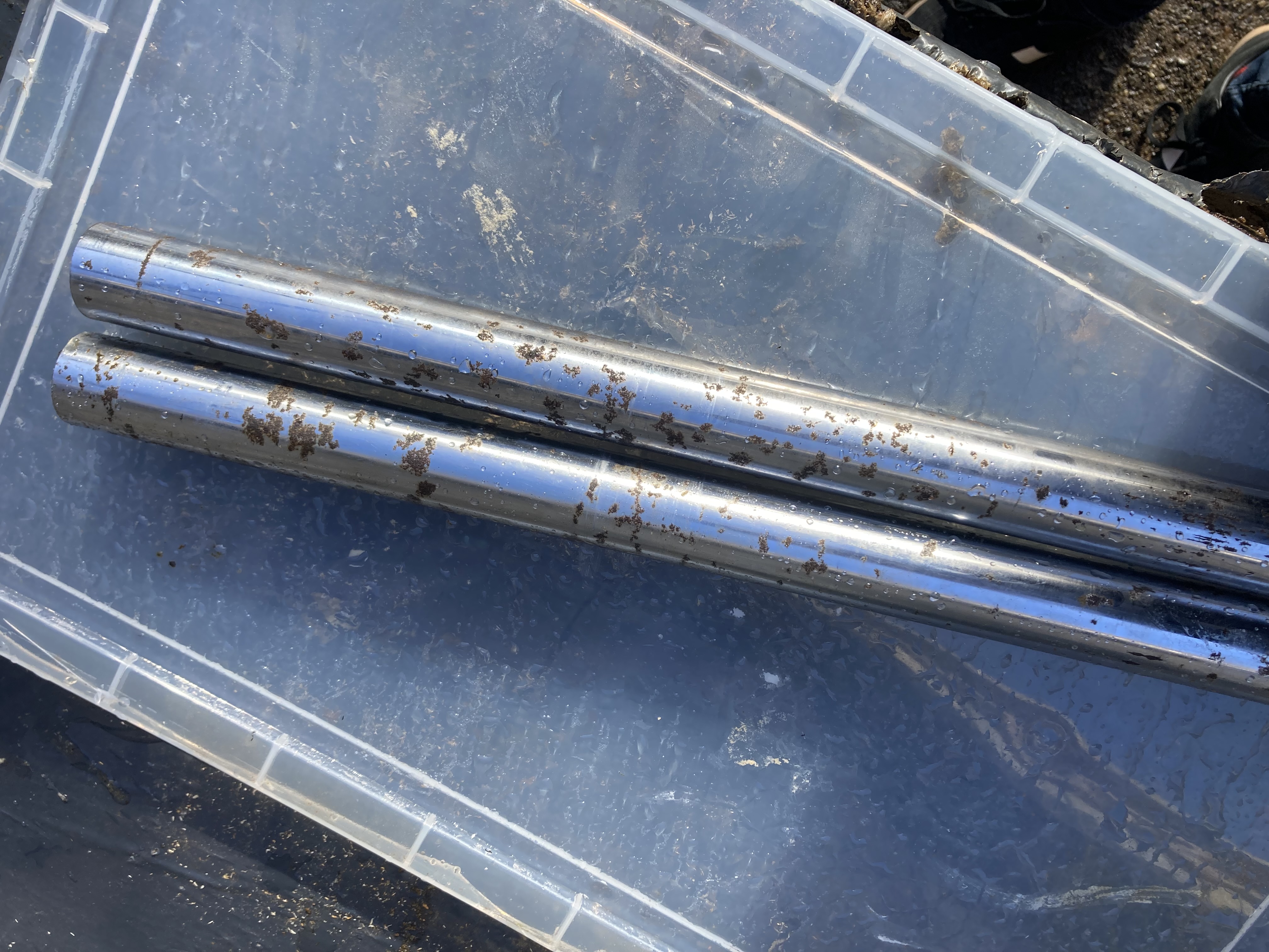

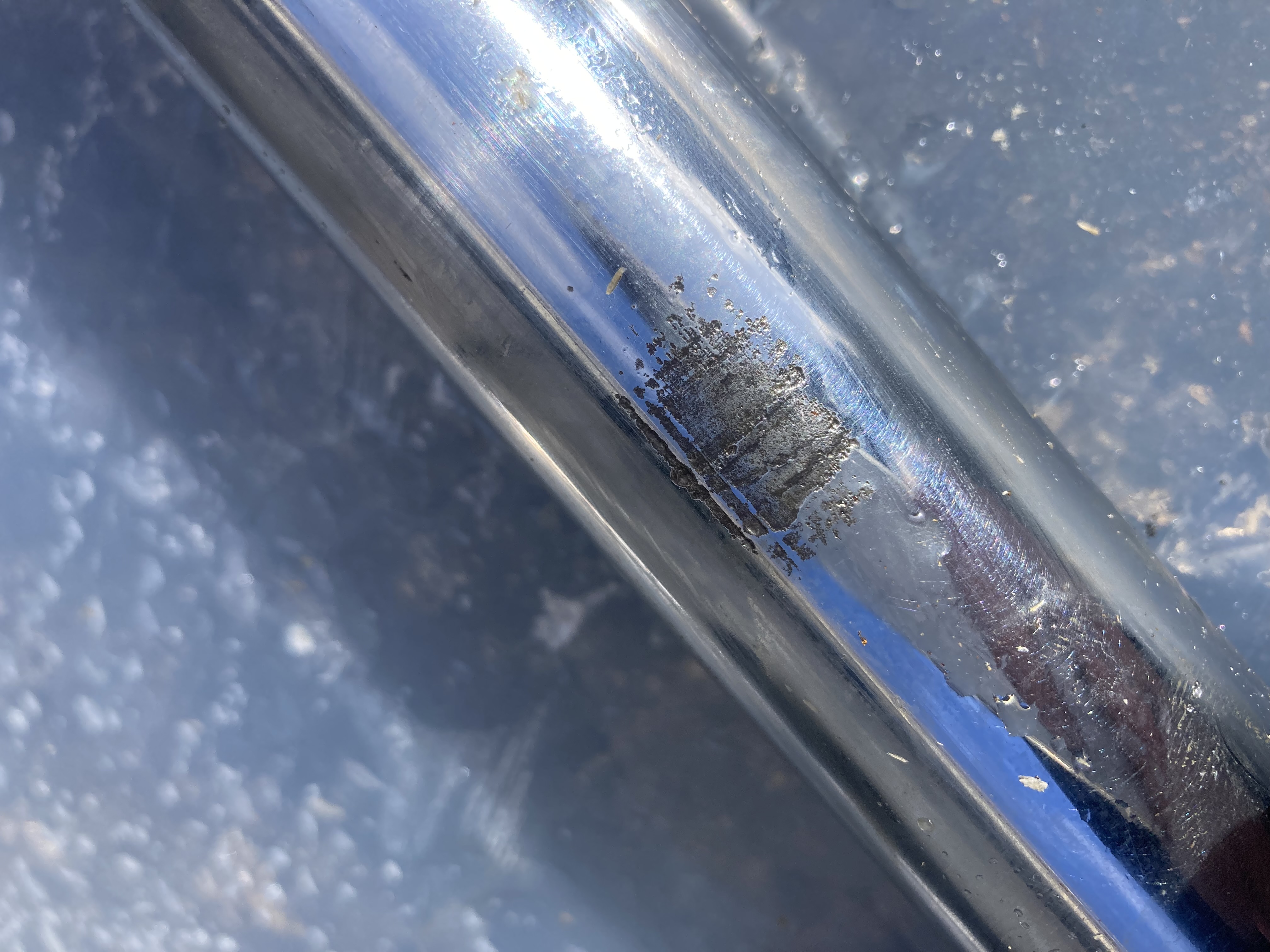

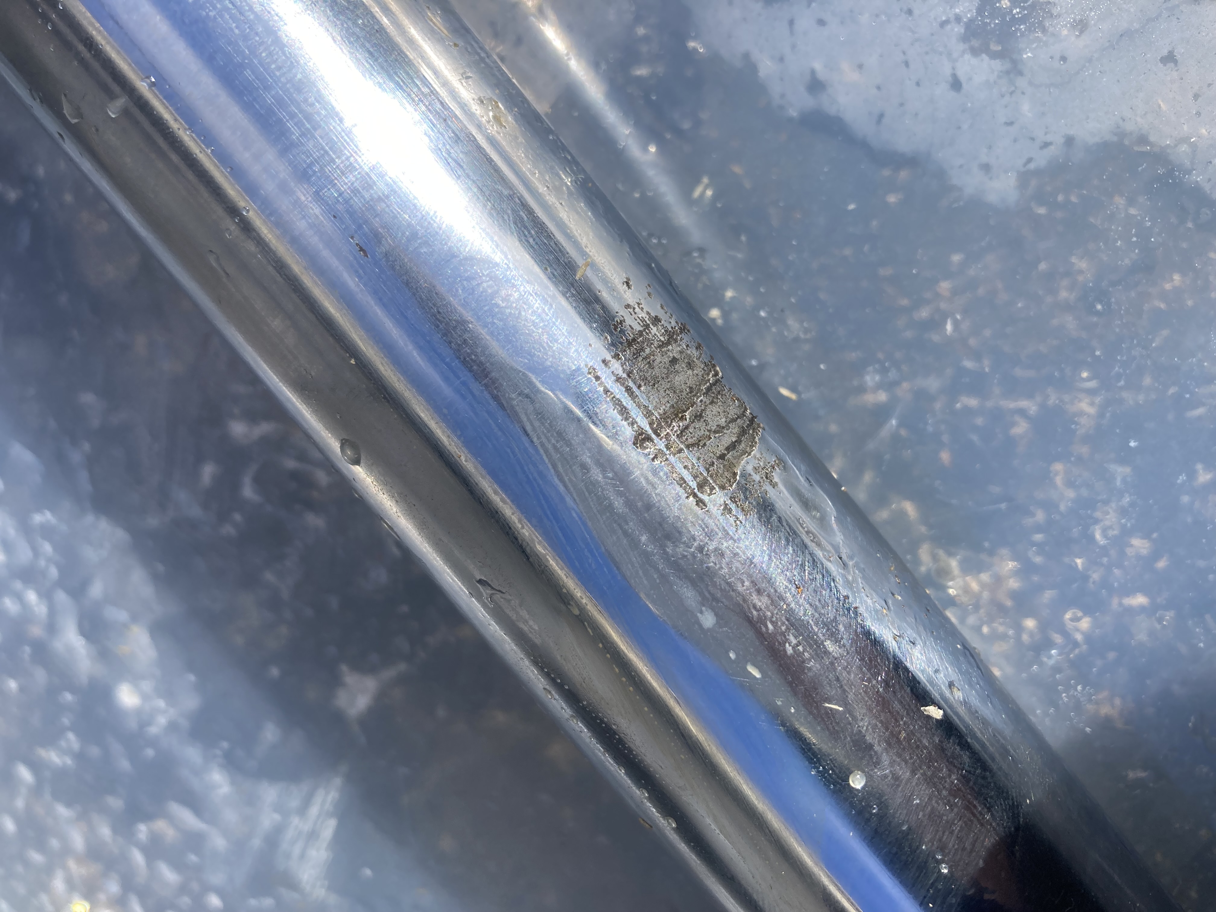

I’m in the same boat but for I am restoring five sets of forks. some of the stanchions are far beyond returning back to functioning quality. I am dubious about is it worth taking the risk and shipping them over at my cost only to be told that there of substandard quality for restoration. I have set that are perfect. I’m one stanchion in very very good quality. Even if I just got one re-chromed I would have two OEM sets and then unfortunately the rest would have to be aftermarket see the quality below.
Re: Fork Stanchions rechrome or new.
I can sympathise, luckily in my case only had 1 set to worry about, yours look in similar state to mine, if anything slightly better as mine were really pitted and rusty in places, tried on a brass buffer wheel then fine wet and dry but just wouldnt have looked right, and the chromers said the same so in my case had bo choice, very rare are NOS parts available so have little choice but pattern parts.
All i can say is Zpower pattern parts tend to be excellent quality, plus as forum member you get discount too.
Another option may be to ship one set and see how they turn out before deciding on the others, if needed quickly then think pattern the way to go.
