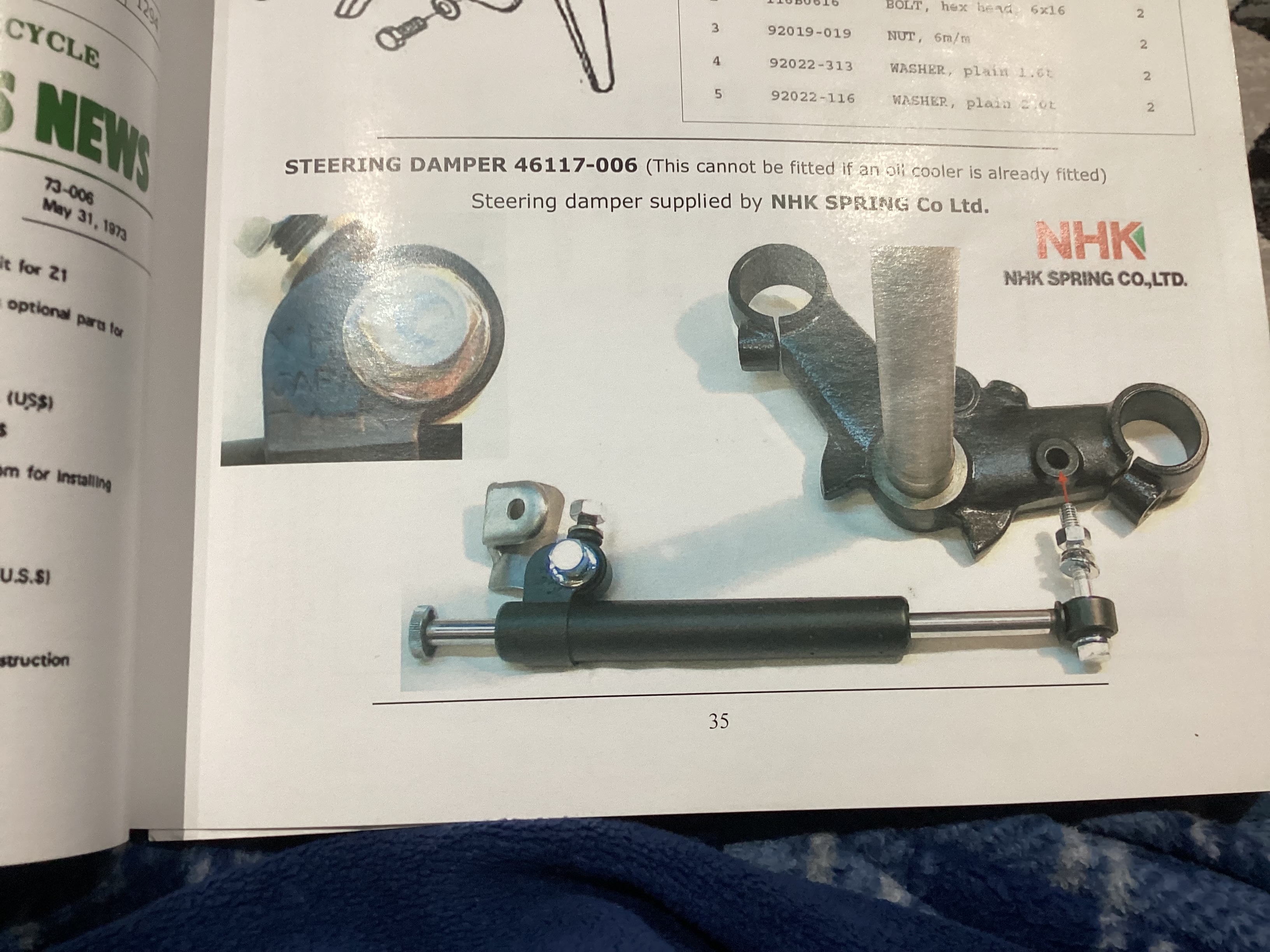

Hi anyone know where I can source new rubbers for 46117-006 steering damper as photo
[attachment=0]IMG_0711.jpeg[/attachment]

I didn't think there were any rubbers on the steering damper mounts :?:

Yes 2 eyes where it bolts to frame and a swivel has rubber bush and metal spacer in them

I take it the rubber dampers are in the steering damper itself then rather than the frame mounts ?

Yes at the end and on the side

I would either use rear shock absorber rubbers or cut a bit of thick walled suitable fuel pipe. Shock rubbers are available on ebay, fuel pipe is available, well, everywhere.
