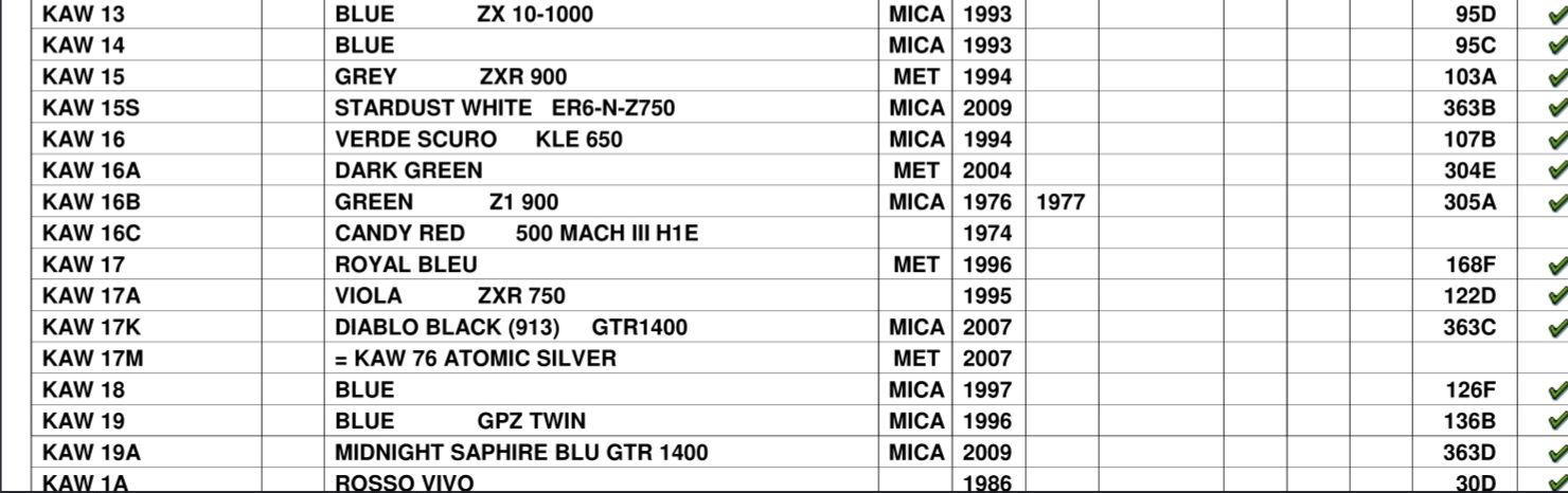

#3 PostAuthor: warren3200gt » Sun Jan 28, 2024 8:37 pm
If you can find a supplier of Lechler paints base coats are Coarse silver and green top coat is Lechler code kaw16b.
GB refinishers in Dartford Kent are suppliers Lechler paints in the uk and can supply posted to you.
