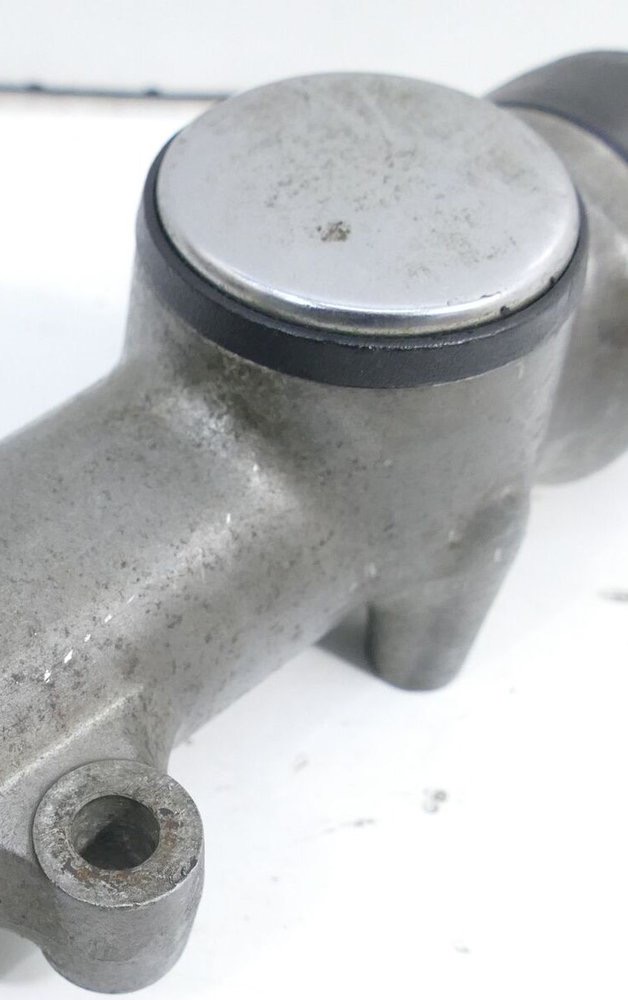

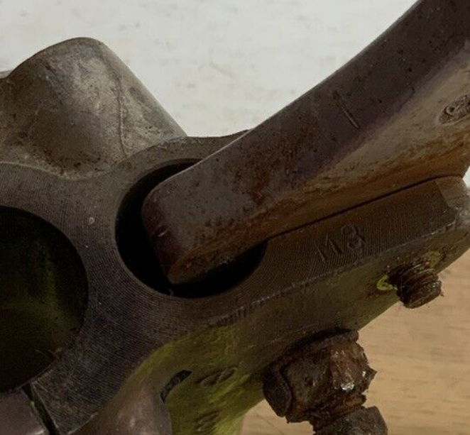

Iv searched high and low for all this on here and elsewhere otherwise i wouldn't ask such a re-hashed question but aside from exhaust, rotors, wheels, switches and rear brake stay and the printed codes on hubs, where are all the date codes. I have a caliper that has a date stamped into it "N2" and a front master that has "113" Aside from stamped parts i have Z1 forks that either have cast numbers on them or dont. MAybe we can start a definitive thread that outlines all stamps and cast numbers? thanks for the help in advance lads.

These are not date codes but the assembler's identifier stamp for quality purposes. When for example, your caliper was assembled, he would stamp his N2 mark as the assembler so if there was a problem they would know the guilty party.
If you were to find NOS parts for these individual items (say the caliper body which is where it is stamped), you wont see any stamp code

By the way, you mentioned about fork legs with a number cast into them. This will be the number 2 I assume you are referring too? These 'number 2' forks were only found on Z1B.
The number/letter stamp by the axle mount is same as my earlier post (assemblers stamp ID)
