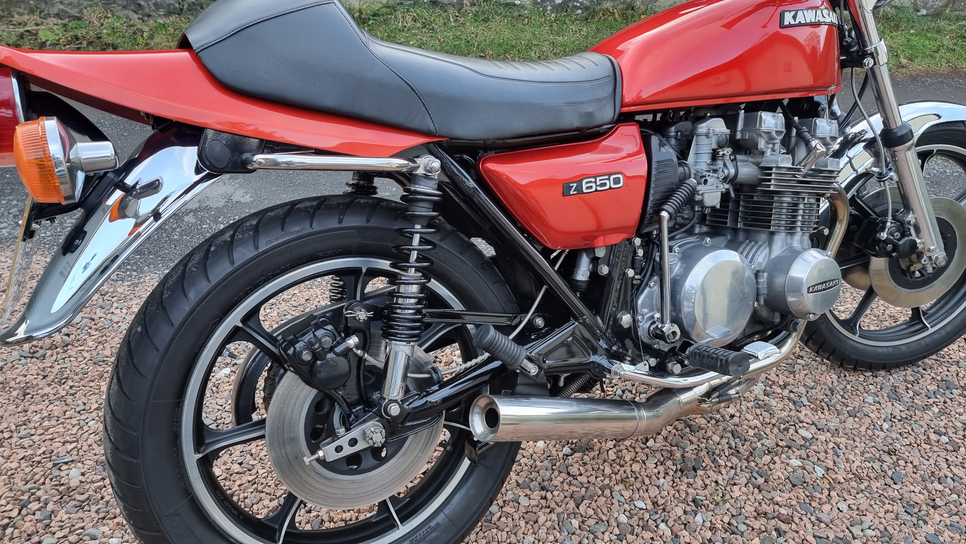

#11 PostAuthor: olnmfc » Sun Jan 28, 2024 6:41 pm
Refurbished Koni Dial a Rides now fitted successfully! :shock:
