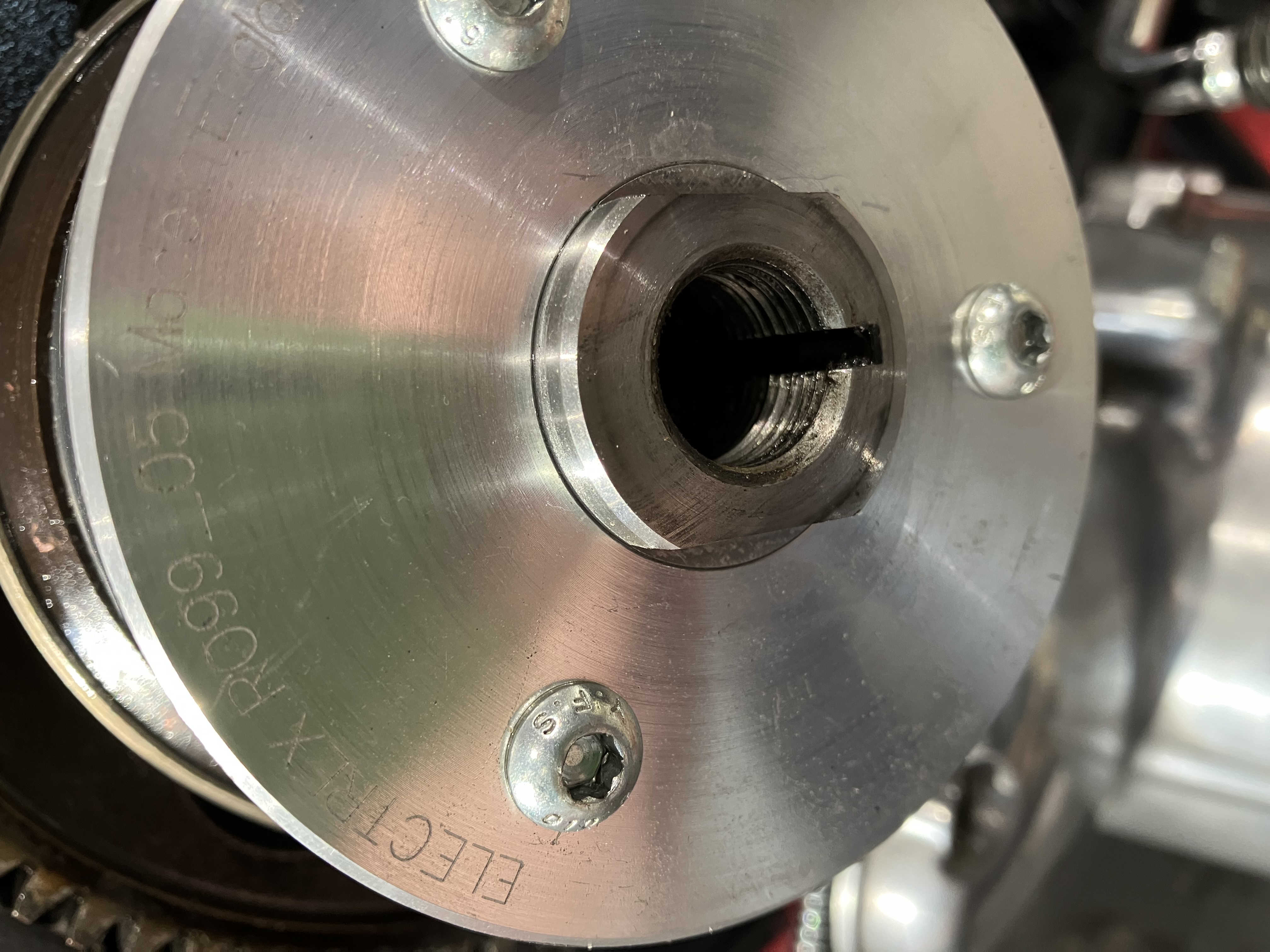

Pulled off the alternator cover to find a nice new Electrex R099 stator has been fitted !
Great I thought, managed to get the centre bolt out then went onto take out the 3 small hex bolts but couldn’t budge them and they started to burr over which was a pain.
Anyway, thought I’d just put the cover back on and give it a go and Bingo, engine now turning over? So have left it as is to see how it goes..
Thanks again guys for your help ..

SuffolkZ1r wrote:Just an update of progress today.
There's no need to remove those 3 bolts to replace the clutch rollers and springs though.
The old ones easily drop out of the housing when the hub gear is removed and new ones simply slot back in.

Ok. Thanks, so do you know how i get the hub gear/ rotor off?
If it gives me a problem again going forward will be nice to know it can be taken off..

Didn't realise you meant those bolts.
They are unique to the assembly of the Electrex rotor and must not be removed and would not gain you access to the clutch rollers if they were.
You just need slip the starter gear from the clutch housing on the back of the rotor to replace the springs and rollers once the whole assembly has been removed from the crank using an extractor bolt threaded into the center of the rotor..
Re: Starter motor spinning but not engaging?
just to spell out the obvious. The rotor needs to come off the crank before you can see the 3 shiny cylinders. They will be easy to remove once the rotor's off, remove them and the caps on the springs and the springs themselves. Once replaced with the kit items, it is a hassle getting the rotor back on the crank without them falling out ( dab of grease might help?) , that's when you need to do the little twisting action to the rotor, to settle the cylinders deeper into their recesses. Once the rotor's in your hand you'll see which direction to rotate, to settle the cylinders deeper into the starter clutch at reassembly time. Don't forget to line up the slots for the Woodruff key as you continue to feed the rotor onto the crank
