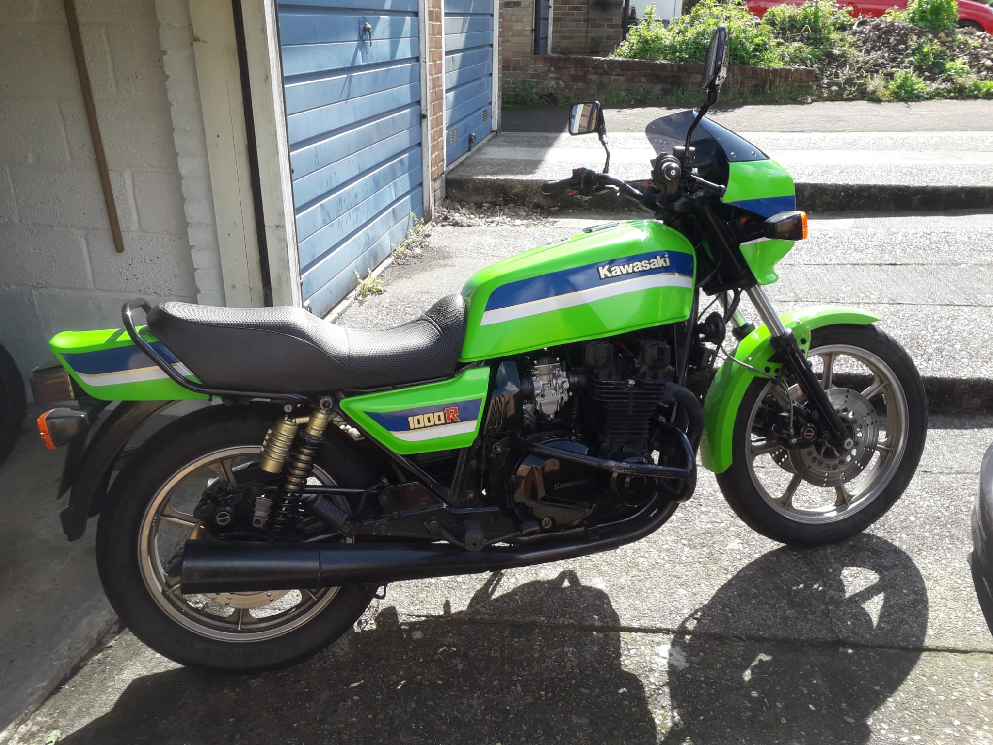

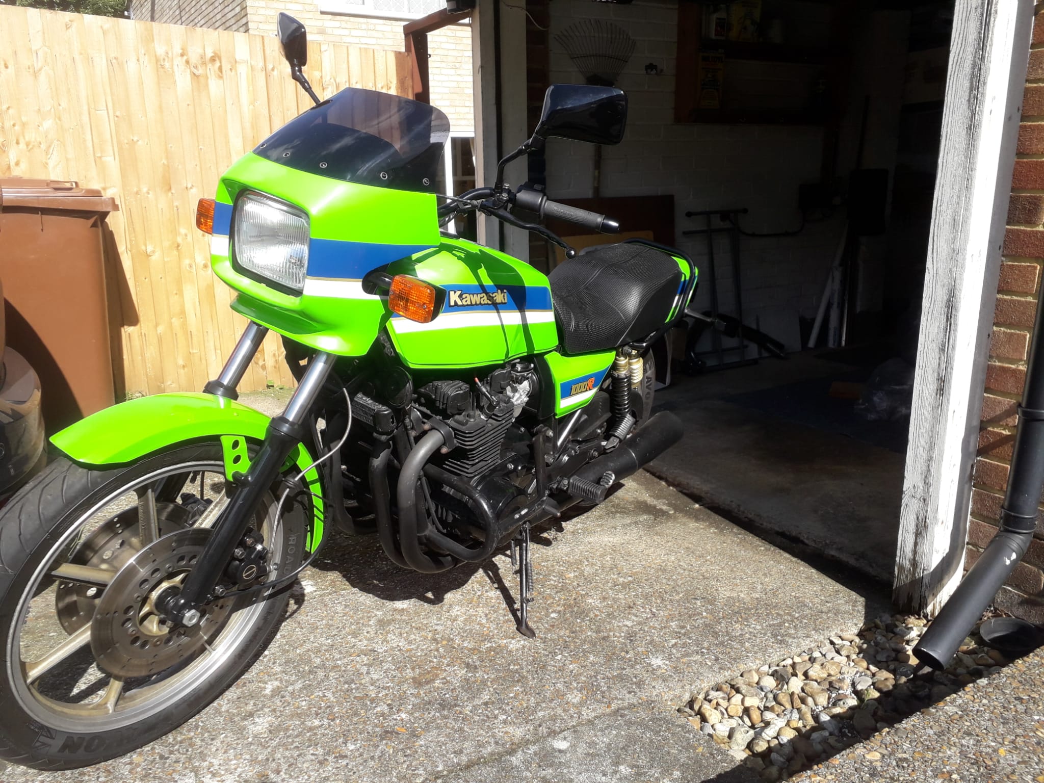

I just repainted an elr body set for a mate. The only bit that didn't need painting was the front mudguard.
GB refinishers (Dartford) are the wholesalers who supply RSBP and they are local to me so I get my paints from them at a fraction of the RS price. They supply lelcher (American manufacturers) paints and can cross reference with RS codes.
I still have paint half full tins and will check the label paint colour codes for you tomorrow.
Front mudguard is original paint rest I painted. Also re did the tank and panel badges.
Check colour match.

That looks great.
Thanks very much for checking. Stu

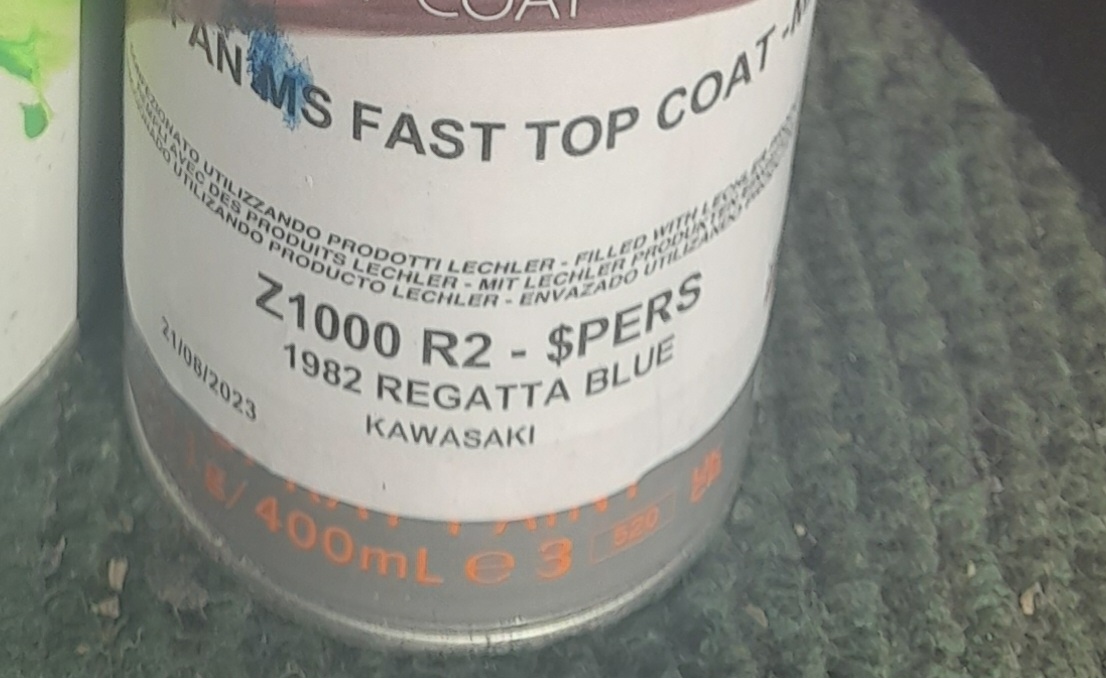

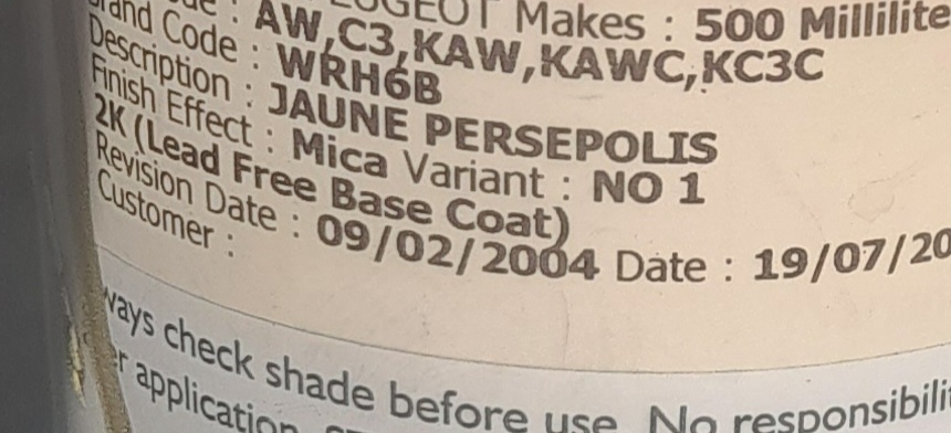

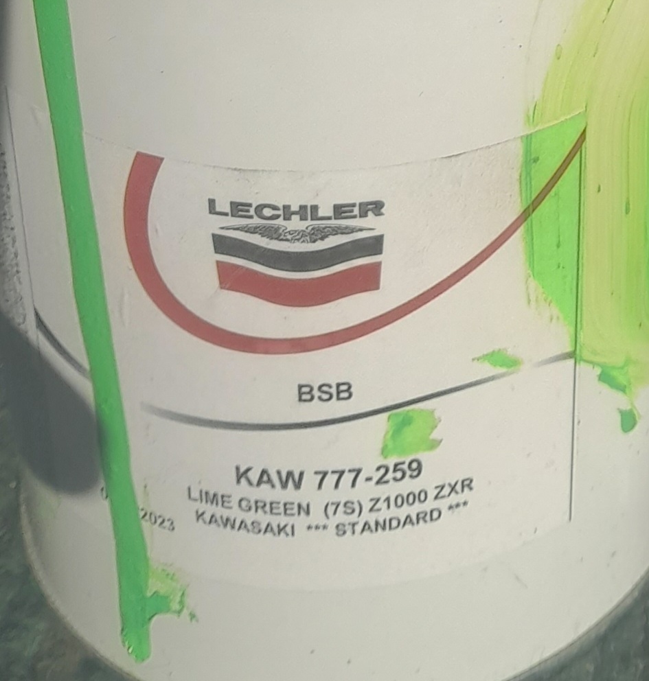

Green.
Gold
Blue
