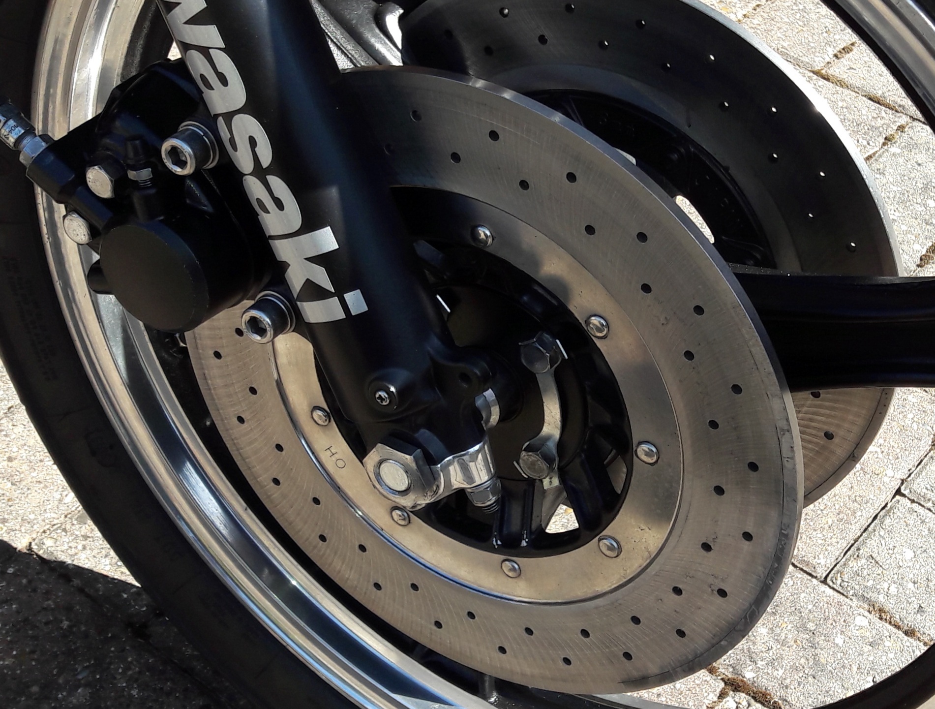

Posts: 3098
Re: Z1 disc grinding
#9 PostAuthor: warren3200gt » Sat Nov 04, 2023 6:32 am
After 3k miles.
