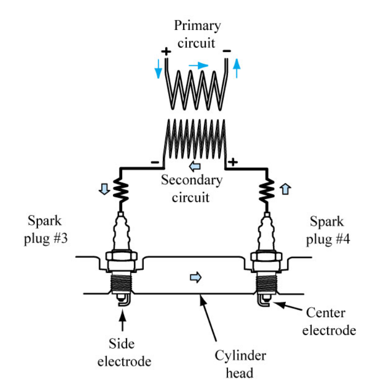

Have a look at the orientation of the; 'down' 'across' and 'up' arrows with respect to their plugs here.
If you have the arrow on the inductive pick-up poining toward the plugs; on one of them it will be the wrong way up!!
The HT or secondary circuit is a closed loop on twin tower coils which can be misleading when using a strobe.
Earlier this year i had an internal short (between primary and secondary) in a previously perfect Dyna coil and it had me scratching my head for a week of days.
It gave similarly incomprehensible results to those you are seeing.

That was one, if not my only conclusion when looking at mine. It turns out that the really cleaver part of the twin tower coils / wasted spark set-up is that its not entirely wasted! Meaning that the spark energy is focussed on the area or route of highest electrical reistance. In practice this means that on a cylinder not under compression, the spark just bleeds across to complete the circuit. The spark plug in the cylinder under compression has a greater resistance to the flow of energy and the available force is concentrated there.
If there is a difference between the static resistance of the two; HT leads / caps/ plugs combo's; the spark energy will be disproportionately directed to the point of higher resistance.
This can give the impression that one side of the coil has failed but i dont think that is possible as i mentioned above; the secondary or HT side is a merry-go-round / sealed loop. If one side fails the other must. That does not mean that both necessarily drop out but one is more likely to malfunction than the other. That failure may or may not swop from one to the other depending on where it finds the highest resistance, swopping the leads on the coil may not show it up!!
I wish i was more electrical savvy and i could avoid using terms like; merry-go-round
