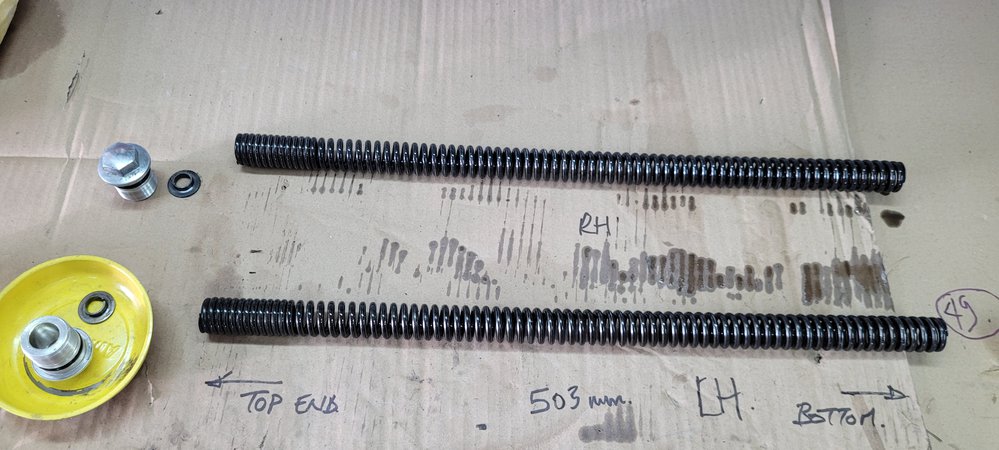

Hopefully a photo above of the contents of my forks.
A matching pair at 503 mm in length, with the spring at the top coiled tight.
No spacer at the top - just a small top hat to help centre the spring I assume.
Thanks - Paul.

Re: Front Forks too stiff
According to the KHI shop manual the lengths are correct and in spec for a Z1B
Standard = 505.5mm
Service limit = 495.5mm
Oil volume = 170cc per leg
Start by changing the oil for SAE 10w and see how it goes.
Don't just add 170cc per leg (thats just how much you need available), add oil until the level is 475mm from the top of the fork tube with the springs in and the forks fully extended (front wheel off the ground).
Standard = 505.5mm
If you haven't already got one purchase a Clymer manual.
Check that the damper has been assembled correctly on previous strip downs.
The washer that is shown in the photo that has been under the fork cap is not an Z1 OEM part.
It is on a 650 set up. It keeps the spring load square on the cap with the lip sitting in the spring inner dia.
