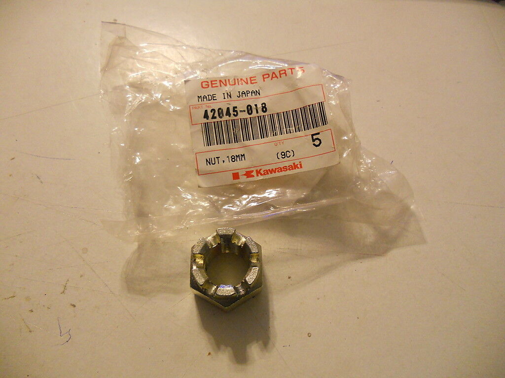

#8 PostAuthor: Z1streetfighter71 » Tue Sep 05, 2023 8:19 pm
Not that im a reliable source but the part is listed as 42045-018 but says nothing on the finish but i have 3.. 2 rusted zinc the other chromed.

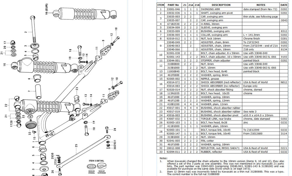

#9 PostAuthor: z2.john » Tue Sep 05, 2023 9:00 pm
That is the rear axle nut which correctly is Zinc. Swing arm nut is Chrome

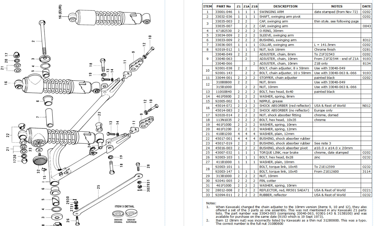

#11 PostAuthor: z2.john » Wed Sep 06, 2023 7:26 am
item 8 below

#12 PostAuthor: Z1streetfighter71 » Wed Sep 06, 2023 9:32 am
z2.john wrote:That is the rear axle nut which correctly is Zinc. Swing arm nut is Chrome
Take me to misread the brief :zzz but on a side note the page you posted above is it from a book or an online pdf i can source? thanks :D
