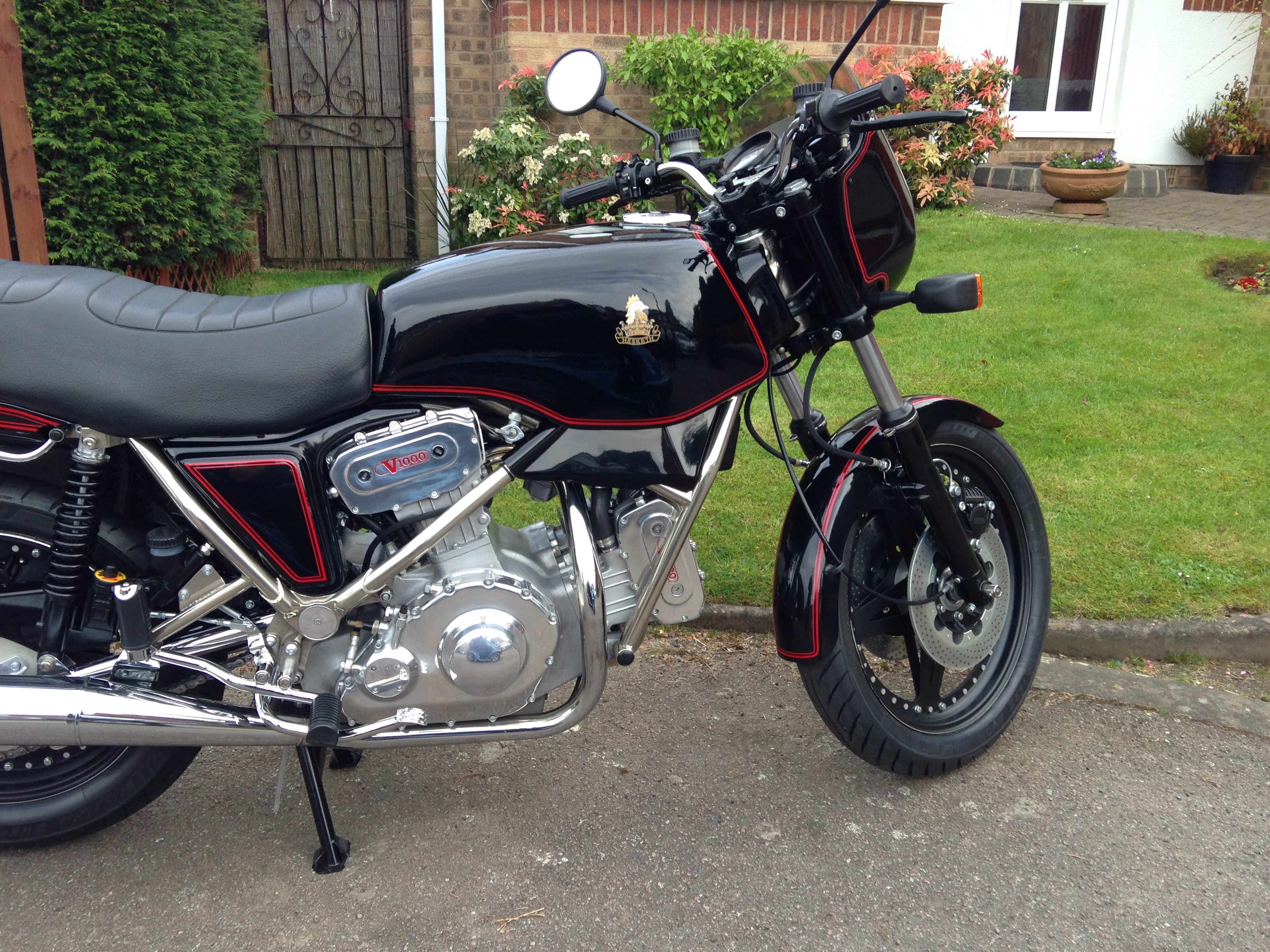

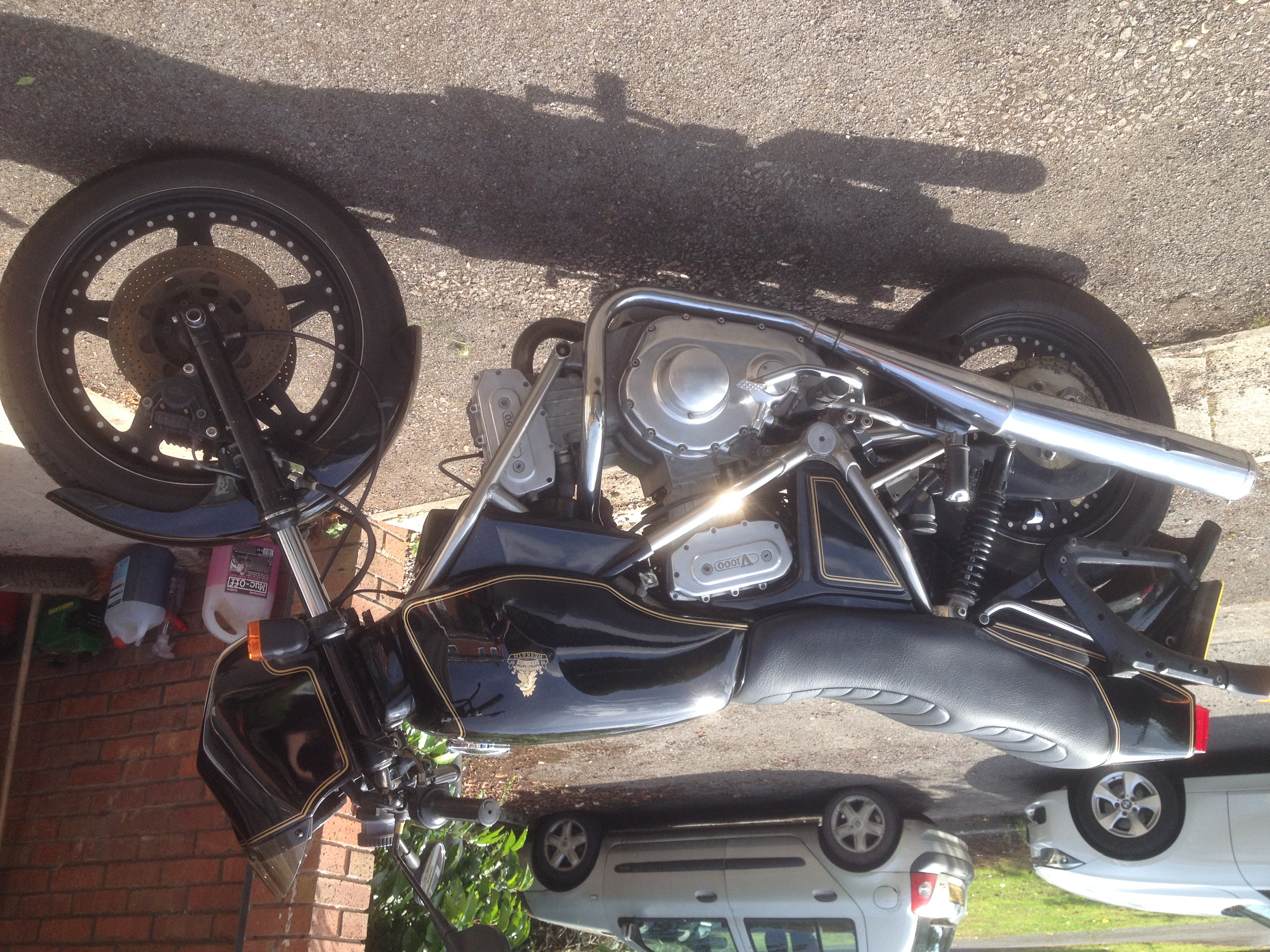

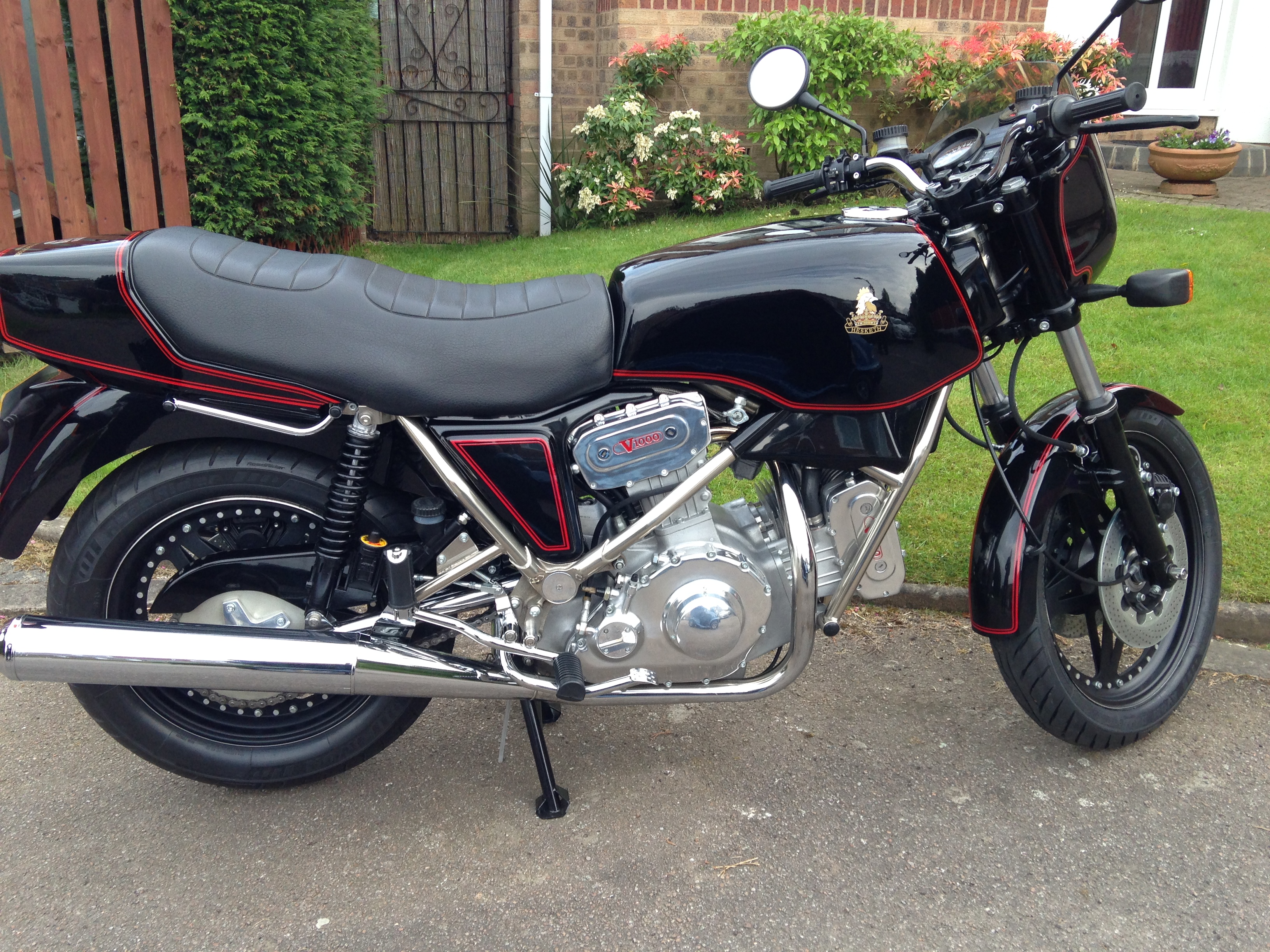

Hi Pete D,
I also used to ride a Hesketh.
I liked the bike but it was too tall and every time you sat on it while it was on the side stand it would try to throw you off the other side.
Nice looking bike but not very user friendly!
Pleased your Z is running well!
