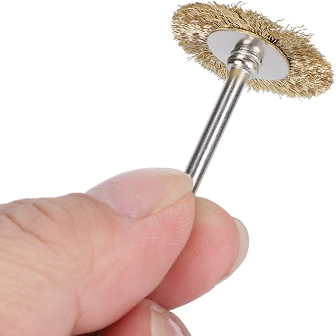

I'd use a Dremel with one of those small diameter brass rotary wheels. Will not remove material but will the corrosion. Far less abrasive.
Alan
Brass wheel..jpg (27.18 KiB) Viewed 1298 times

Cheers Alan just ordered a Dremel bit kit will give them a good clean out.

I also use Alan’s method using the brass wire brush, however, make sure it is a brass brush as some of the cheaper ones have brass plated steel bristles which when abused, could damage the alloy of the calliper.
