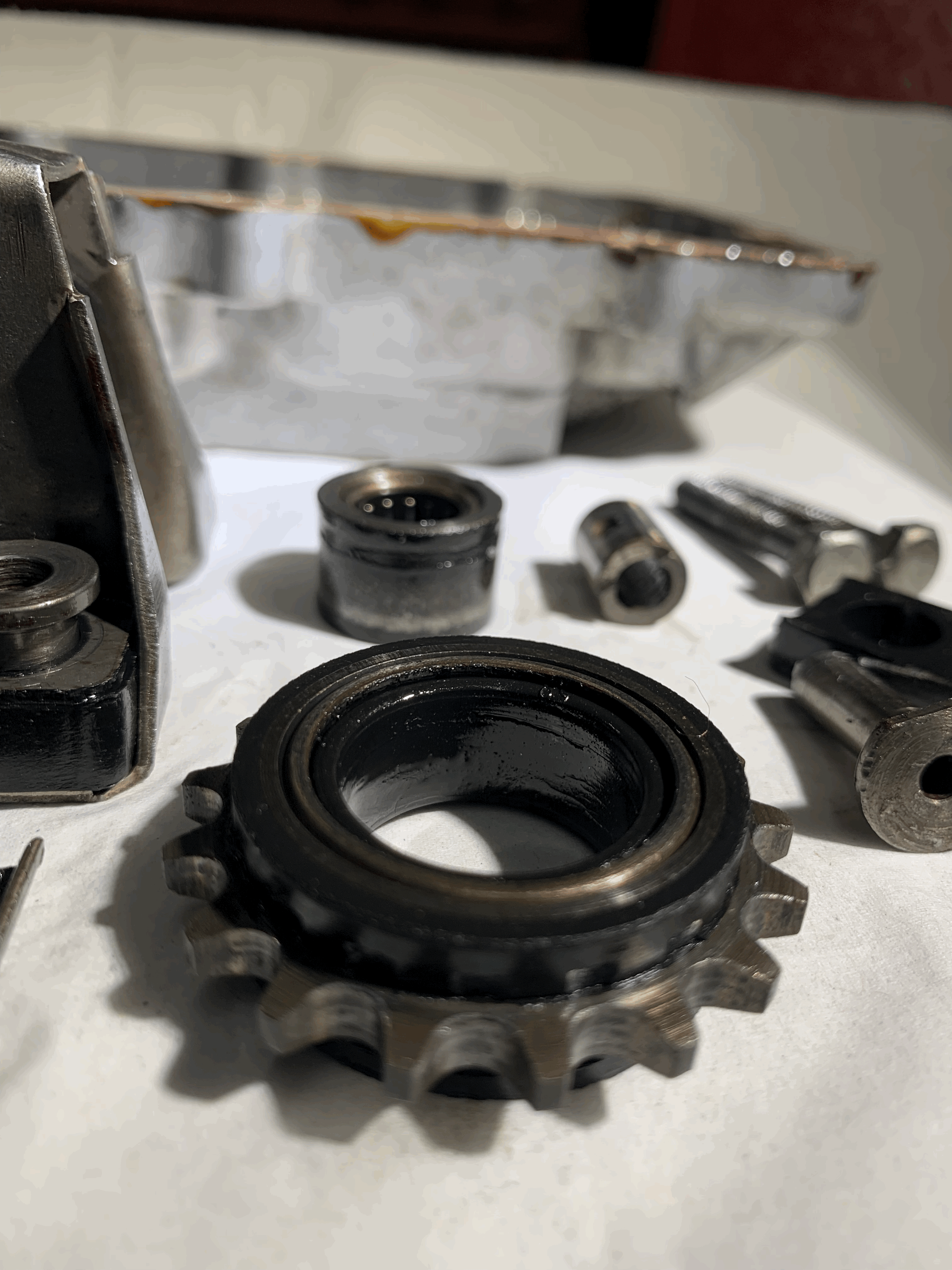

decided to get it on the bench and start having a look- looks like there is some wear on the top idler. No up and down or front to rear play. you can see that the central bearing bush is loose in the bearing - it moves along the central shaft independently of the outer part of the cam sprocket. And you can wobble the sprocket so it can point towards the Left indicator then the Right indicator.
How much play is acceptable?
And is this the likely culprit or should I delve deeper?

Slight side float of the whole idler sprocket is normal but wobble isn't.
if the outer sprocket ring and rubber center have unbonded it must be replaced.

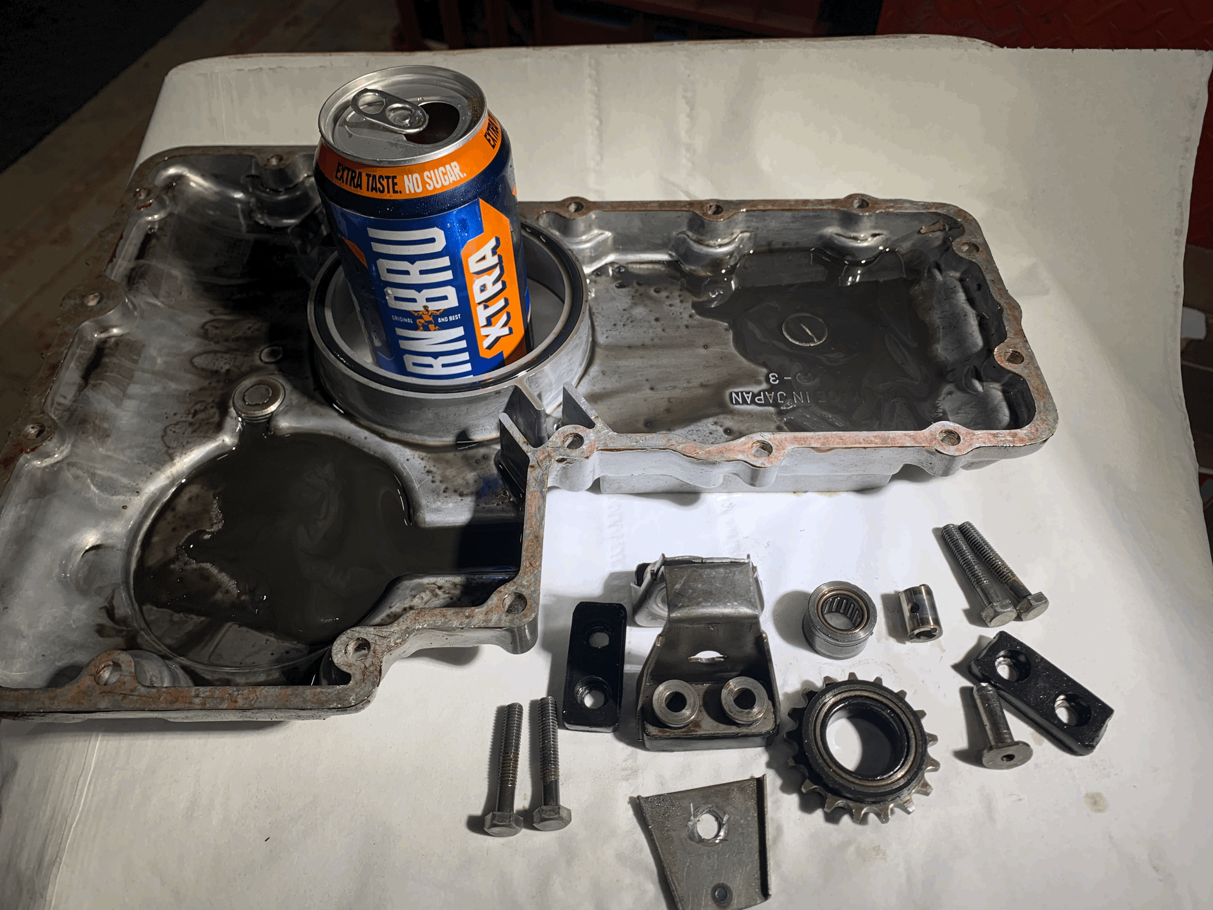

took the top roller out , ground off 1 end of the central pin and drifted it out. 1 of the side strengthening plated was loose, the spot welds had failed. The roller centre almost fell out of the sprocket centre.
However it doesn't really explain the greyish goo in the sump Looking up into the gearbox no obvious clues or signs of wear or grinding, nor inside the clutch cavity or the stator cavity when I took the covers off to look.

Like you i found thick mud like substance in sump several mm thick, mine was charcoally black rather then grey, im guessing like yours probably years of oil/water and in my case rubber mix as a couple of my rollers centres had collapsed and part of it in sump. Guessing it hasnt had regular oil chamges in its 48 years, probably sat in garage most of time. Luckily my tensioner and top roller are all perfect but will be checking all the spot welds thats for sure.
Hope you get yours sorted, i suppose the question is do you replace the danaged one and leave it at that, or strip full engine to check all just in case theres more issues, that a dilemma i didnt have as everything had to be removed for vapour blasting.
