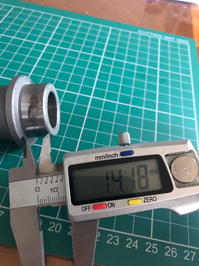

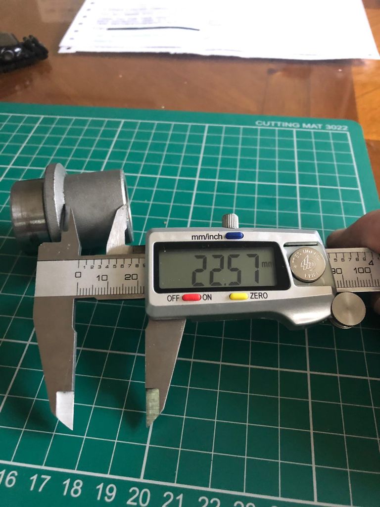

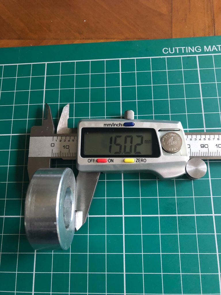

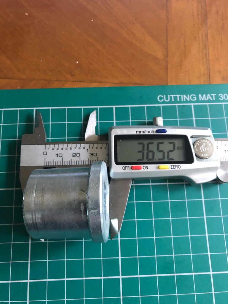

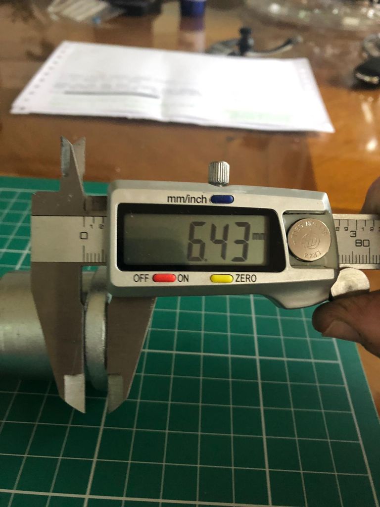

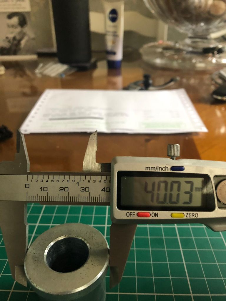

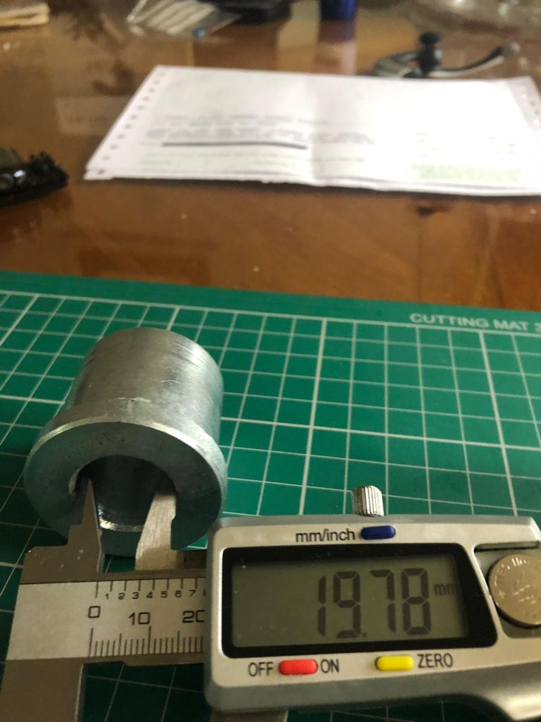

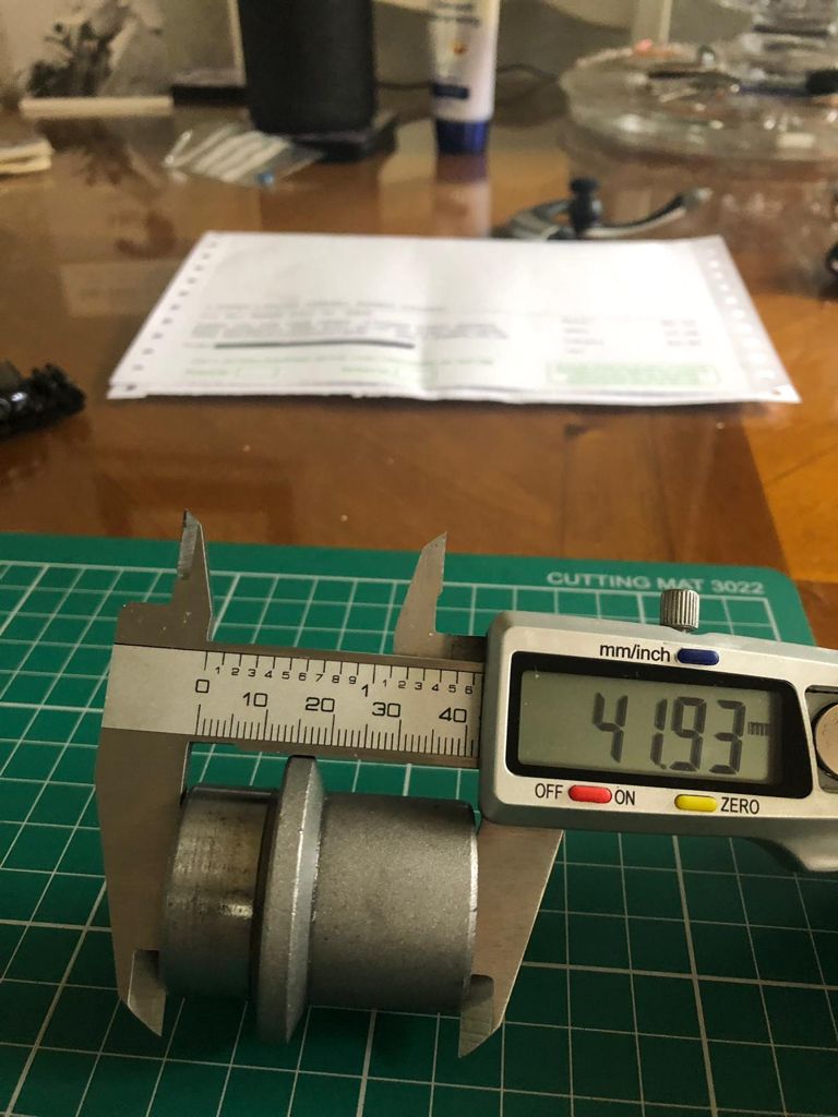

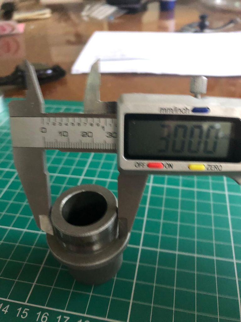

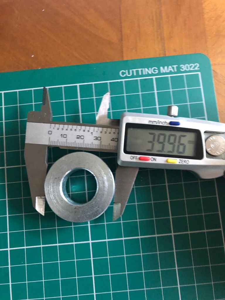

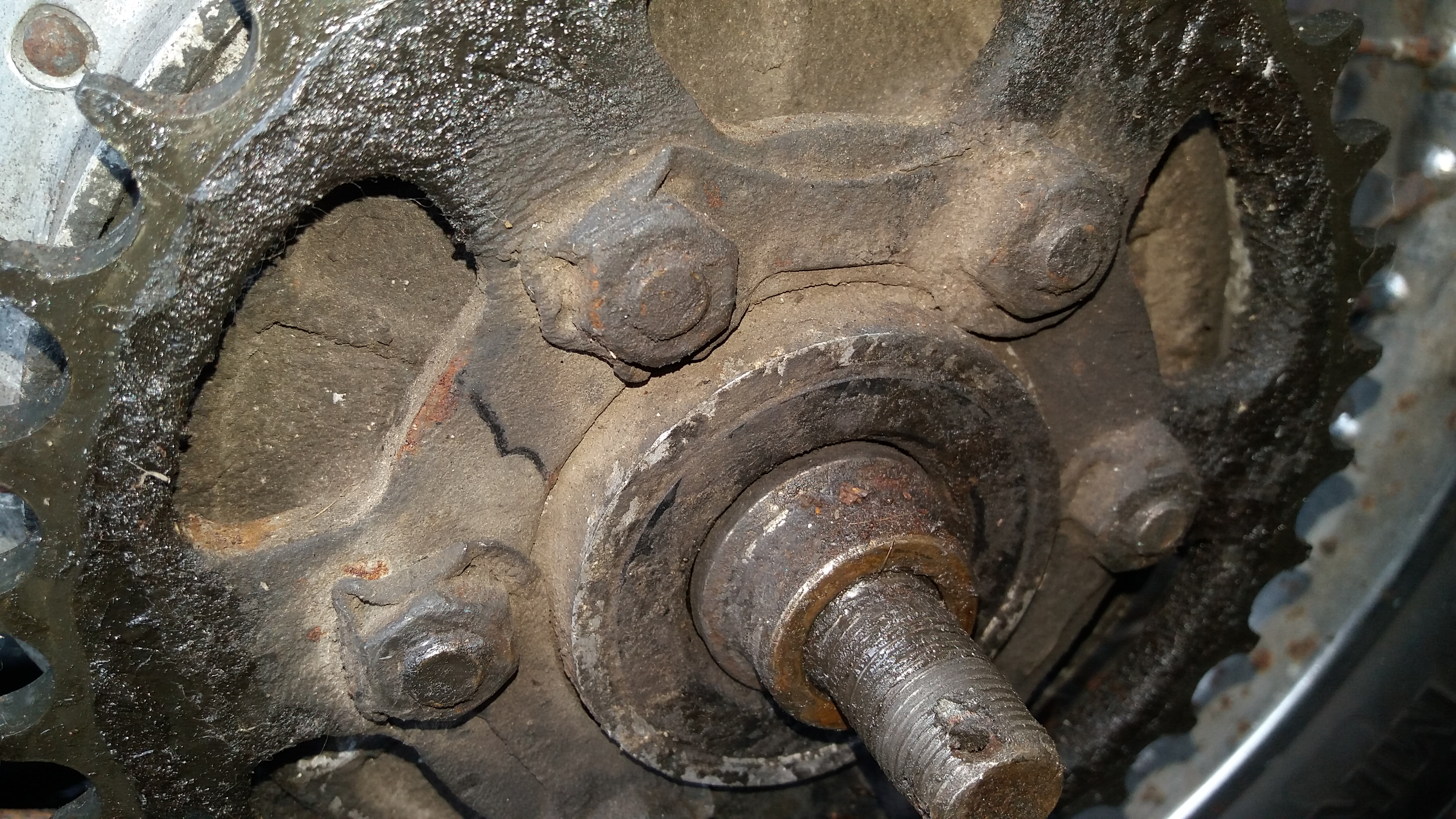

Hi all i have a 1978 Z1000-A2 on spoked wheels. I'm in process of putting it back together and have realised that for some reason the previous owner has put the inner spacer on the outside. So i need a new outer spacer. Does anyone know the dimensions so i can get made up locally? Obviously i can figure out the inner and out diameters easily but the length is the tricky bit. I can see the question has been asked before in the form but can't find the answer. Thanks

#2 PostAuthor: KeithZ1R » Sat Dec 17, 2022 2:46 pm

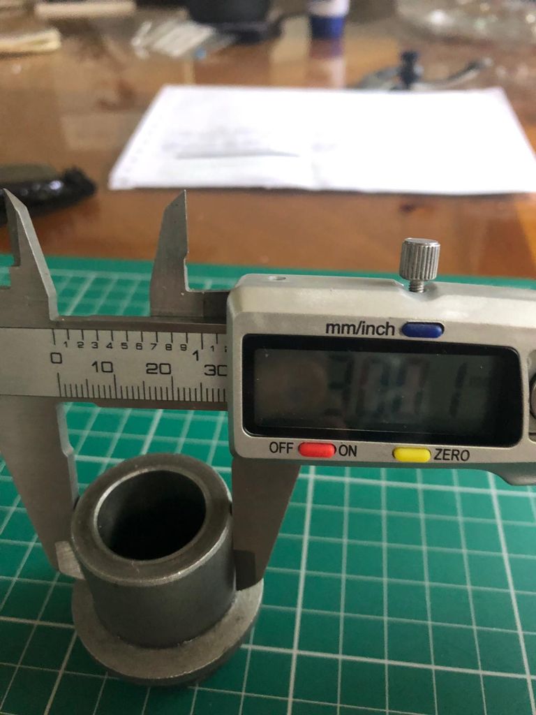

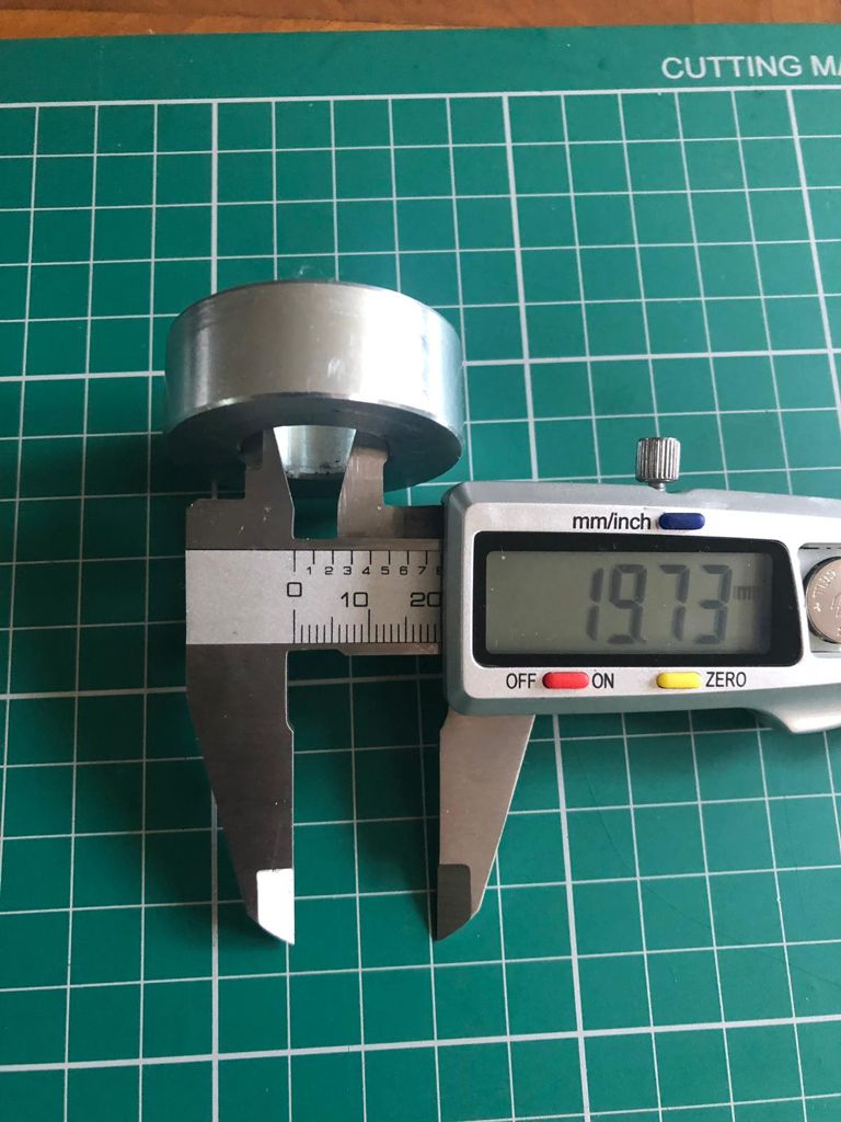

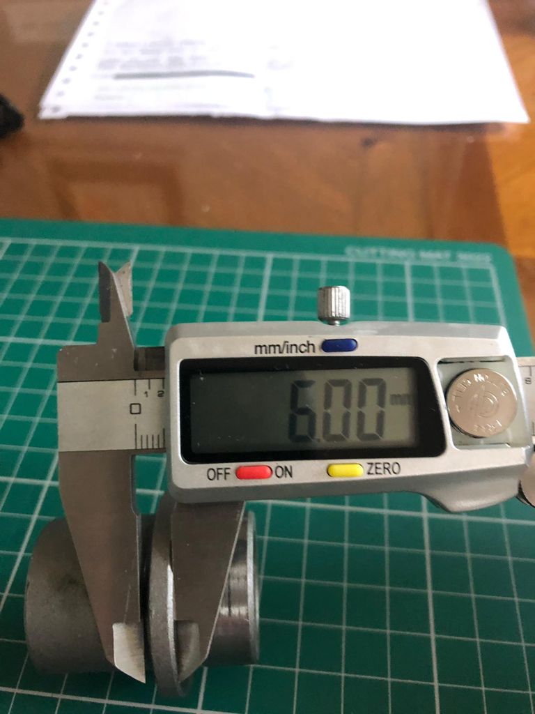

these may be of some help :)

holy moly KeithZ1R is there such a thing as too much information. :D
Thank you very much.
